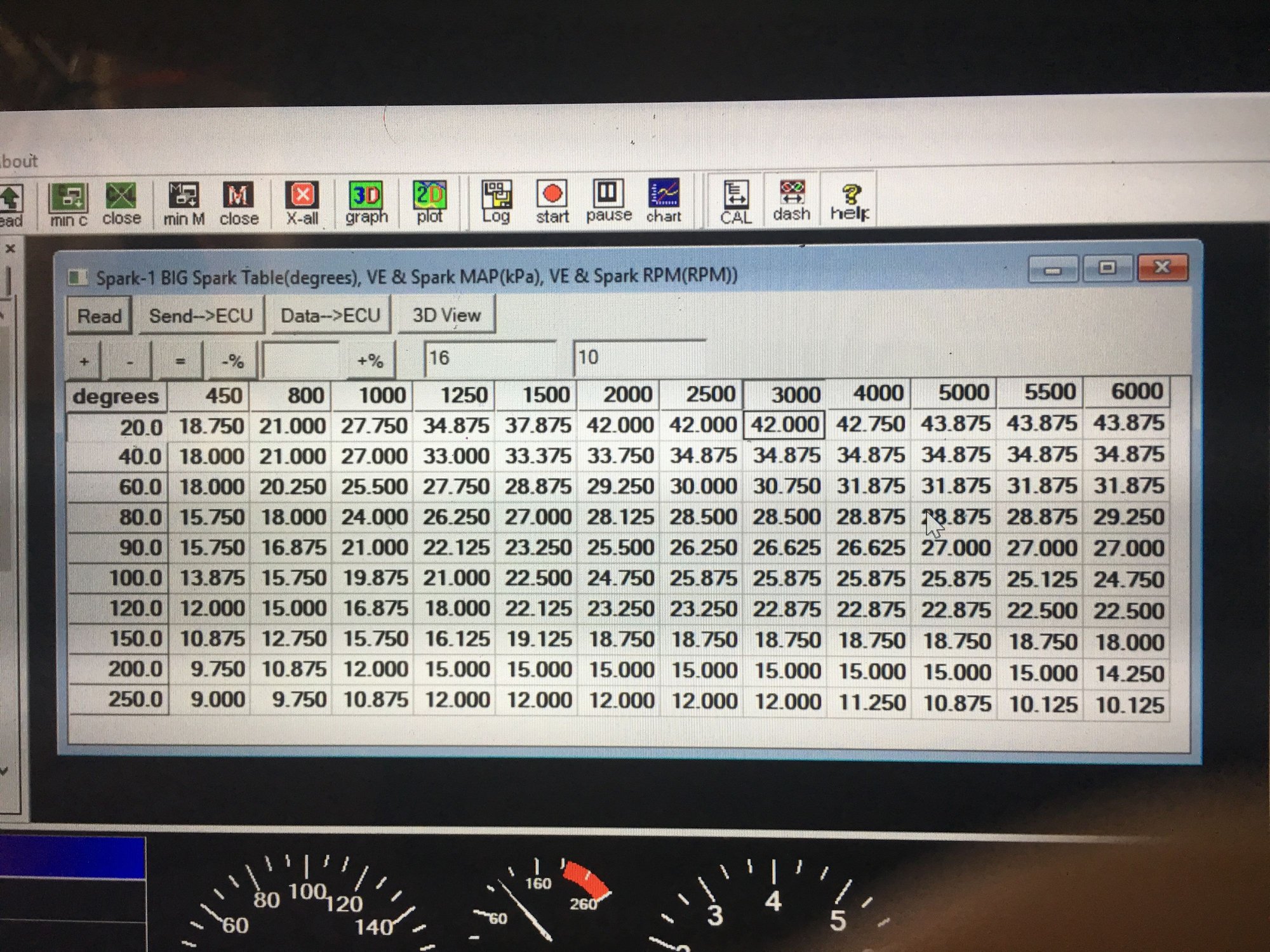

can you post a screenshot of your timing/boost map. Because in my 2 bar os there is definitely no timing control via boost. It’s only referenced to g/s which it only goes up to 1.20 grams per second. Once it gets past 1.20 g/s, which is around 8psi, I can no longer control timing for individual boost pressures of 9,10,11,12psi etc.
yea your right. Kpa to 210 is only for VE and not timing which maxes out at 1.20g/sec. honestly I have been loving my fitech 70050 which does do timing to 250kpa lol. Think it got it for $700 new and you can get them used now from guys switching over to the terminators and crap now. Fitech has been pretty good for me on the street spinning to 6500 at 15psi while giving the system no time to learn and changing the EBC on the fly.
fitech timing table attached just for ***** and giggles. I know the resolution is poo with the large jumps after 100kpa. These things are boost capable right out of the box but the main intent was NA engine swaps on the cheap.

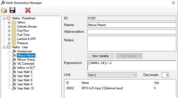

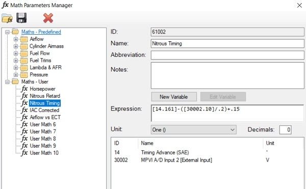

Installed my lingenfelter Lnc2000 last night. I’m using it for launch control and wanted to use it for boost timing control. I can’t log my timing because it changes it at the coils. Didnt realize that till last night. Ugh. So should I set it how I need it and trust it?
If you have HPTuners, and to use what you already have....
You can log both the LNC-2000's amount of Spark Retard, and the vehicle's Actual Timing.
You simply have to setup two new User Defined parameters in the software. If I can figure it out (obviously with help from the guy who posted the formula)...Damn near anyone should be able to, lol. I got the formula from "shenanigans", and have attached the screenshots of the formulas, and what needs to be logged in the Channels, for it to work. Only "wiring" needed, is connecting the GREY wire from LNC box, to your HPTuners "dongle", and of course however it is connected to the MAP sensor...If you have the MPVI2, I have no idea if it is the same....
LNC-2000 HPTuners Spark Retard formula
LNC-2000 HPTuners Actual Spark Timing formula
It worked GREAT with my old nitrous setup, and should work great with Boost, as well. It matched my LNC-2000's "commanded" spark retard exactly...

The MPVI2 works the same for external inputs. It’s just more of a hard wire affair. No screw terminals, and uses a different connector.
