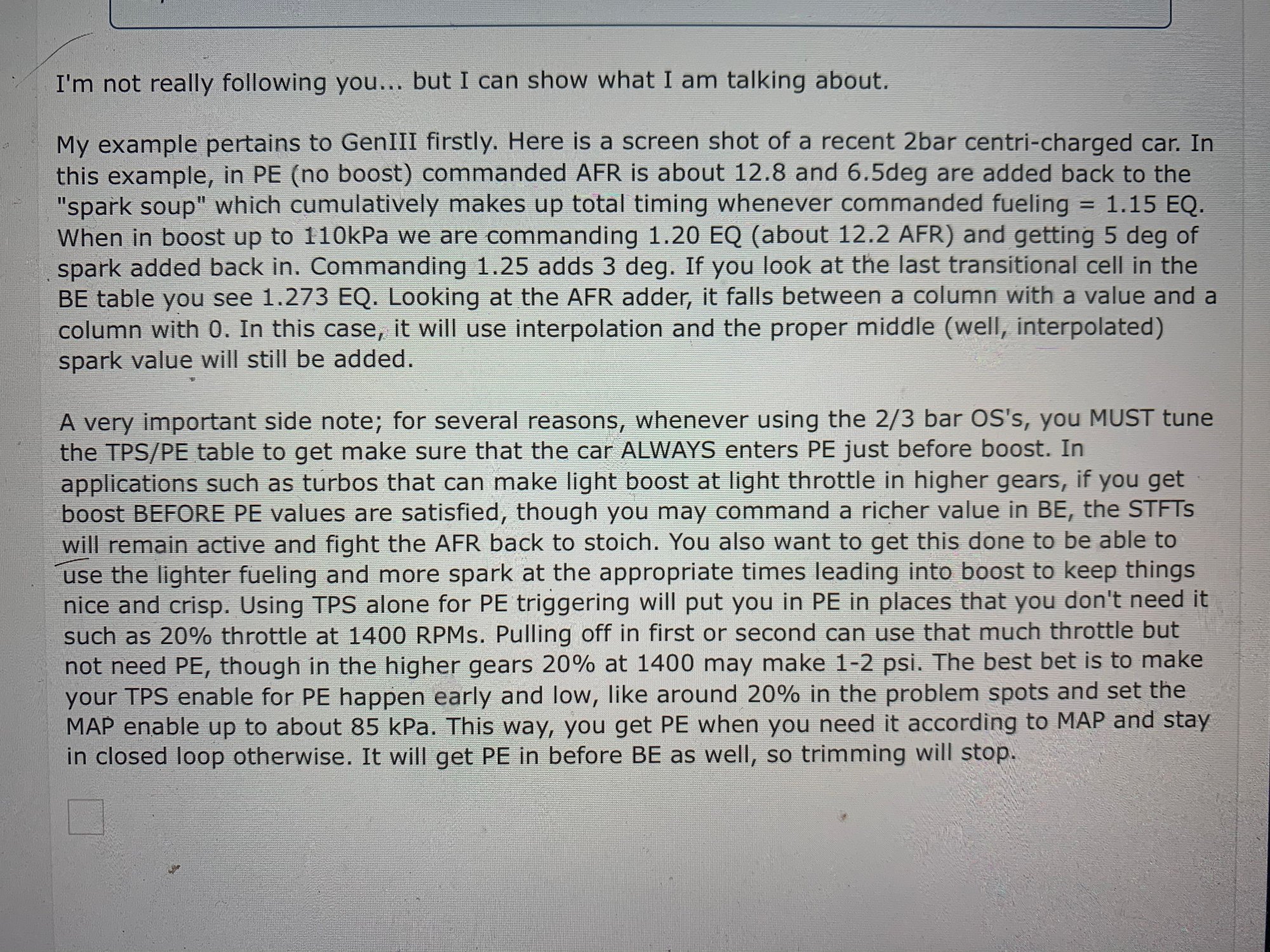

Here is yet a different work around

I have pe coming in at 80kpa. My afr is good. Just want to add timing from 9psi to 12psi range.
i tried scaling it today but it didn’t quite work right. I’ll have to revisit it. Car just drives do good right now, I really don’t feel like tuning it all over again right now. That’s why the 3 bar map isn’t on the car yet and I haven’t turned it up just yet.

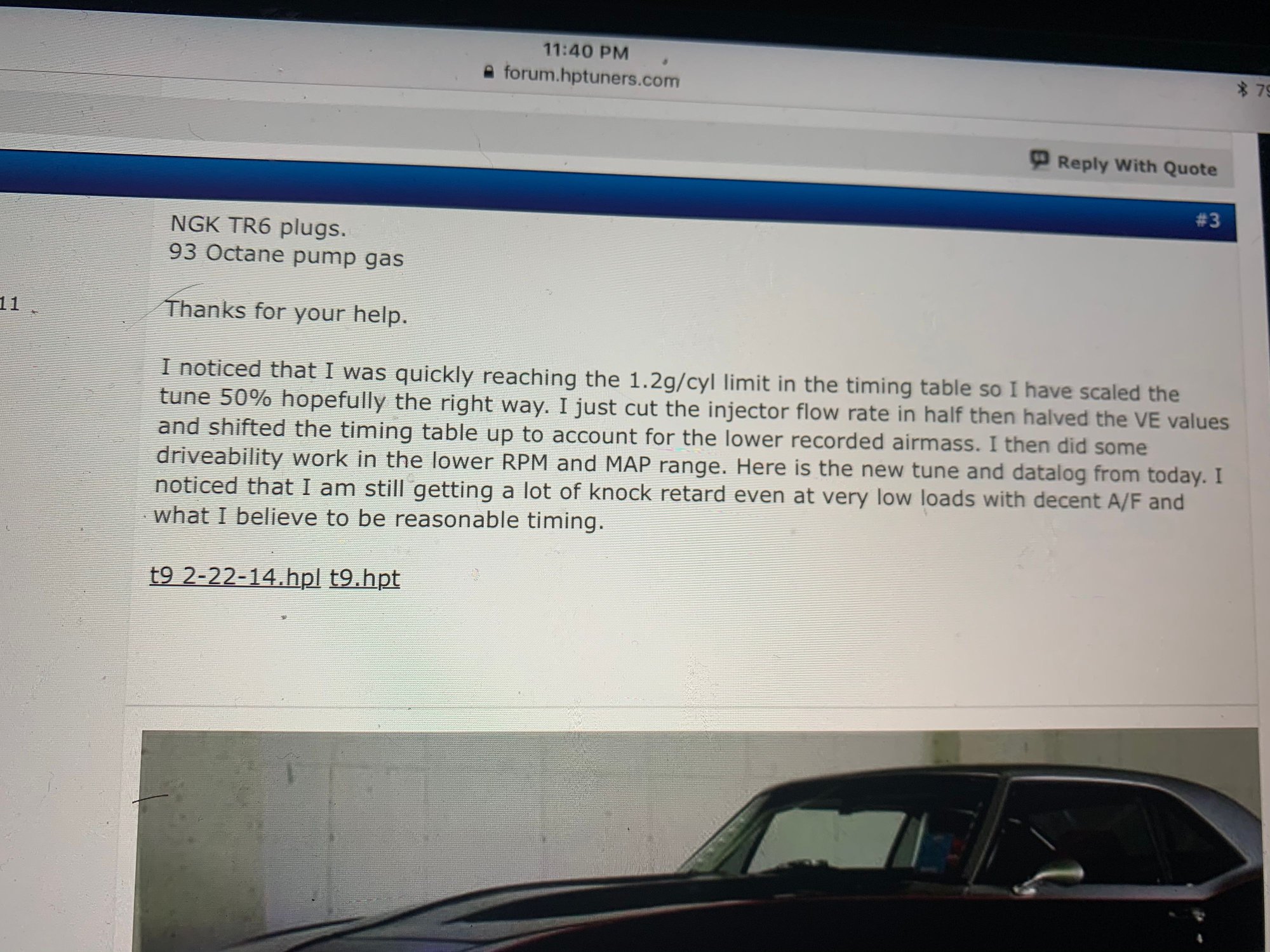

Try what you were told about in your thread from 2018 on hptuners forum...
What I believe they were saying in your thread is you could use to AFR advanced table as a work around. It adjusts the timing according to the commander afr. So you then could trick the pcm to pulling timing by requesting a slightly richer afr at a different boost level, and this table would then adjust your timing accordingly
i been digging through the software for the last two hours and can’t find this afr advance table. But in your thread you said you found it.
