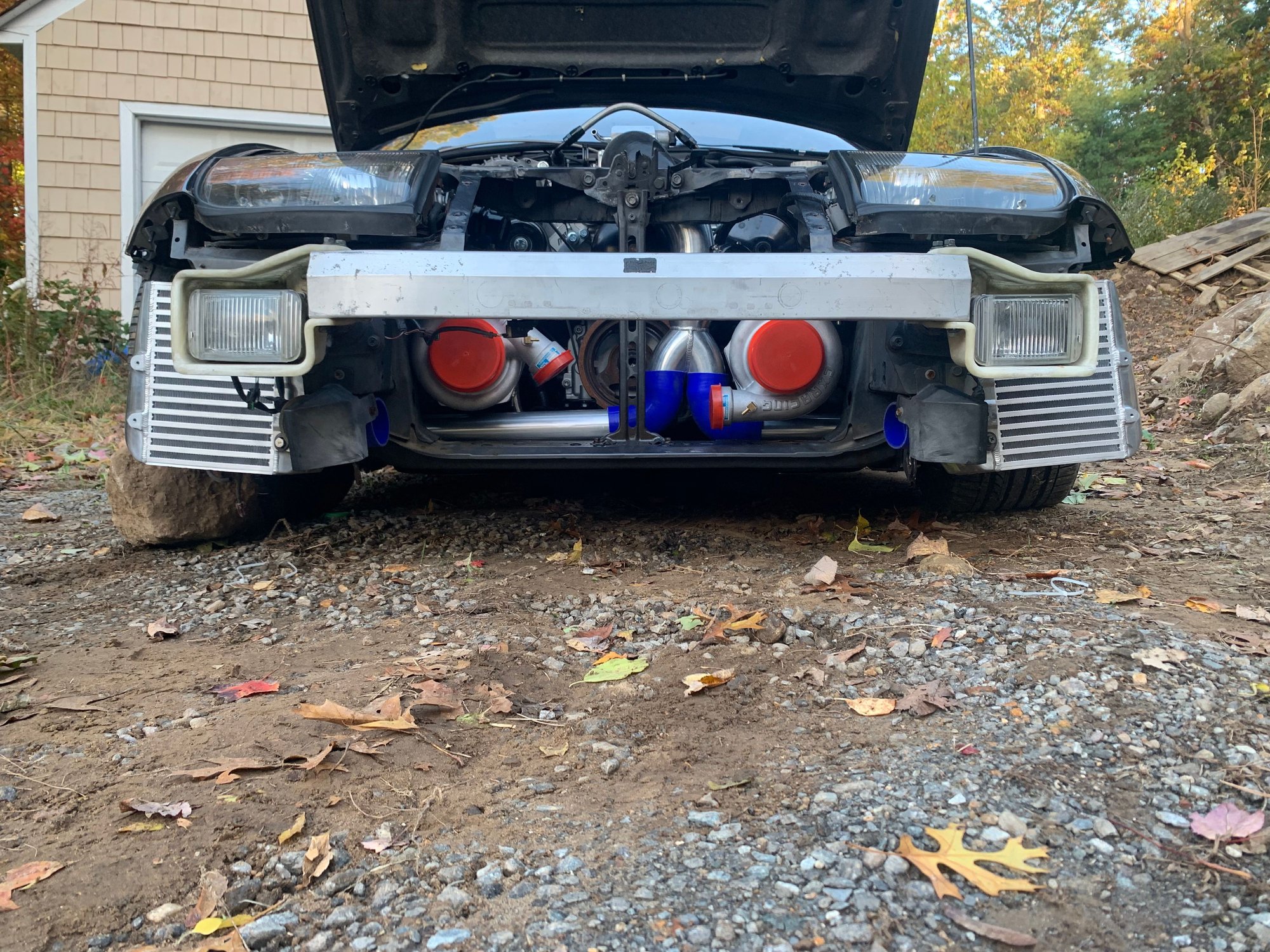

I have twin gt35s and i run 2 side mounts. No real data for IATs cause haven’t been driving hard due to no tune and no exhaust yet. However they work great of the car and are HUGE. Car comes factory TT designed for the SMICs too though.

these are the biggest aftermarket ones for the 300zx. There are 3 name brands that all use same core and 2.5” ends so I just got the cheapest of the 3. $450 for the pair. They are used on 700hp + nissans. However I don’t think posts ever come up about IATs for the v6 motors. Seems v8 guys pay way more attention to the details lol. The average 600hp setup used gt28s though. Gt3071s are the biggest can fit on the motors.

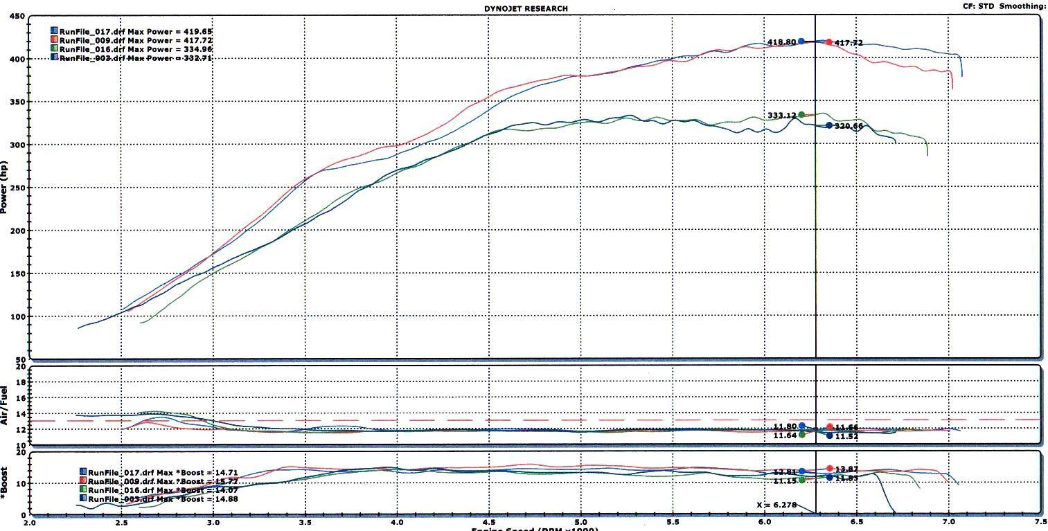

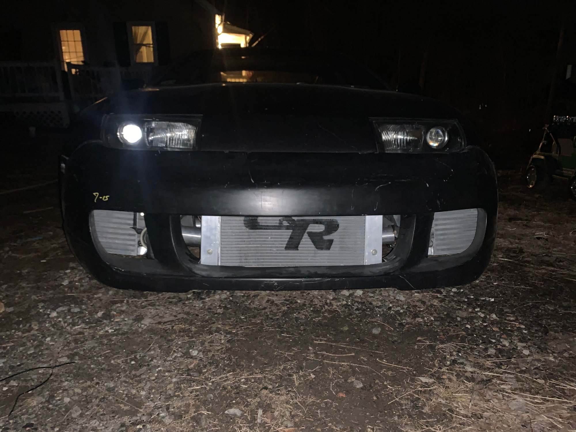

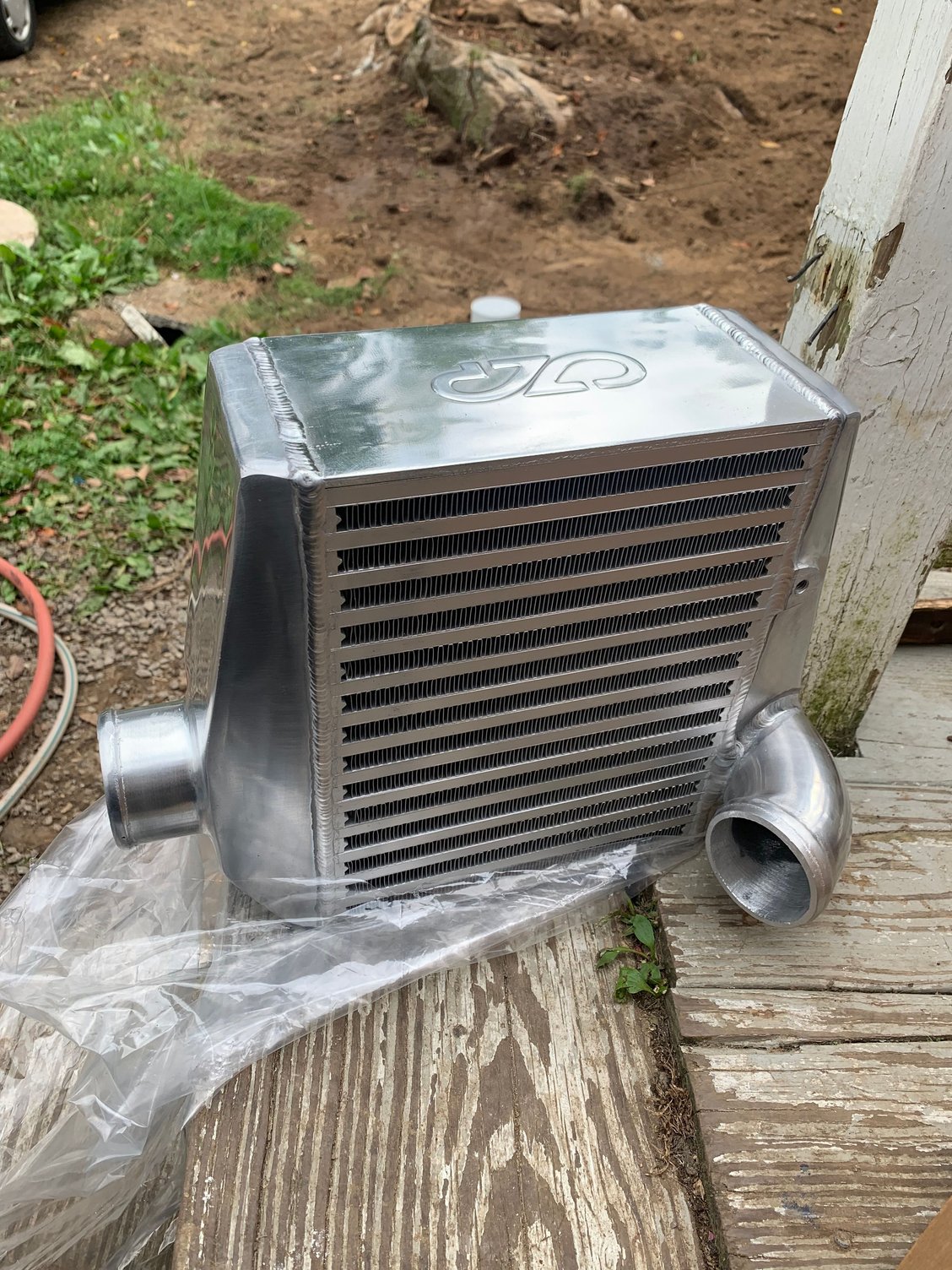

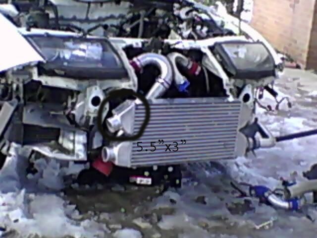

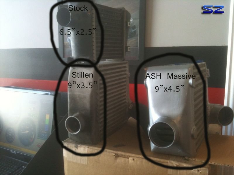

so that intercooler you have with dual outlets and inlets, while better than none looks identical to the ones we run on Nissans from eBay over the SMICs stock size. However the best tuner from our z community wrote back and forth with me in emails awhile ago and made it clear the stock intercooler actually was more effective than those eBay ones.
“””The whole system has to work together to move air efficiently, your correct that your front mount is a significant restriction, it actually flows less than stock intercoolers due to the long core and small charge face. Between the intercooler and 2 inch intercooler pipes, you have about a 4 PSI pressure drop from turbo outlet to throttle body.””””
so the 2” intercooler piping is because stock turbos outlets are 2”. Here are some pics he sent me of he side mounts being more efficient.
My side mounts are alittle bigger than those ashpec ones in pic.

Also this as pertains to turbos breathing
”””On stock turbos, with full 2.5" turbo back exhaust, larger intercoolers, single pop, we use to get about 330 Rear wheel HP at 14 to 15 PSI on 91 octane pump fuel.....
Now with stock turbos, 3 inch exhaust, 2.5" intercooler pipes, 2.5" massive intercoolers, dual pops and MSP manifolds at the same 14 to 15 PSI boost, we get about 415 Rear wheel HP on 91 octane pump fuel. And over 500 at the tires on E85”””
