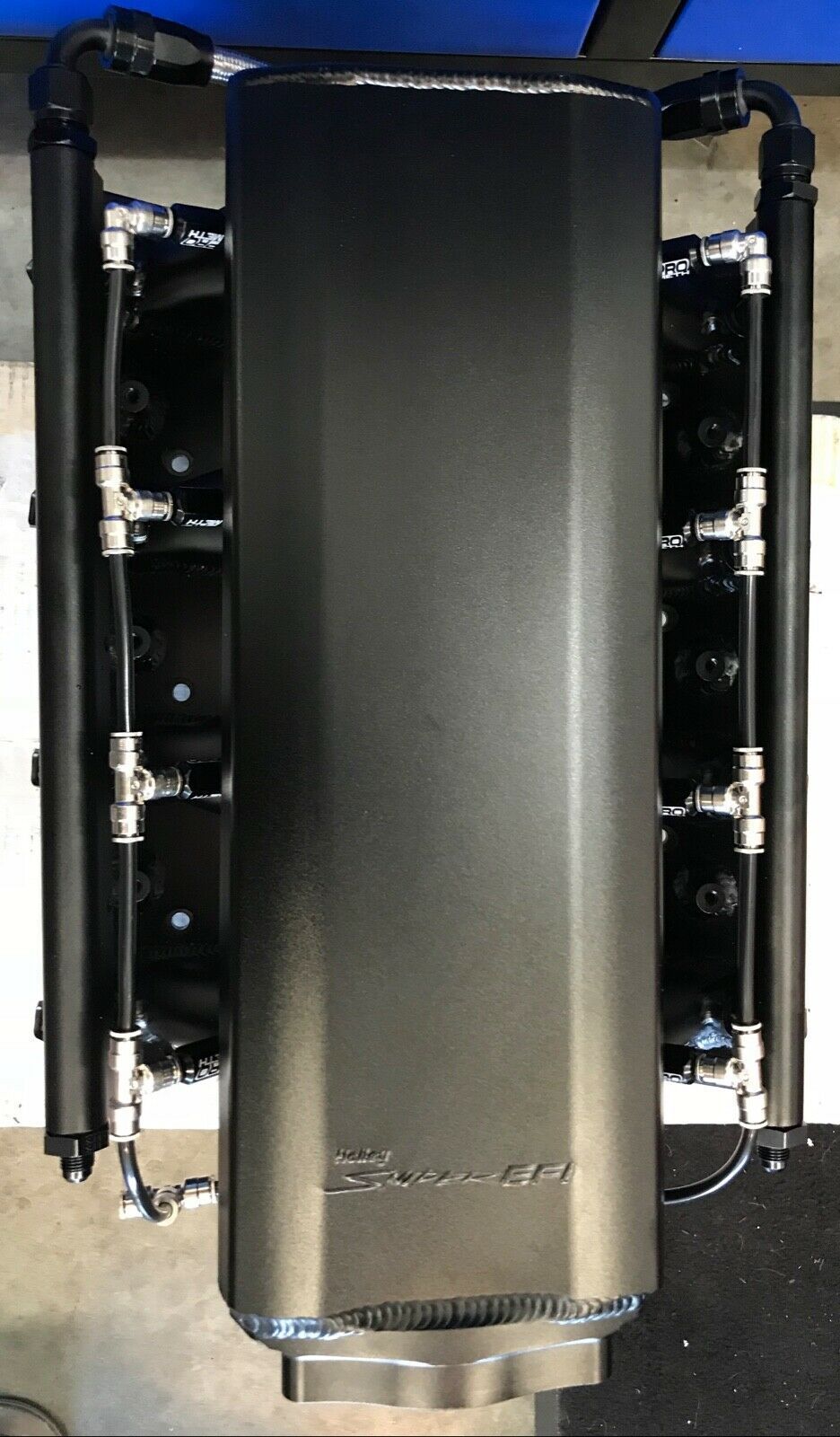

I ran a direct port meth kit before I felt like doing my fuel system for E85. I ran straight M1 and it wasn't all that expensive of a setup, just a kit from ProMeth. Worked well and helped crux along my pump gas fuel system for awhile.

It does work well with 20 psi on twins on straight pump I was the same barely 11-12* on an 11:1 engine, after the 100% meth direct port install I could easily run 16-17* on the same boost. I had no need to lower IAT's so was using it as fuel only. I was running it on a progressive controller, you can give the pump a boost a pump feed as they work fine in 16v cars and generally run them at 250psi.
I've run typical dual nozzle setups before and the direct port just seemed better, more evenly distributed and smoother if you will. That said I ran a triple nozzle way back with nothing but windshield washer fluid like you said with no intercooler and it worked pretty damn well for what it was before the nicer systems came out.

Is it better than what you currently have ? Of course it is. Although at only 20psi, unless it's poor fuel or not built with your chosen fuel in mind, methanol isnt needed.
Although IMO it seems difficult to make a nice and neat port injection system

But at least with a port system, you are helping to ensure a more equal flow to each cylinder.
