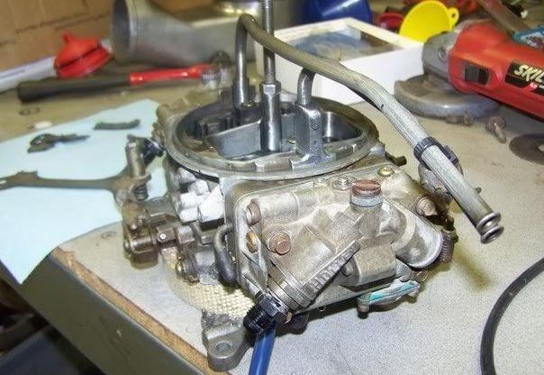

Shouldn't make any difference as long as your pressure is rising 1:1. If you can't adjust your air bleeds easily, add more enrichment on the PV circuit.
Do you have extended vent tubes pointing into the charge stream like so?
I do not. I will have to check the 1to 1.

extensions as pictured alone richened up my carb'd setup quite a bit. It's quick and easy. Might give it a try.
