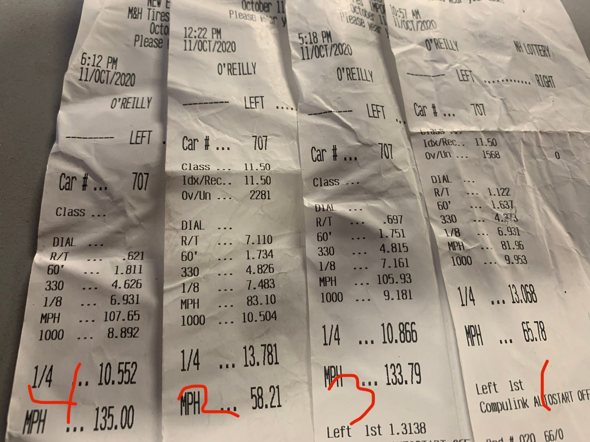

I would have to look into more anti squat stuff. So my buddy keeps telling me I want squat and soft back end. However other guy telling me you want stifff and all the weight into the tire to push tire to ground. I’m going again next Friday for a regular day and no event. Turn boost down and try see how I can do with consistent 11.5-11.60s to have some fun without braking and slowing down etc.
as for 3rd gear shift, pretty sure when I go into third the converter hangs at 5200ish and it sits on converter whole time to finish quarter. You can hear in the draggy that the rpm stays steady all of 3rd gear.
I did my 1.6 with foot brake. The trans brake was not able to get traction even with leaving at 1psi.
here my time slips. Keep in mind the 1st 2 passes I let off before the 1/8 mile. Last 2 passes I stayed in. 3rd pass has the trans brake at 1psi and last pass was no trans brake.

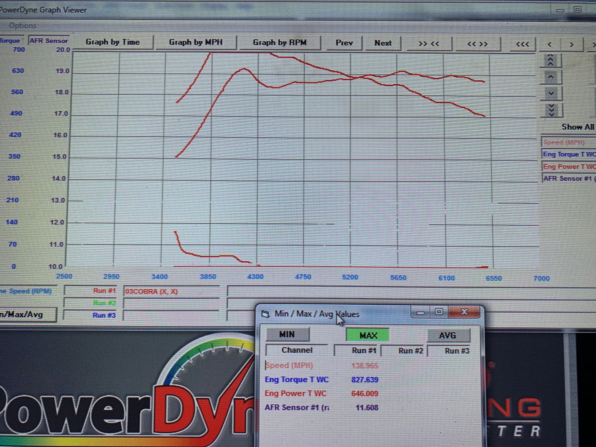

Came homes tonight from dyno with car. I didn’t go for Hp numbers. I went to do some DIAG now that it’s auto. Anyways let me give some details of what we tested. First and most importantly, my car was only on 14psi which was around 500hp and super rich. Apparently my boost controller reset cause the disconnect switch I wired into car for track safety 🤦. I didn’t even get to see what car could do at the 700hp level at the 18psi.
the guy at the dyno thinks I have a 59-6100 stall because on the trans break the car jumps to 5900-6100rpm right away. The stall SHOULD be 38-4000rpm. No idea if this is an indication that the stall is that high or not. Start boost 4000 - full boost 5200
Shift 6800 from 2nd- lands at 6200 in 3rd WOT
Shift 6500 from 2nd - lands at 58xx in 3rd WOT
Trans Brake -no 2step = 59-6100rpm
trans brake - 2step 4000rpm = 6-7psi
Trans brake - 2step 3000rpm = 0psi
Sits at 6200 for 3 seconds at shift to 3rd, comes off converter at 140mph.
the graph I attached is ugly and I hope it can help diag my situation for the car having a garbage 3rd gear. Also I assume the graph is showing my stall being 4000 like should be?
Guy at dyno said my converter is super loose and that’s why it’s hanging out in 3rd gear for 3 whole seconds when doing a WOT 2nd into 3rd and holding it till it finally comes off the converter.

This is the kind of thing I was talking about as far as getting the converter right and going to a company that specializes in drag racing converters for turbo LS vehicles. Sounds like they don't have it right. Which is a bummer because they aren't cheap and now you'll have to chase the converter until it's right, or walk away and lose a bunch of $. By keeping the converter it may take them 5-6 re-stall's to get the thing right.... or they may never get it right. Some thing goes with the tuner. If they don't own/ tune turbo drag cars specifically, I don't let them tune turbo drag cars. Big difference between street stuff and drag stuff. Not talking bad about the company or your tuner, they may both be very familiar with turbo drag cars.
I don't know what is in that converter, but PTC can "tune" the low end (spool area) and top end. Sounds like they have them both wrong. IMO 6100 is way to high of a flash point for what your doing... though it may be perfect for an 8000rpm all out SBE setup. Then as seen on the dyno and felt, the converter is trying to couple for 3 full seconds. The power curve should trend upwards not fall off like that. This means you either need a ton more power/RPM/gear to make it work... or the converter is just spec'd wrong. Now the fact that you turned it down may be part of the issue. If you had then set it up for 700hp and you're only running 500 it is going to act much differently. I believe that's only a small part of the issue. Even if you turn it up, i'm betting you are geared too tall to make it work well and aren't shifting high enough.
Its good that a higher shift carries the RPM out more. It will likely drop more on the street/track as there is more load placed on the motor. This will make it struggle even more to couple. You really need to shift it higher. Maybe try 7200. Unfortunately to get past that area where it hangs you' likely have to shift at 7800 and make 900hp... I don't see you doing that on a gen3. You could play the part of a disgruntled buyer and tell them to take it back and refund you.... then call PTC. Or take a gamble and try to make their unit work.
