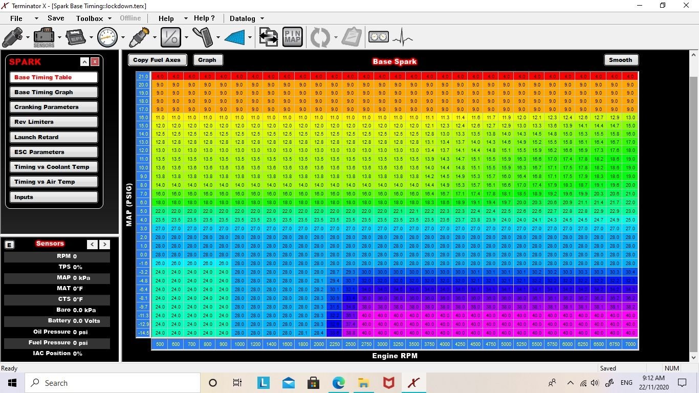

possible to get an opinion ? e85

Old Nov 22, 2020 | 12:31 PM

Timing looks light and l a little fat for e85.

That plug shows that you're babying it lol.
Also, why the .020" gap?

needs the small gap, i tried them ootb at .028" and get spark blowout at high rpm

I would run them at .022-.024. That timing is super crazy soft in boost for good air temps and E85. I made 1008 rwhp with 18.5 degrees on 23 psi on e85. We read the plug right after the dyno pull and it was perfect. Also you can't read a plug with multiple pulls or any normal run time on it. Make a WOT pull and immediately shut off then pull and read. You're leaving a lot on the table with timing. It is uber safe if that is what you're after but there is 50-100 hp in it with timing IMO. My car picked up 35 hp with just adding 2 degrees at like 8.5 psi. Don't go just making huge changes, but learn to read plugs and start adding some timing slowly. You want the timing mark basically right at the bend on the strap, unless you want it extra spicy lol.
