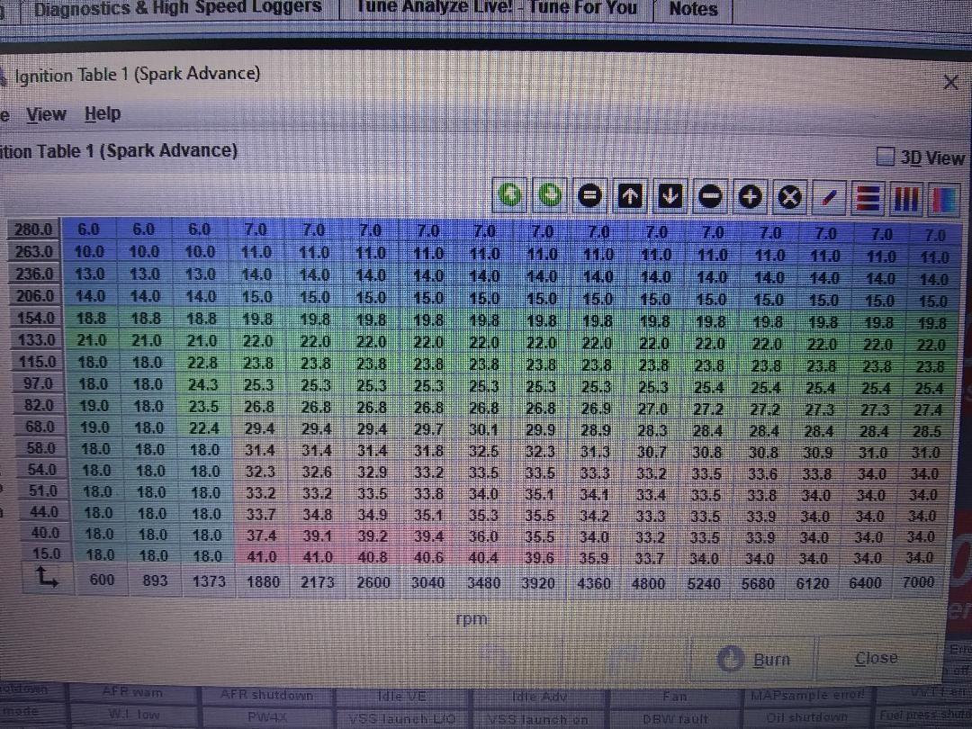

Update :
Got the car on a decent dyno place, with the s475 17psi only made 430rwhp, after they checked heat spots out everywhere realised one od my mufflers was ******* all up , so chucked on a elbow bottom of dump pipe boost to 20 and made 580rwhp.
but witht the exhaust back on , we are only making 510rwhp @ 16psi
he thinks should be closer to 590 @ 16psi but the gate opening is creating a turbulent wall at the bend , and possibly the bend even on its own creating problems . 3.5" pipe.
also he thinks 16psi 550ish safe limit for gen3 gear .
finally current timing on tune ,
common for single number input ?

lol you've gotta do something about that timing table. That's terrible.
Power still seems really low, but dynos rarely tell the whole story.

did seem odd why hes done it like that , but does pull just as good as it did before when i had it ramping from 26 to about the same @ 16psi.
i can get someone easy enough to dump the wastegate down , but the dump from the turbo is limited for room , i dont want to fix it and just be restricted at say 410rwkw now

That dyno graph makes me cringe.

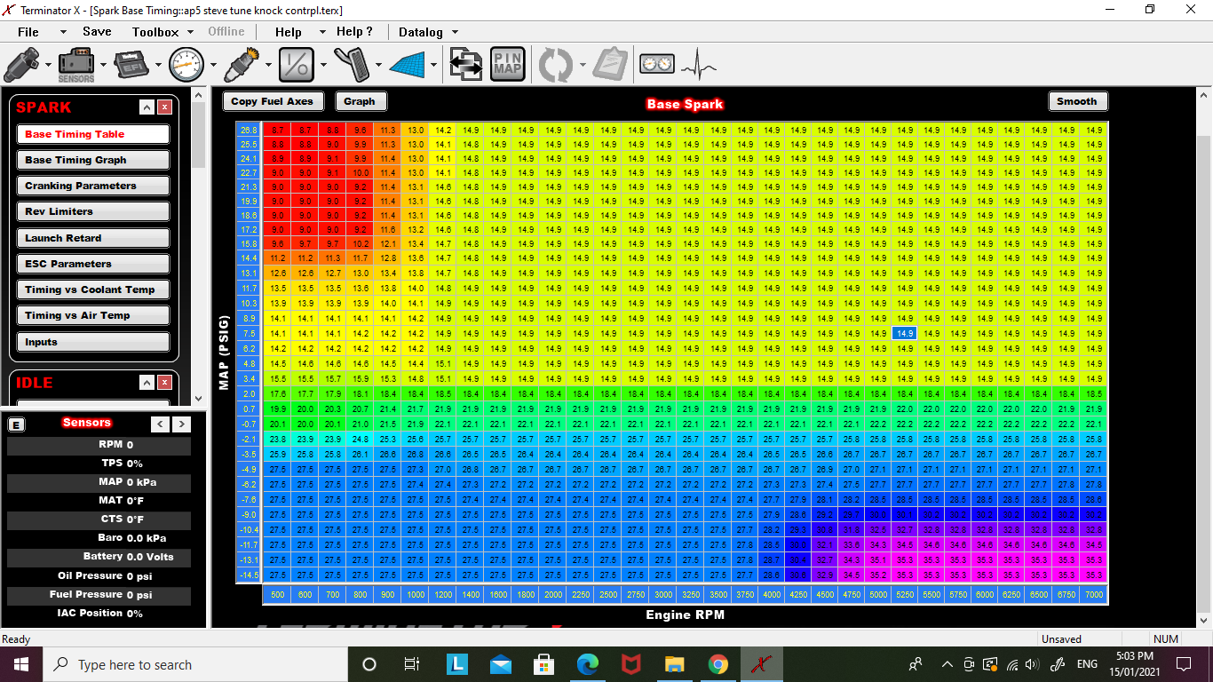

This is soft to make 750 wheel

That timing table is a mess. That’s why it’s lazy. I’d find a new tuner. Anybody that sets up a timing table like that shouldn’t be touching anyone else’s car. That guys feedin you a bunch of BS because he doesn’t know what he’s doin!

I agree response could likely be improved. But that doesnt solve the final power numbers at 14* and 20lbs. Should still be higher... assuming the trap speed falls inline with the lower numbers.

Do you find my table to be that bad or the op

Let's just say
At 16pounds boost it made 700flywheel hp.
Won't take any more timing here.
​​​​Do you think the wastegate plumbed in there is causing an issue, tuner think should make around 750 on16# this setup.
Not yours
