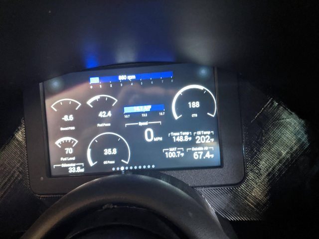

I already have HPTuners (15 years now), as well as an electronic boost controller, 2 step, transbrake, wideband, flex fuel sensor, and no desire to lose my factory fuel level and other gauges, or the cluster.
Not trying to badmouth Holley, and yes, the Terminator X Max (to control my 4L80E also) is $1300, but factor in all the little extras that you'll want or need...miscellaneous switches, pigtails, harnesses, sensors, and a $1000 "dash", it doesn't make a whole lot of sense for someone like myself, who has everything pretty well dialed in, and 100% functional already. $2500 will buy a lot of drag radials and E-85, lol.
Now on my son's car, an LS Turbo Foxbody project, it made perfect sense to go Holley, as we're starting from scratch.
I'm on several FB Holley pages and am a little concerned that there are so many people complaining about Holley's lack of support...as in there is none...or very little. I know people ALWAYS report the bad, and rarely the good, but there's plenty of bad to go with all the pedestal placing of Holley. I just hope our new experience is trouble-free, like many before us has been.
So, some of you may not think I am talking out of my ***, lol, I used the Holley Sniper on my Chevelle, just over 4 years ago when it first came out, and after dicking around with Fitech and their idiots. Had only 1 issue, their supplied POS wideband sensor crapping out within the 1st month or so. But aside from that, it worked great. The drawback is, the small, palm sized controller is all but useless, (unless you are parked) as a "dash", so you pretty much need to figure in a human sized ($1,000 or more) Holley dash in order to see what's going on...
Driving down the road, you ain't seeing **** on this thing:
