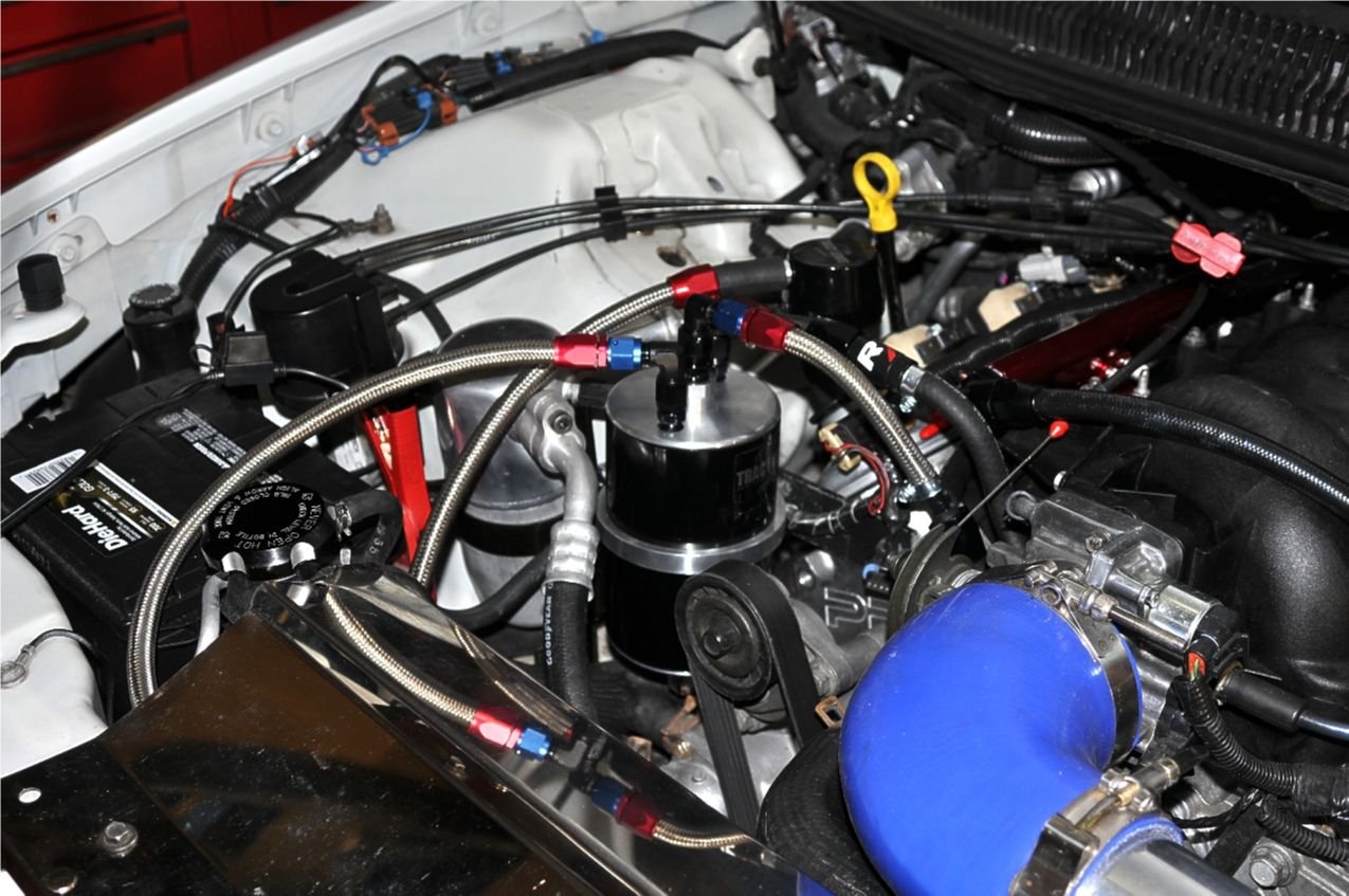

I have a MM draft can setup to pull across the valve covers. It gets suction from post air filter, pre turbo.

I have a similar setup except, like many others I am using a two port.
One line from the Turbo inlet that works as a vent under vacuum and vacuumed source under boost.
Disadvantage I see is you will draw dirty crankcase through turbo under boost.
With all that said , I still am creating back pressure to pop off the push in oil fill cap occasionally.

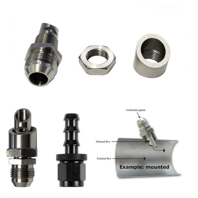

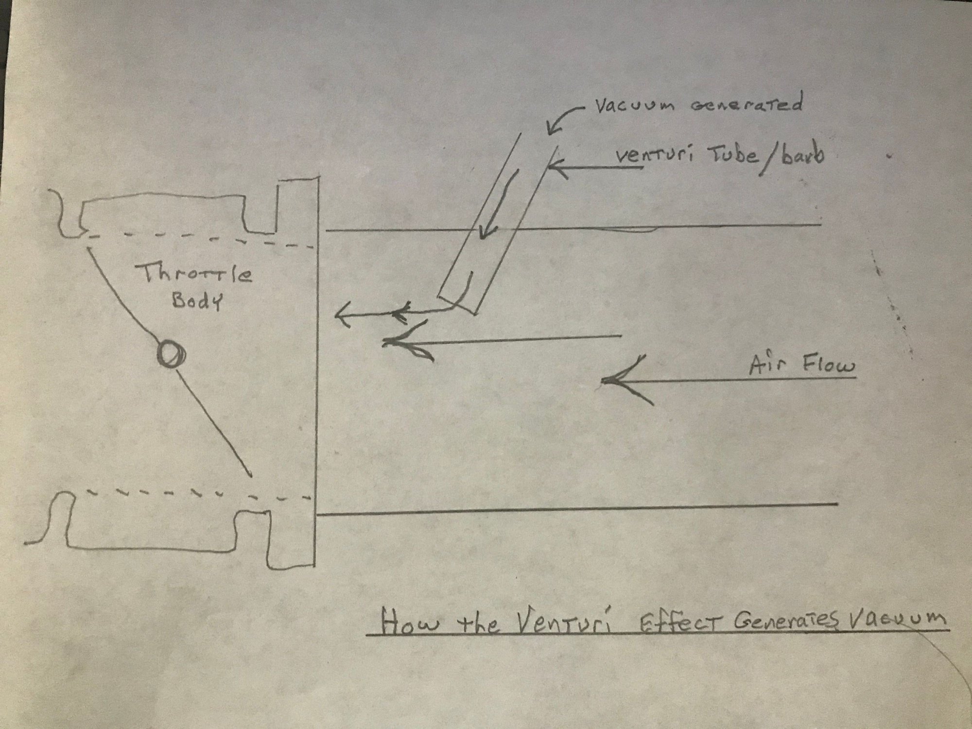

If back pressure is building in the crankcase to the extent it blows the oil cap off means that the check valves either under vacuum or boost aren't working correctly. As a result backpressure building in the can doesn't exit out of the can back into the intake side. Or the vacuum source to open and close the check valves isn't great enough.
Link to back pressure:
Vents like these will draw about 3 to five psi of vacuum if installed correctly on the inlet to the turbo or supercharger. The truck guys (Ford) vent cleaned air into the exhaust rather than back thru the turbo or the supercharger.
