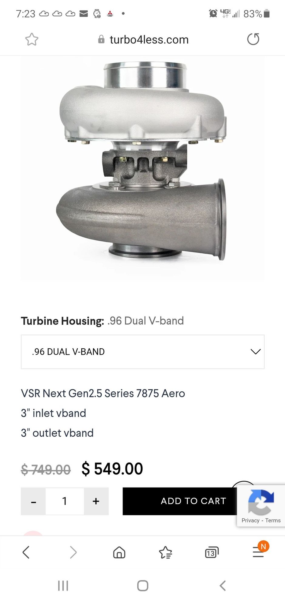

VSR 7875's gen 2 dual vband units.
what a/r housings?

Originally Posted by Taw_Thruat
what a/r housings?
The dual vbands only come as .96 to my knowledge, unless you get the much more expensive tial versions.
Old Dec 2, 2020 | 07:24 PM
Taw_Thruat's Avatar
Joined: Aug 2020
Posts: 73
Default Are these the ones
