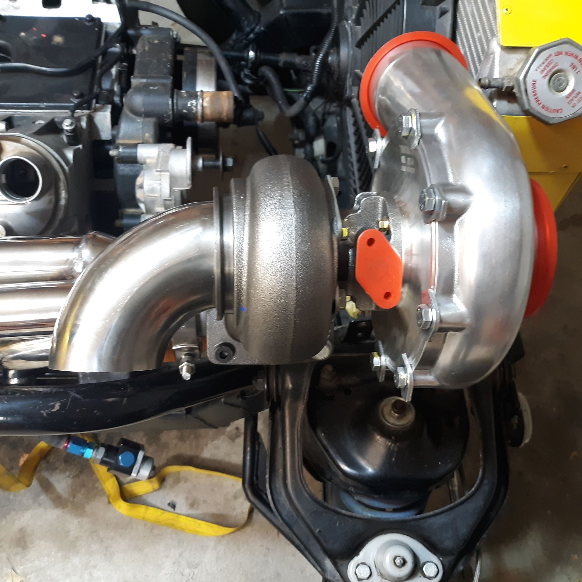

Whats the word on WB02 accuracy with a tiny down pipe.l? In my experiance as long as exh is flowing steady its reading accurate, though not so much at idle. I dont need it accurate at idle.
Id like to run a simple short 90. But if the WB02 will be wildly inaccurate at wot and cruise i suppose I can add some piping.

You'll likely have a really hard time getting an accurate reading with one that short.
The actual opening on the housing is a lot smaller than the piping, and the velocity coming out will be extremely high.
It won't allow enough time for the exhaust to disperse evenly, and you'll end up with spots that have stale air that will likely be mixed with fresh air.
You're only hope is to put the sensor on the outside of the bend radius in a spot that puts in directly in the path of the turbine wheel, and just always assume its going to read lean.

Well dang... as much as I'd like a tiny DP on there It's not worth having inaccurate info. I was thinking it was more of a heat issue and once EXH gas was flowing at WOT or cruise it didn't matter. I'll have get something longer on here. Appreciate the input! I usually run these since I have the the sensor pretty close to the exh exit on my stuff.

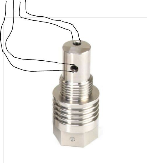

They are used to reduce heat imposed on the sensor from the exhaust. There is no reason for them to skew readings unless used in a very weird way.

After looking at this it seems to have a back pressure sensor and then uses the pressure data for the sensor to calculate the offset. I also thought it would be possible to program this effect into a megasquirt table or with hptuners maybe a custom histogram that would take into account the back pressure might work. I saw a yellow bullet thread awhile back about this. It seemed doable to me then too but then work probably made me forget about it.
as for heat the one I saw actually being used had those little heat sinks like the earlier pic on every sensor. I need to see if this is possible. Add another to do to my list. Lol.

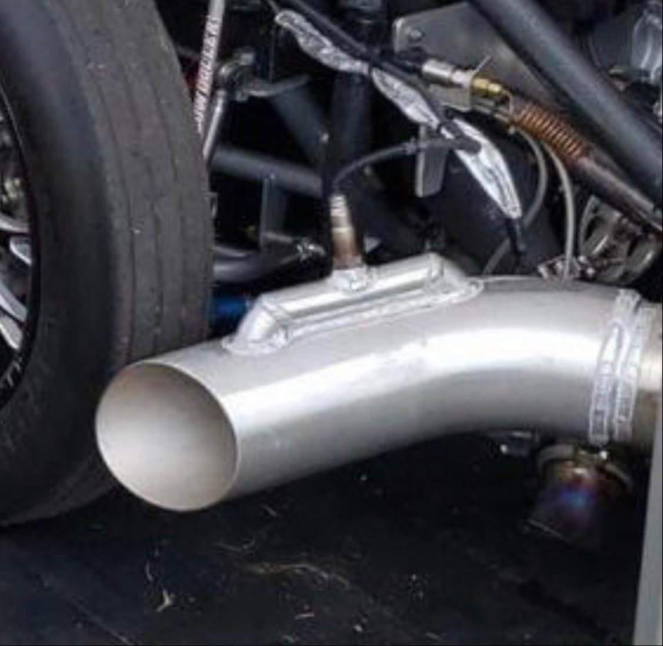

I came across a picture I had saved fwiw

Would be nice to see inside that...hopefully the inlet extends into the main pipe to catch more gas.

Like you I agree. It should extend some

I don't think it skews at all WOT. There's enough flow around the sensor to keep it happy. So you don't want to alter the tables or skew the sensor maps. They read lean at cruise an idle in my experience. I could care less about idle, but they can make drivability tuning a bit of a pain. That and the sensor life is reduced the closer and hotter it runs. Believe 900* was the suggested max temp on the standard bosch sensors. The bungs isolate the sensor quite a bit and have a tiny inlet holes. I've run them right after the turbo with no heat issues. Wondering if you could weld a SS tube to that tiny inlet and route it much close to the turbo so it couldn't "mix" fresh air in and skew the readings as much. May be more trouble than its worth...
looks like with those bungs installed you can have them up to 2" from the exh. port. So should be more than cool enough anywhere in the DP.
