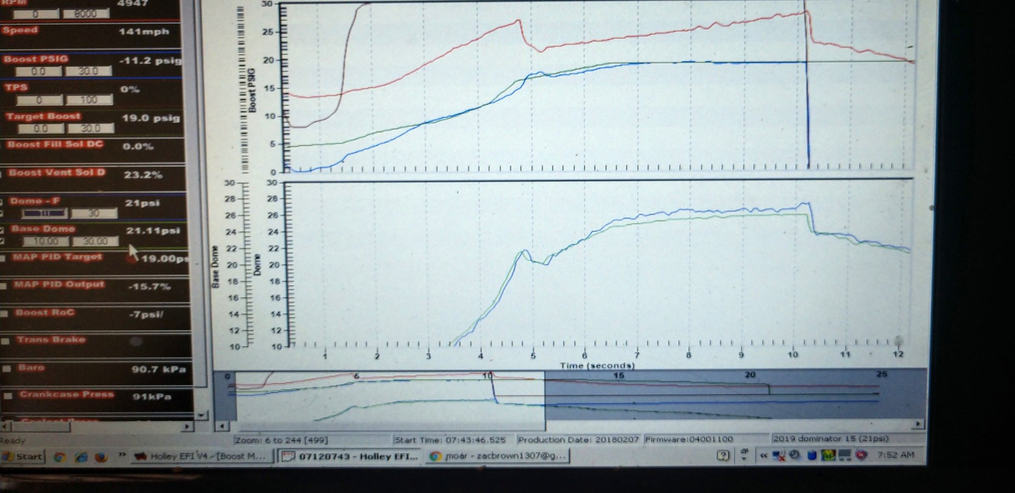

And here I thought we where going to see data shots.... Like this
That is dual solenoid.... Running is actual closed loop control targeting actual boost....on 25$ humphreys
on the street running 3 seconds passes where exact and consistent power delivery is everything
