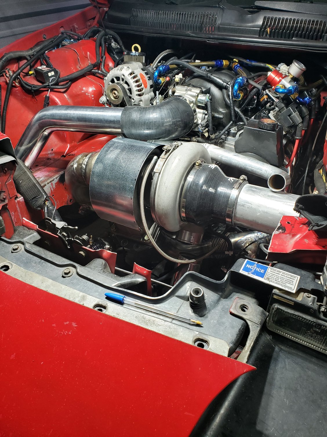

Worked on it over the winter. Took off the Twin GT35's, bought some log manifolds off the 'net that while made for S10's, really fit well in my 96 Fbody. Welded up a hotside and cold side. Using two Tial Wastegates since I have the divided housing. Forcefed convinced me to use a 2.25 hotside piping to feed the T6 flange. I'll be running E85 this summer. Also installed a Summit stage 2 Turbo cam. She fired up on the first try. Had to address a faulty power steering line I fabbed up but other than that, I'm really pleased. She has a bit of a lope now when the A/F meter indicates 14.5:1 on the 93 octane still in the tank. Right now, the exhaust transitions from 5" to 4" to 3" on the Borla Catback but I have a 3.5" Electric cutout that will be coming off the 4" downpipe to a fender exit.

That intake pipe makes me cringe.
Turboguard screen ftw.
My S484 had a filter on it but I figured it was so high up in the engine bay that a large screen would be just fine.

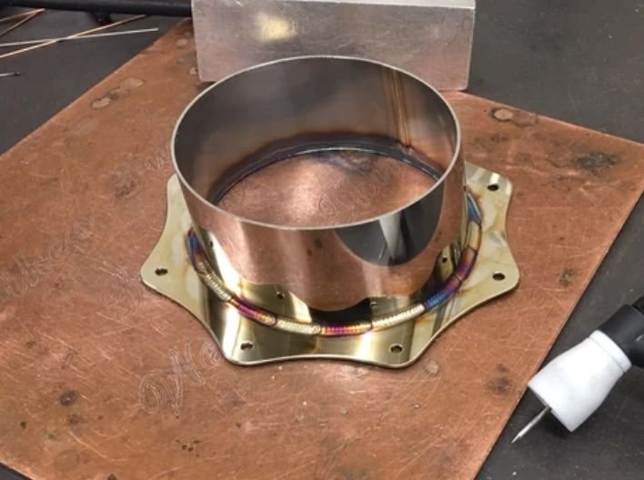

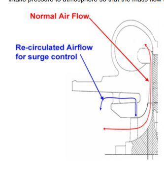

IS that intake really that bad? If the center of the turbo is the only area really "sucking" air in and not the surge port... Do you really need a mammoth 6" pipe on the inlet of the turbo? Or could you size the intake pipe to the minor blade size of 80mm? Which is only 3.14". So Im assuming that's 4" there? Isn't that technically enough? if the charge around the surge ports are just recirculating? is a massive inlet pipe needed?
I'm asking BTW... I have no idea.
I have seen back to back dyno pulls with that rubber 90* bend on the TB removed and replaced with a nice transition of 3.5" pick up 40whp on an 850whp setup. I was pretty surprised by that.

Thanks Forcefed for adding some context. I wasn't sure what the prior comment was about. I bought a huge 5.5" inlet K&N filter for the turbo but didn't count on the radiator pipe in my mock ups. So, I put that 4" tube and reducer on there. I take it from what you're saying that the reducer is masking or covering up the surge port? I can weld up an aluminum transition to open to that 5.5, maybe even angle it down to clear that radiator tube.

Before putting time/effort into changing it, id get some data. Maybe run it with the hood off? Try your intake setup now. Then try an open 6" 90 facing up maybe? Hvac piping works well for this. It has joints and is cheap. you can shape it how you need and glass over it. The 6" alum piping is ridiculous $
Will be hard to get good comparison data if one setup is sucking hot air form the radiator and the other is not. Im actually wondering if what you have is fine, and many are OVER intake piping the big single setups. I'm not sure you need more than a 4" inlet in terms of flow for an 80mm turbo. I'm just not sure how that funky reducer will effect airflow and the surge ports. Let us know what you find, I'm curious!
Thats 5" alum dryer duct. Once glassed, I could stand on it. Plenty strong.

I went online , looking for some straight 5.5" aluminum tube. Found some and it's ordered, along with a 5.5" silicone coupler. When it gets here, I'll measure out what distance I need to dip below the radiator tube and then pie cut some welds
