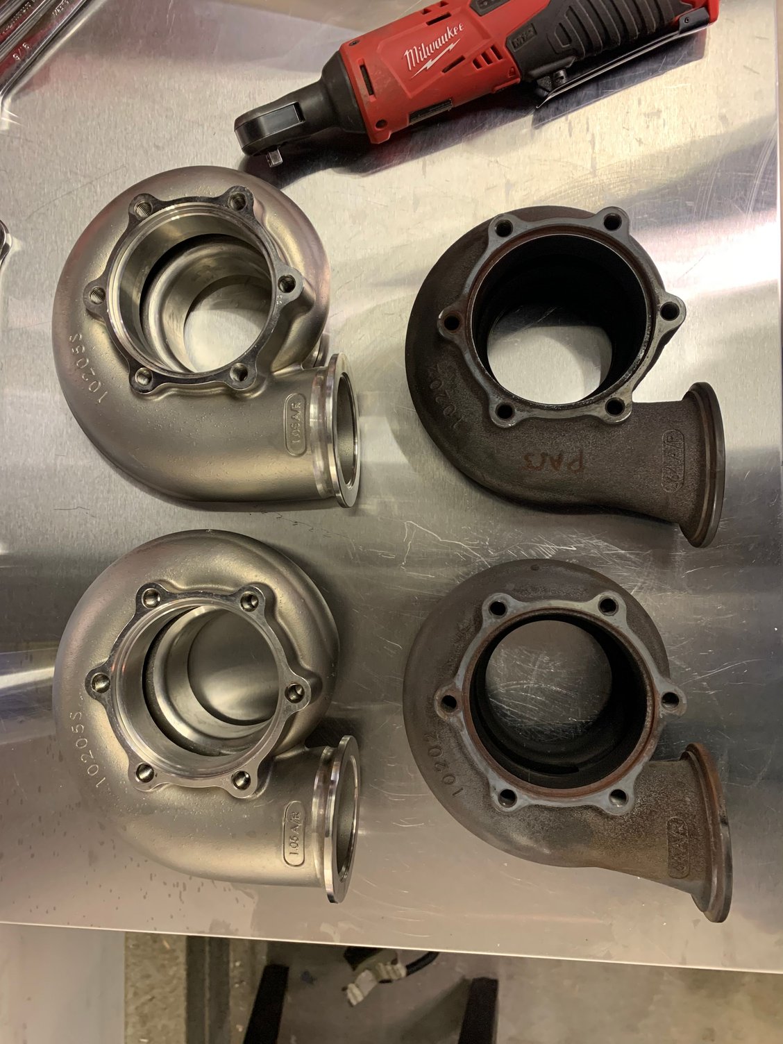

have to modify the thermostat housings a bit to clear. But you can tell they will flow a lot more.

Defiantly NOT the turbine housing. I run the .63 T3 China GT35s (billet 64mm comp versions) No intercooler on an sub 9:1 5.3 and baby cam. Making 560/600 on 11-12lbs. Haven't been back to teh dyno yet, but I run 19 now and its a whiole new animal. Far from optimal setup but making substantially more power.
I'd go back to basics. Not that the new housings are bad... But look at your cranking compression, plug gaps, etc... Also fuel consumption is a biggy.
Also for what its worth the cast $110 Gt35's with .63 T3's have made 854/989 @ 29.5 lbs on a mild SBE 5.3.

Another strong vote that it isn't the turbine housing here, from multiple instances of personal experience.
The ONLY possibility that it is backpressure making you lose that much power is from a camshaft that handles it poorly.
you could be right. I guess the dyno will tell. I’ll do a compress check. But the motor is pretty solid. Sounds good and no smoke under load and not much steam from the catch can with two -10 fittings.
i think I was using 60% if the fic 1000cc injectors. But at 11.0 afr.
i wonder if your housings are as restrictive as these. And if my 10:1 compression just pushes that much more air.
also at 13psi I’m sure I could if made 500+ but we didn’t add much timing. The last degree we added picked up 20whp. Then we added more boost because we thought it would of made more at that boost level.

Or maybe an improperly labeled hotside? I had the standard flange t3, not the Vband. Those do look pretty small, but mine weren't exactly huge. China is pretty bad with that. Ive had some china .8x T3 hotsides that were MASSIVE. Likely 1 1.25 or larger T4 equivalent.
This is my .63AR GT35 T3 next the ".83AR" 72/68"
Attachment 712962
I was running a 220/226 @ 112 .525 lift cam. Believe the malibu had a stage 2 btr but I'd need to verify that.
