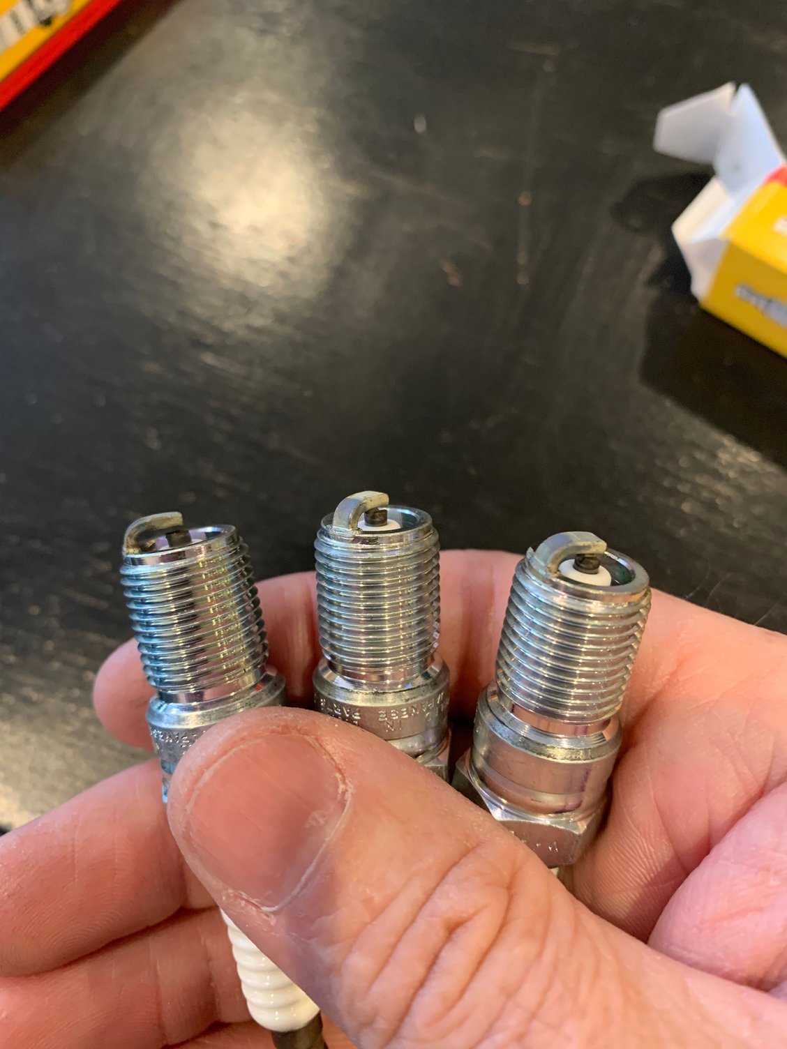

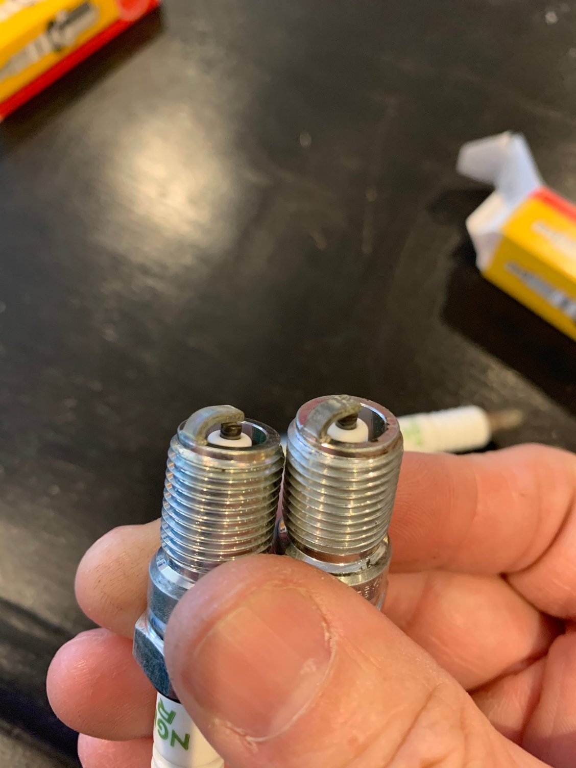

you could be right. The first 3 plugs is when we were at 477whp. And the last two is when we added some timing to the 15psi. So adding the two psi only added a bit. Then we tried for more with the timing.
figured the back pressure was getting high and called it a day.
