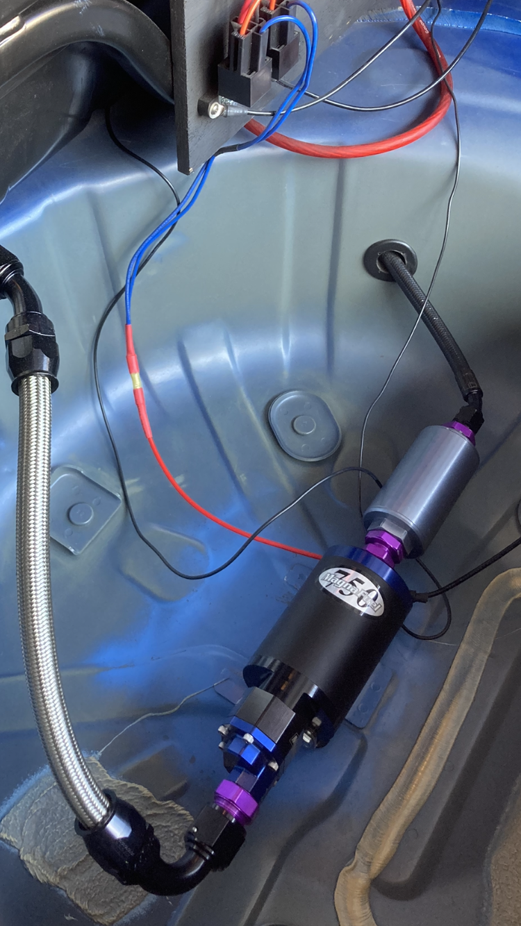

Here is my pump setup.
Old May 18, 2021 | 10:09 AM
  #37
Forcefed86's Avatar
Joined: May 2011
Posts: 8,483
Likes: 1,028
From: Wichita, KS
Not saying the wallace calc is correct. The figures have always been high IMO… more like crank HP. But it’s all relative if we are using the same calc.
So using the wallace 1/8th calc puts you at 898. And my car at 955 on E85. My only point was w/ e50 you should have quite a bit more flow left. Should be able to crank the base pressure. Unless that supply is a restriction.
I'm sure the LS1 TB will work fine. But I had heard from Bob and a few others that the TB actually helps quite a bit on blower cars. I have little experience with them.
Old May 18, 2021 | 10:15 AM
