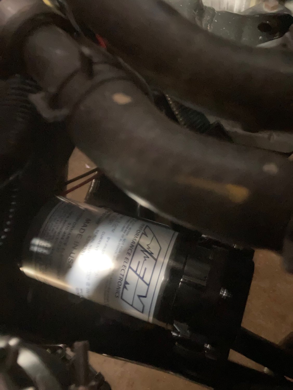

That wiring on the fuel pump looks on the small side to me, but pictures can be deceiving.
The wiring from the battery to the trunk is 4 gauge to a distribution block. Then I have dual 40 amp relays to I believe it's 12 gauge wire from relay to pump. Very short run of wire from relays to pump and I have pump grounded to multiple places.

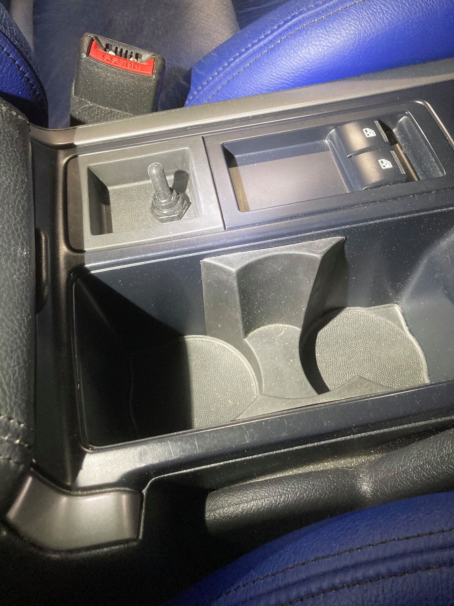

Got this toggle switch wired in yesterday so I have the option to disable the water/meth during a burnout. Amazing how clean your interior looks then you take a picture and see all the dust...LOL

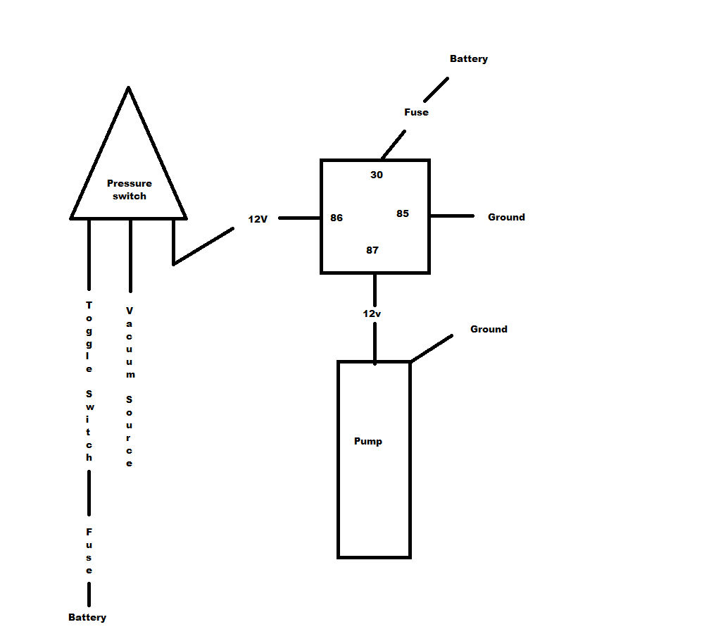

So while I'm waiting on parts...I came up with this. Does this look acceptable for a simple on/off?

I would suggest making the power source a switched key on source. That way you need both boost and the key on. Allows you to pressure test the cold piping without accidentally tripping the pump on. Just another failsafe.

I totally knew that when I removed my front sway bar it’s mount bolts would work perfectly with the mount supplied with the AEM pump. 😄
System was tested by putting 5 psi to trigger and pump runs. 👍

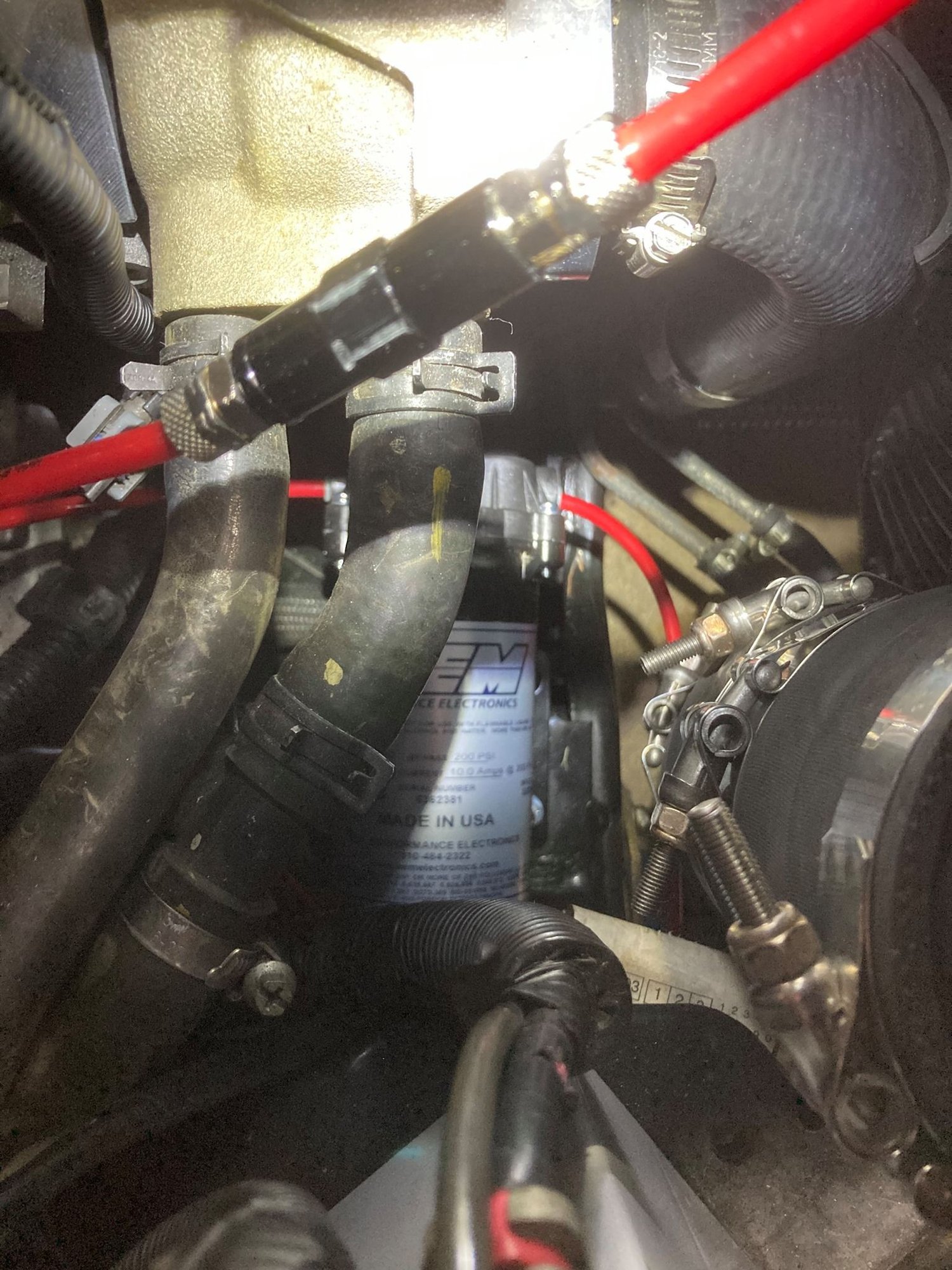

It's cold and rainy today. At least I have a long weekend to play around and get the tune dialed in. I was amazed how long it took the pump to prime even with only about a foot from the windshield reservoir to the pump. Very small seep from one side of the check valve otherwise good function and simple install. I think I'll go ahead and put some wiring loom over the hose in the engine bay as well as the wiring for the system.

Wiring I get. The meth line I like to keep exposed so I can see if it ever leaks or breaks. Did you get far enough to see the nozzle spray pattern?

Wiring I get. The meth line I like to keep exposed so I can see if it ever leaks or breaks. Did you get far enought to see the nozzle spray pattern?
Oh yes I like the spray pattern. I made sure I had a good spray, on off function, and leak check. The check valve seeps a bit I tightened it and tested again it's almost nothing, but I want to get it completely stopped. Probably should have ordered the snow brand sealant with their check valve. What is your preferred sealant for meth injection stuff?
I just use the Teflon plumbers tape, not the paste, and it hasn't failed me in 2 years on a DD and I've gone through gallons (literally) of WWF.
