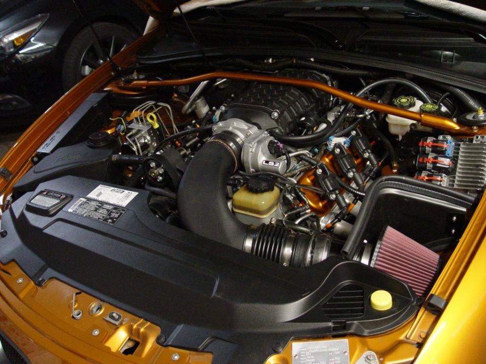

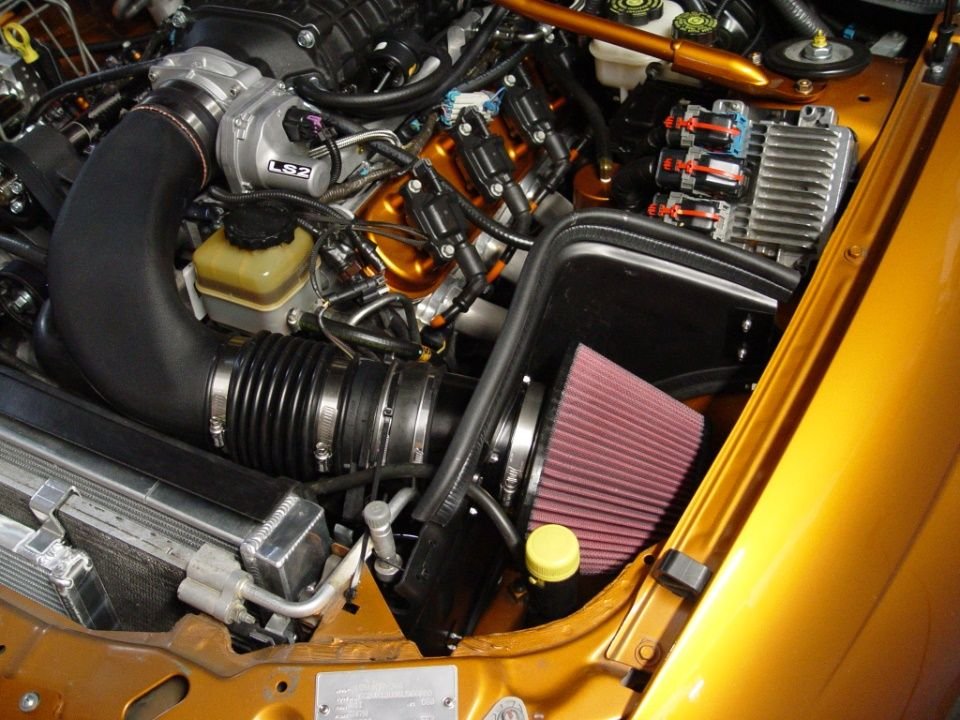

Okay, here's my review and impressions after the Lingenfelter went on. I did a lot of little things on the car this weekend, installed the push connectors on the evap lines, tidied up some hose and wiring routing and of course installed the Lingenfelter which turned into more of a job that expected to get it to sit right so things would fit together as well as they should. In the end, the freshly charged battery could barely crank the engine so I had to drain the Maggie cooling system, remove the tank and replace the battery. No big deal, just a little extra time and work.
So, I took the car for a good little drive to see how the new intake would do. No codes, ran great. No leaks which was also great. I got it fully warmed up and did some mid-gear pulls, no hard launches because it was only just above 40 degrees out and I'm on Summer only tires. The first pull was just a gentle acceleration in first and then pounded it in 2nd and third. Lost traction almost all the way through 2nd. That's partly due to the temps and the tires, but it was pulling like a beast. This is a LOT more like what I expected when the blower first went on and was fully tuned. I'm still shocked that an improved intake and filter could make so much difference, but really I shouldn't be. A blower moves a lot more air and I was obviously choking it down with a paper filter due to my stubborness. Well, I got over it at least. Also, losing the stock air box could only be a benefit. I didn't notice a real change in the intake sound but maybe because I mostly hear the exhaust and the blower or maybe there really wasn't much change in the intake sound. Doesn't really matter, but I kind of expected a louder intake sound.
The Lingenfelter is kind of expensive for what you get but in the end it did fit pretty well and it is obviously pretty effective and really was my only real option for the Maggie aside from stock since I really don't at this time want to drop the change on another DuSpeed and a new heat exchanger. I wonder how well the Lingenfelter will work in warmer weather. Will be quite a few months before I can know anything about that.
About the change in the car with a better intake, all I can say is WOO-WEE, this is a lot more of what I expected when the blower went on. One interesting thing happened as well. I have my boost gauge set with a warning light to go off when boost exceeds 6 psi (the max it should do per Magnuson). On the first harder pull, I noticed the light went off. It didn't just blink, it went on and stayed on for a while. On the next few pulls I actually glanced more seriously at the gauge and I was getting 8 psi, sometimes even a little bit more on the harder pulls in 2nd. Not sure what to think about that, but it certainly never did that with the paper filter so yet another indicator that the engine/blower are much more effective and efficient now. Also, I assume the gauge is accurate, it certainly should be for what it cost (Speedhut). But the key point is that I was getting substantially more boost than before. Also, when doing these harder runs, it redlined like a beast and clearly was not running out of fuel even given the more than expected boost. But I still need to query my tuner about if the tune will need some adjustment given the more than expected boost.
Engine temps never even got to 200 degrees even for a second, but like I said it was only about 43 degrees out. Given the outdoor temps I couldn't really expect to do any meaningful 1/4 mile runs. The street tires would never help me get out of the hole and I suspect the drag radials wouldn't do much at these temps either so I didn't really even try. BUT, given the SOTP impressions thus far, next Spring when it warms up and the roads get cleaned off a bit after Winter muck I plan to strap on the drag radials and see if I can set yet another new personal best. It is going to be a lot harder to find that sweet spot of enough traction out of the hole without bogging or spinning. I think a trip to the semi-local drag strip will be in order next Spring.
I'm considering getting a spare set of 18s and having them widened for the rear to get some bigger meats out in back for when I eventually replace the street tires. I think it would look pretty good too to have a bit of a staggered set up.
Bottom line: I am much happier with the blower install now than I ever have been. I'd also add that I now wonder if dropping the cats will make much difference, it sure doesn't seem to have a choke point at this time. But I still plan to get it back to the dyno and find out.

Night and day difference may be a bit of an exaggeration, but the difference is definitely meaningful. The fact that the boost gauge showed a marked difference too would seem to indicate that its not all in my head or simply wishful thinking.

New numbers. 490hp/453tq
Now that's more like it. It made slightly more power with the exhaust connected than it did with the cats dropped and running open headers. Fact is stranger than fiction. But then to be fair, the tune was not adjusted at all to accommodate the open headers (since we couldn't get a good AFR reading due to the open headers).
