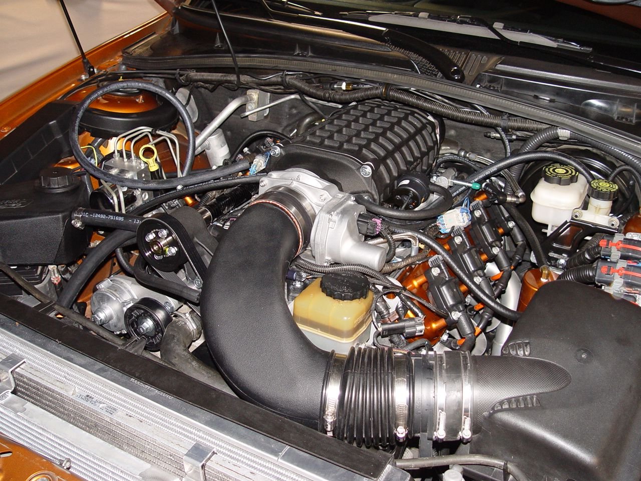

Took it for a little spin today. Can't really get into the throttle with just the basic tune in it but it starts, idles and drives nice for what I can do at this point. When I first started it it was smoking off the engine on the driver's side. Turns out I spilled a little oil on the head and header when I had the valve cover off. That was a momentary butt pucker though seeing all that smoke and smell. I just barely got into boost for just a second or two, that sound is going to be addictive.

According to the video 456hp/433tq

Originally Posted by Rich-L79
Sounds good, love the whine from the supercharger! Looks like it made good power, do you know what timing was and I'm guessing 91 octane?
Yes, 91 octane. Can't find 93 around here anymore. I think timing ended up at 22 degrees advanced.

Rich,
i have a very similar set-up to you. Great job on the install. A smaller pulley. like 3" or 2.9" will go a long way with your set-up. Im not sure what your boost levels are but with headers, mine dropped down to 4-5 psi. a 2.9" pulley on your same set-up moved me to around 8-9 psi. with your DW 300c pump, you are plenty set for the extra 50 hp at the wheels. just letting you know. this set-up is awesome and i hope you enjoy it.

It runs great, drives just fine. Just a little disappointed in the power output but we have a few more things we want to check into but just haven't had time to do so.

Congrats. So it is an LS2 stick car with stock cam?
Yes on all three.

So you made about 350-370rwhp before the blower?
