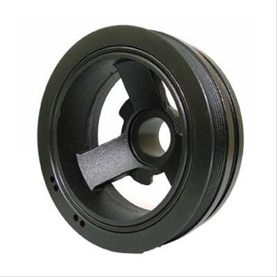

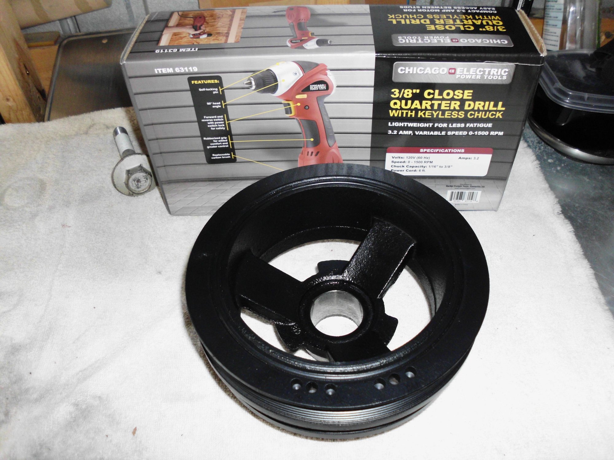

Solid one piece? Not much of a balancer then, just a pulley. That would be a VERY bad idea. Look up the Powerbond OEM replacement, it is EXACTLY the same as the original one on the LS2 (which is what I'm working on). My balancer has not been changed (except when I removed the one pictured some years ago to put on an SLP underdrive balancer which I just took back off recently), I've had the car most of it's life.
My original balancer:
The image of an OEM replacement Powerbond taken from Summit:
Both are balancers, both are the same item.

Stock ls1 pulleys are NOT balancers at all. Why do you think the stock items are not keyed? It is because they are only pulleys. A true balancer would require being keyed to a specific rotation. The only reason for any rubber isolation is to reduce some bit of vibration. None of your pictured items are designed to balance anything. They are just pulleys.

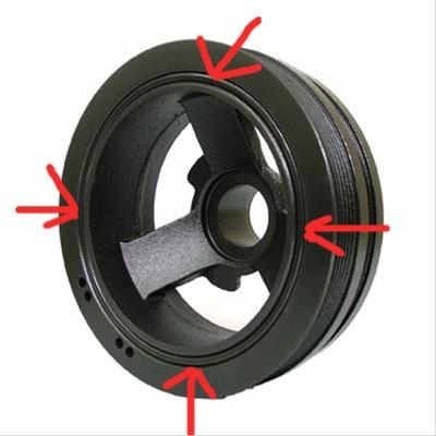

You can see the rubber ring in both photos. A balancer doesn't need to be keyed if the engine is internally balanced, its purpose is to absorb vibration and shock to the system.. On old SBC and BBC engines for example they are keyed because they are used to set the timing and as such the balancer has to be properly oriented to the crank. That is not the case on an LS which is computer controlled. Regardless, these are dampers/balancers and do have an outer ring of steel/iron connected to the inner hub by a rubber ring.

This ring is rubber.
