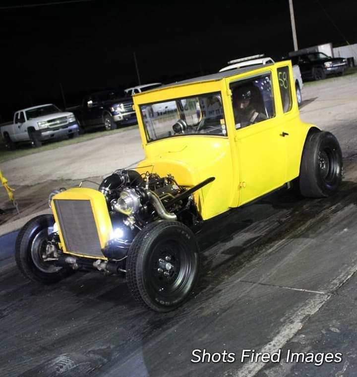

The 27 ford I have now has 78/75s non intercooled. I'm not even using water/meth on it... its light enough I'll hit the cage cert before Id need an IC. Also really didn't have the space!
