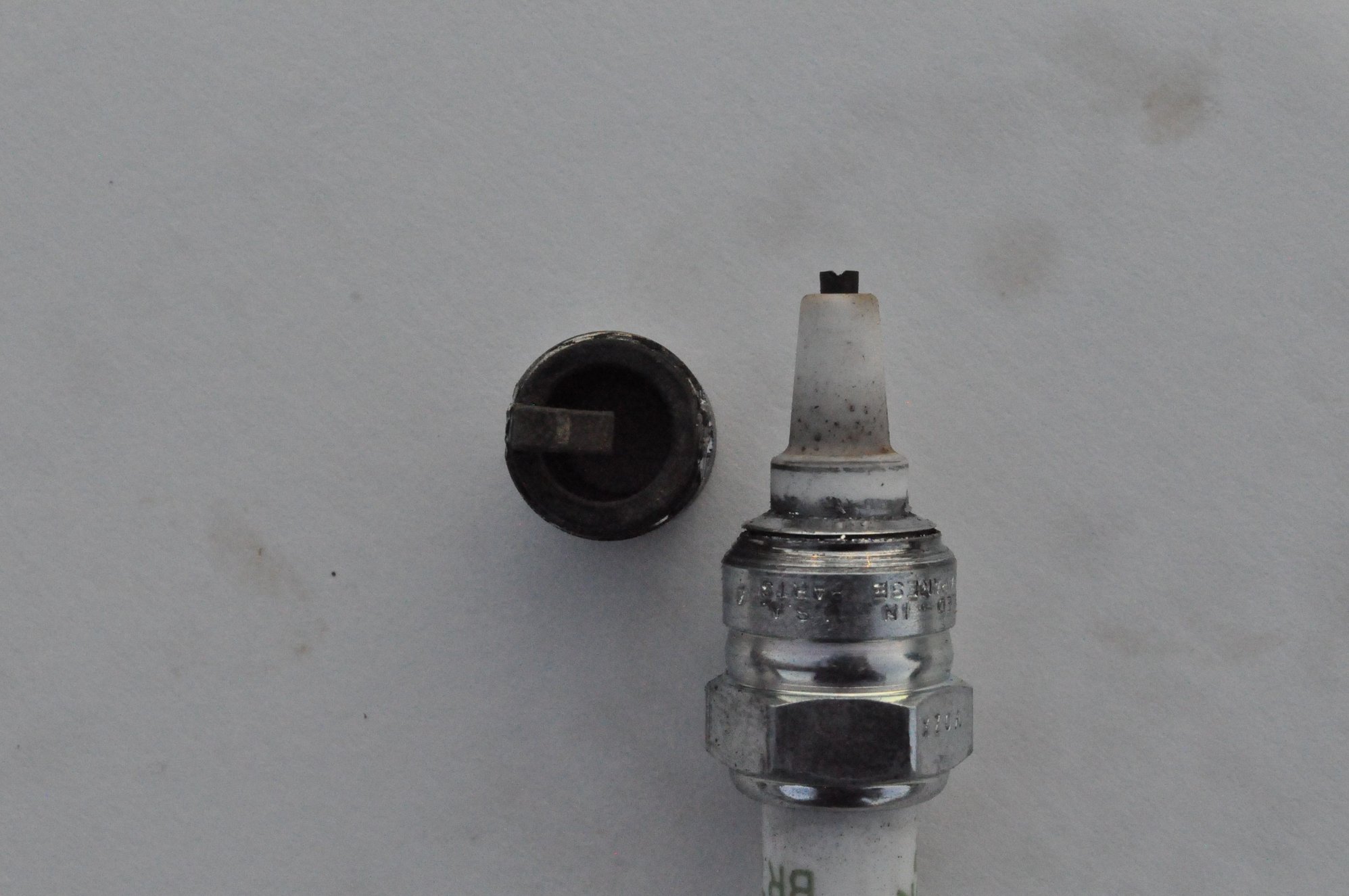

I posted a pic of the plug from my car.It might actually be slightly lean.I cut the threads off and its got some tan but also some black specs on it.I got a new set of plugs and will use old for warmup and then tow the car to the line and make my run with new plugs.The plug in pic I ran and then took out after a pass.It was in the car dooring a couple passes so its not 100% the way it needs to be when checking plugss.I will be alot more accurate next time out

For comparison, my plugs look almost new after a pass on E85. Zero soot/black. No real visible fuel line either. Nickle plating is all still shiny and new aside from the strap. Do you have a WB02?

I have a lm2 wideband and can record on it.I use the lambda scale and its usually around .70 on the scale.The plug in the picture is after the 3rd pass so didnt get to do exactly what i wanted to on them this time.The plug looks really bad in the picture but isnt that black,I dont know whats with the pic.I posted it mostly for the strap and the ring around porcelin.

.70 is 10.3 on gas scale. That's beyond the peak rich power window for E85. I'm not saying you'll pick up 50 hp, but there's really no reason to go richer than 10.8 or .75 or so with E85 IMO. Factor in the meth and your likely around 10.1: ratio. Defiantly too rich. Its extremlyhard to read the fuel line on an ethanol plug. Most rely on the WB02 for this.
Your also not spraying much meth at all IMO. I'd step up to your biggest Meth nozzle, what ever that may be and have it kick on at higher boost levels to eliminate "bog". Target about 11.5:1 (.78 ish) AFR on E85 with no meth. I forget this isn't always the easiest for carb guys. Its 2 clicks for us EFI guys.
What I like to do is get a read on all 8. Find your leanest cylinder, and just swap plugs out of that cylinder. No reason to waste 8 plugs every time to get a read IMO. I pop one new plug in before a run and setup my timing table off my hottest cylinder. (oddly enough #4 in my case)
IF you are pushing water I'd dial back the timing at PK TQ. That's where your cyl pressures will be the highest. I don't put diddly for timing in my stuff until 5500+ RPM wise. much better off adding another 2lbs and dropping 3-5* out of it until its dialed in and not pushing water IMO. Personally I'd pull timing until it didn't push water. Then slowly add boost up top.
