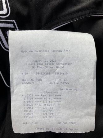

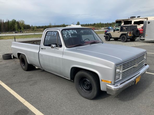

Two summer of tuning and I finally did it, 10.8sec@124mph.
Stock chassis
Stock suspension, (added 1 ton front sway bar)
ford 8.8, (3.73)
TH400, 3400stall
5.3L factory bottom, never disassembled
Factory ECM
summit stage 3 turbo cam
80lb deka's, walbro 400lph with 17.5v boost a pump, 6an feed line, 83psi fuel pressure at 26psi of boost.
VSR 83x75, cortex boost controller
3" intercooler A2A
$280 ebay hotside
Water/meth with two 10GPH nozzles
Full 4" exhaust with dead quite dynomax chambered muffler +28" resonator (quiet as stock truck, minus the whistle)
Still got the camper bumper and the ball hitches.
26psi of boost on 90octane pump, 11* of timing
Ran on M/T Street E/T SS 30X12.5r15 radials.
4 figure budget.
Super Sleeper.

Originally Posted by forcd ind
Man, that's pretty amazing, it has to weigh over 2 tons, I know my 86 did.
Good job, what were your IAT's at that boost level.
140* leaving the line, 104*@60mph and 118* at the end.
Originally Posted by Sodak66
are running a stock leaf setup? No traction bar?
Yep, the only things I changed as far as suspension and chassis goes was I added a front sway bar from a 1ton 2wd c-30 and I changed the factory steering shaft from the rag joint to a Jeep one with a real U-joint and cut one coil off the front springs to lower it. The back axle is just flipped to the top of the springs. No traction bars.
I never did run into any traction issues.
I think there is a video of it running an 11.4 at a RaceWars street car event from this year but I don't have one of the 10.8 run.
