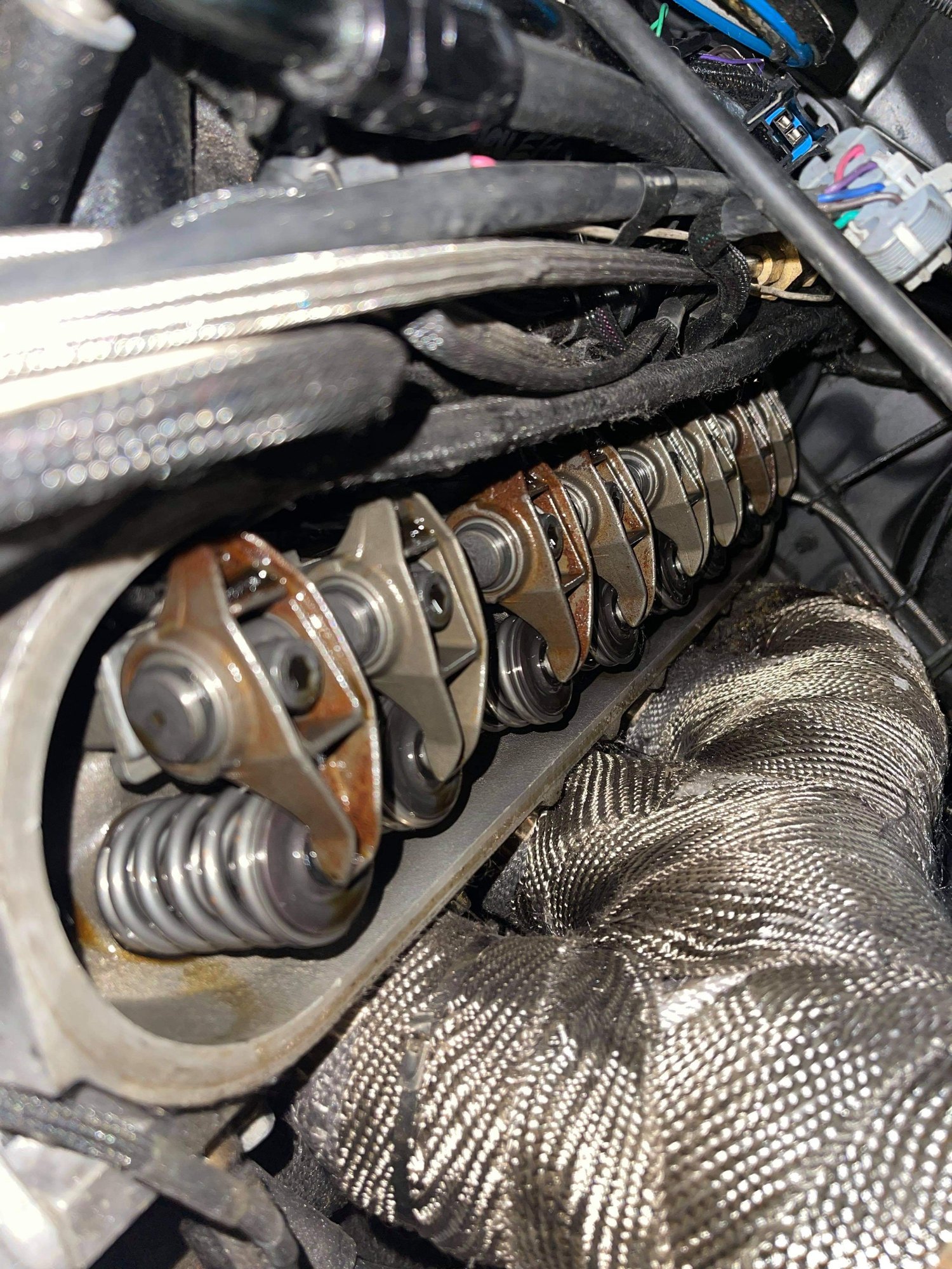

IMO, sell them little turbo and go with a bigger turbine (bigger than the 7875). I made the jump with my s475/83 T4 to an s475/96 t6 and the difference in power was unreal. Don’t worry about late either, this t6 spools as fast as the T4 did, I’ve got logs to prove it.

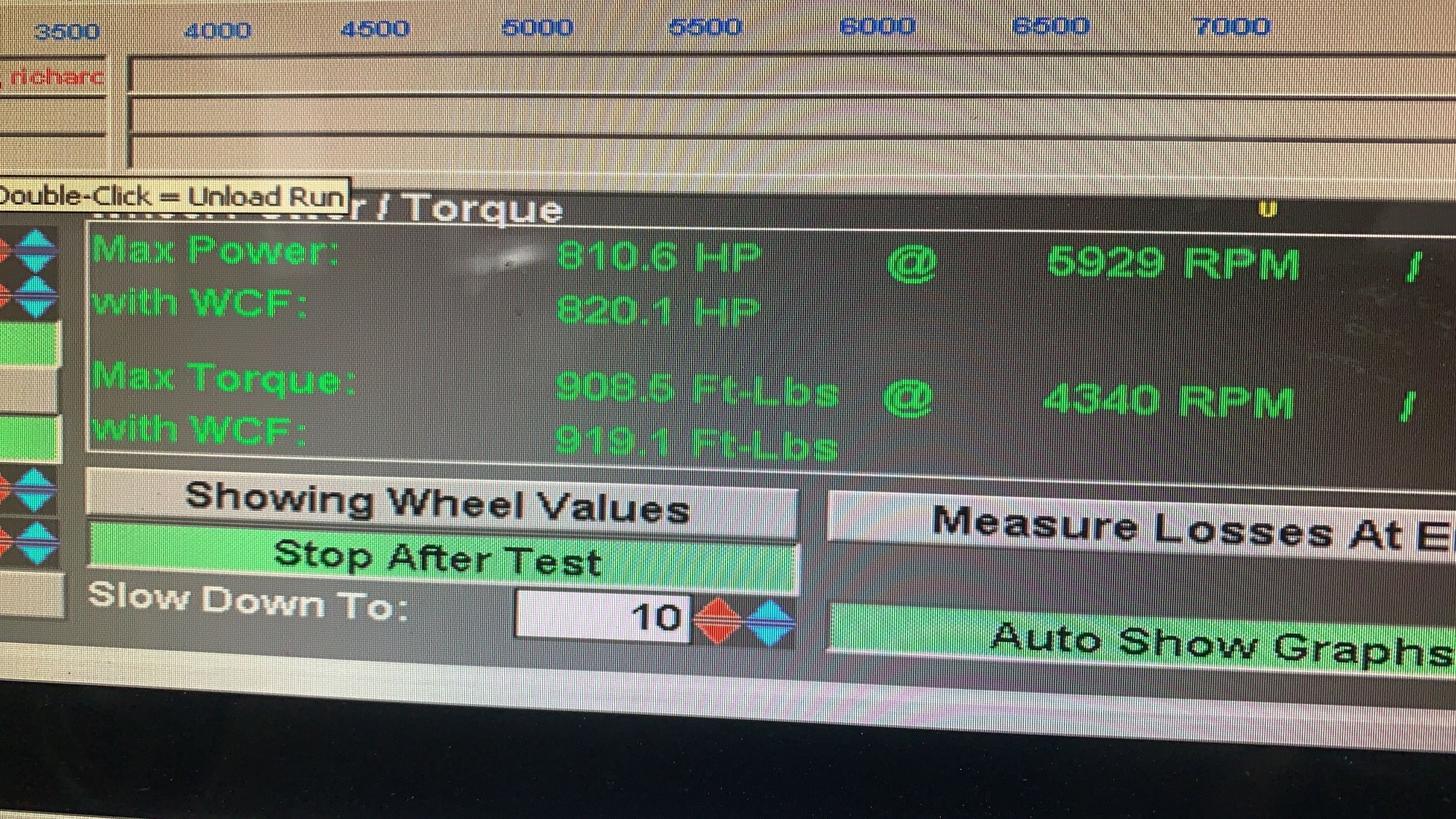

I have stock gen3 5.3 bottom end and making 900tq and 827-ish HP on mustang dyno.

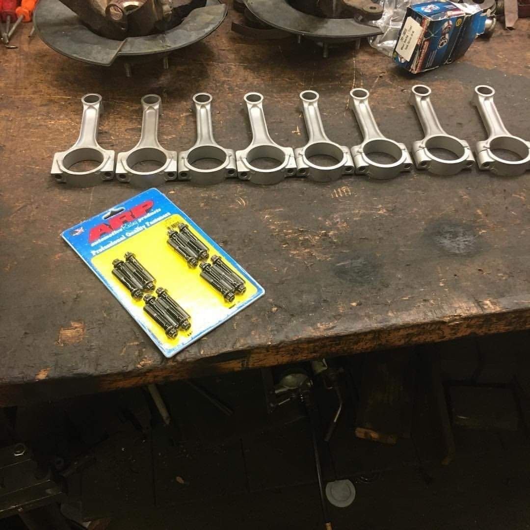

My bottom end has arp rod bolts and rods were resized for them. no, I did not waste time to put them in there BUT my motor seems to hold up pretty good. Not sure what’s the secret to it but maybe the rod bolts help. I’ve revved to 7500 fine and turned rpm down due to spinning worst (added timing up top to hold power) 93 pump gas with M1 spray after 4psi.
are you pushing any water with our setup and are you running stock style heads.If you are running stock heads what kind of boost and how are you keeping the heads on the engine without pushing water...thank you

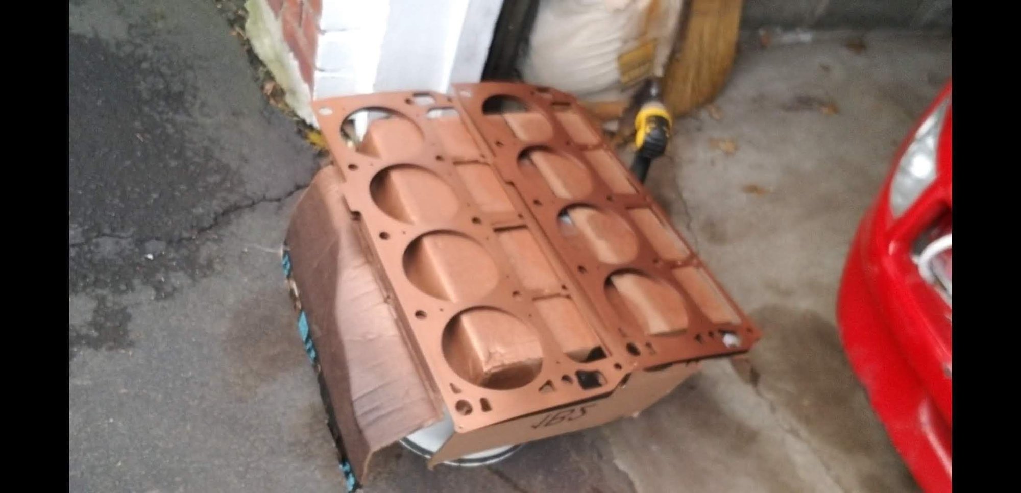

Originally Posted by joes1966
sorry when I see thngs like this I have to ask are you running stock style heads and if so how are you keeping them sealed up so they dont push water
stock 706 heads with btr stage 2 cam kit. Arp head studs. I think I have some aftermarket rocker trunions but not 100%. Have 0 issue with coolant. Ls9 gaskets.
so your using copper coat on the ls 9 gaskets.I had one guy tell me he put copper coat on his as well.I looked at the copper coat but your have those who say not to run it on a mls style gasket.Im just looking into anything that will keep this thing from pushing water.At 21 psi what kind of timing do you have im not sure if im getting to aggressive on timing or not
