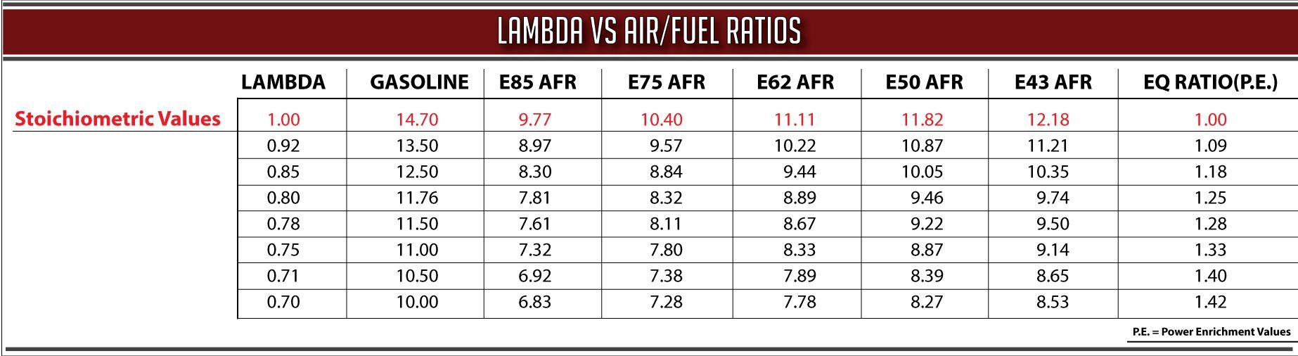

Originally Posted by ChopperDoc
I’ll just say it again as it’s mentioned a bunch of times already. Your AFR is lean as hell for E85. 12.0 is even lean for boosted gas motors. Why aren’t you in the 7’s? That’s where a .78 lambda would be for E85. Last I checked stoic is 9.7 for that fuel.
I’d wager you could get more timing if your fueling was on point for the fuel.
No offense, but you're confused/mistaken and shouldn't be giving advice.
Max power rich on E85 is .86
Max power lean on E85 is .71
The sensor reads lambda and converts to a gas scale on your gauge. It doest care what fuel you run.
If you have a gas scale gauge:
.71 lambda is 10.44 AFR
.86 lambda is 12.64 AFR
So you can literally be anywhere from 10.4 to 12.6 on that gauge and be "ok". What AFR the motor likes will depend on the setup/location.
That makes sense with a gas gauge. Sorry if I misunderstood, was just saying the straight stoich numbers for that fuel are indeed much lower. I didn’t read into this enough to catch the type of gauge. Makes sense with conversion.

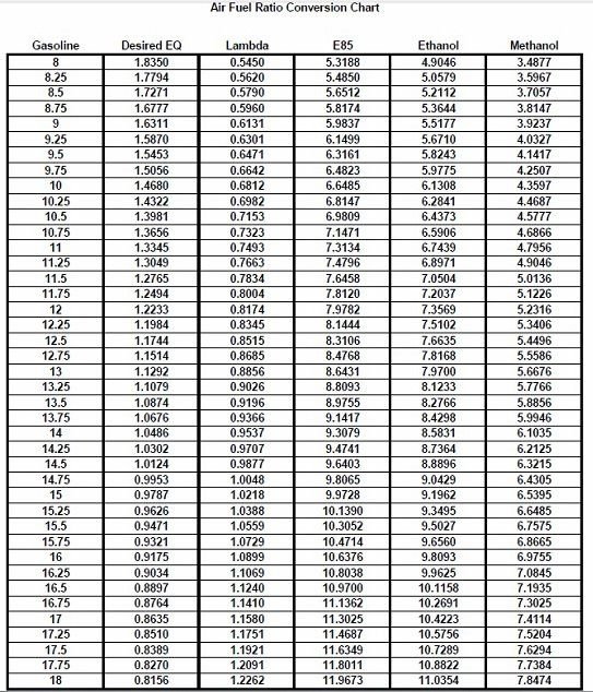

I'm just learning how to tune so AFR has been far easier for me to acclimate to, Lambda is just weird, I know its better though lol.
Its easy when you realize it doesn't matter what you use, just have a chart handy and you can use any scale you want.
Those are very handy charts Slow Sedan, thank you!

When people talk about the wideband AFR readings of ethanol vs gasoline they make it so much harder then they have to and then go on about Lambda and how it's the only way and that just confuses more people.
If you only remember one thing you will have no problems at all... Most widebands are setup to show a gasoline AFR scale and when using that shoot for basically the same numbers that you would on ethanol as you would on gasoline and that goes for whatever mix of ethanol you are running (ie target 14.7 at idle/cruise and 11.5 for WOT or what have you). All O2 sensors read in Lambda and then convert to an AFR using whatever fuel you select but seeing as how the desired Lambda for gasoline and ethanol mixes is basically the same it doesn't matter. Just leave the wideband on the Gasoline AFR selection or put it in Lambda if that makes you feel better but it's the same results and you don't need a chart.
