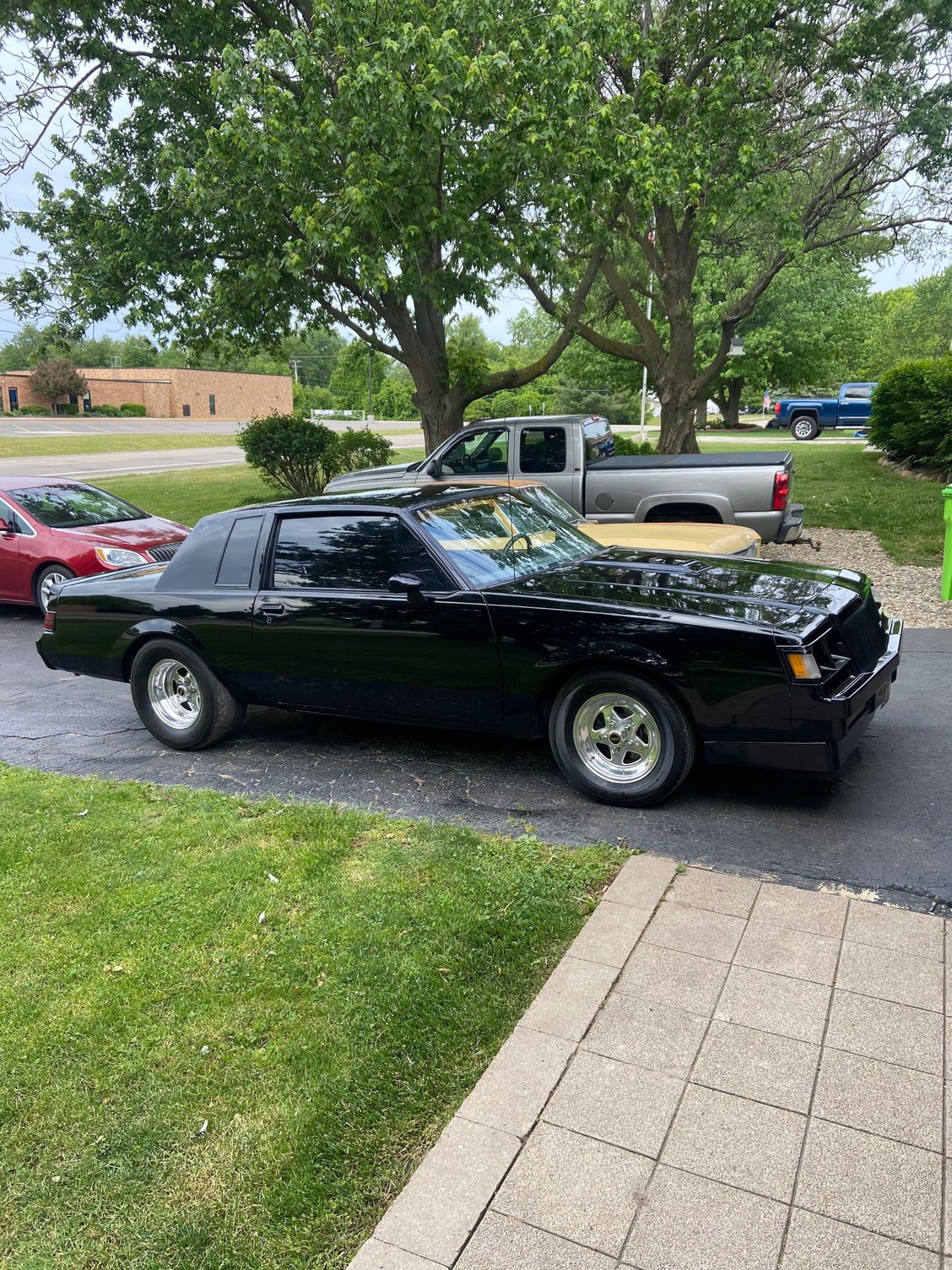

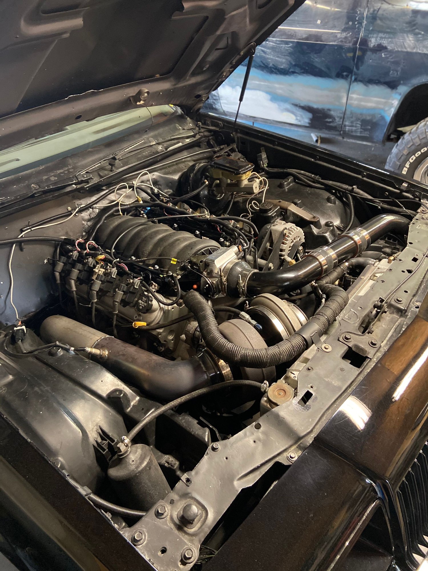

Old Oct 1, 2021 | 06:44 AM
68roadrunner's Avatar
Joined: May 2007
Posts: 369
Likes: 43
Originally Posted by yenkomike
What timing are you guys running on a 5.3 ??im t6 with a treadstone so iat is good 120* max. Running under 16* now at 12.0 afr 18 psi boost . Car is .6 slower than my 6.0 builds at same tune level.
more pics of the car! exterior and engine bay! love it
Old Oct 2, 2021 | 07:26 PM
yenkomike's Avatar
Joined: Aug 2013
Posts: 1,415
Likes: 182
From: oxford mi
Thanks. Will have new pics with new wheels in a couple days.
