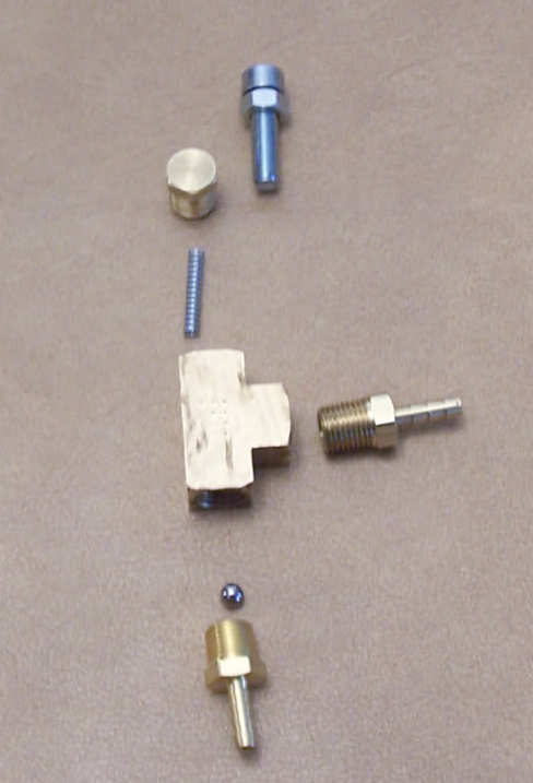

I don't see the need for an EBC when a $15 valve can get you what ever boost is needed for the most part. Spending that much on a BC makes no sense to me. You can buy a micro squirt for $340 and have BC and many other functions. Or save a little and buy a holley terminator ECU or MS3 gold box.
As far as your comment for needing CO2. I don't understand this. What boost ranges are you needing? You can build a setup that will spool just as fast as an EBC mechanically for peanuts. Either use a simple spring/ball setup with a crackign pressure of your desired boost. If you need even more range (smaller WG spring) incorporate a solenoid to the top of the WG as well. The quickest spool you can get will be no signal to the bottom port and all the boost to the top. Realistically most don't need this unless you want to run a REALLY weak WG spring. A typical 8-10lb spring is almost always all that is needed. I can run 8-30lbs with an 8lb spring.
This should improve spool and is adjustable. They work really well. Basically stay seated until your desired pressure is hit. So they keep the WG shut completely until that point.
Def. don't' need co2 for 90% of the setups. That's generally for competition use only.

I'm going to start out with a manual like forcefed86 is describing but I was told they weren't consistent when you approach up around 20 lbs of boost. Not saying that's a fact or anything, just what I was told. I plan on this car seeing a lot of track time now and was just researching for the future. Thanks for the info forcefed, we will be trying this first because this is for sure a budget build. My grand daughter wants to go drag racing again so I'm going to do my best to do so.
Right. Except that a ball and spring setup can even work in competition. NHRA championships have been won with a ball and spring setup.
Def not the case. Though the overall range does depend on the plumbing. With the usual spring that is supplied in the 38-44mm gates I see 8-9lbs with the manifold boost directly to the bottom port. With no signal to the lower port and the top vented It roughly doubles that. I see 8 and 22lbs on my latest twin setup. This will vary a little depending on diaphragm/valve sizes as well as back pressure. Then if you install a bleed style to the top port you can run from 22-30 plus. But I don't run that much boost.
For a cheap street strip setup I usually have a ball valve on the lower port and a bleeder on the top. I close the ball valve at the track and add a tiny bit of pressure on top to get my usual 25ish lbs. Goes from a low 10 sec car on the street to a high 8 sec car at the track with those 2 settings.
Now I typically use a 3 port mac valve and the EBC that's built into the aftermarket ECU's. (no CO2) This allows fun stuff like boost by speed/gear etc. Still have a range of 8-30+.
