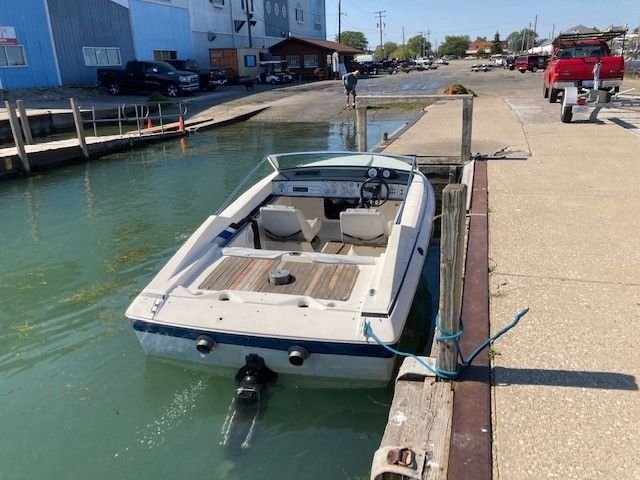

Not a big deal on the replies, I can learn as I go, just thought I'd ask. Yes, it is a 1984 16.5' Formula I/O, closed bow. Came stock with a MerCruiser 4 barrel 4.3L V6 and Alpha drive, did 51mph. I replaced the great running 4.3L with a mild 350 (5.7L) SBC Vortec build, got to 67mph, ran that for 15 years, it is now tired. Switching to 6.2L LS build with LSA blower, and likely pump E85 since I trailer it and E85 is available everywhere here. Seems blowers really like it, adds +40hp-50hp due to the evap cooling, but largest for me is a huge safety margin for tuning. Bought a used Bravo drive, so will be switching engine and drive at same time. Hoping for 70mph. Yes, target approx 750'ish hp. There is much more LS build experience here than on any boat forum. I run it about 10hrs per weekend all MI summer. 90% cruising RPM, 10% WOT.
I did also pick up an Ilmor 522hp LSX 454 engine, but not going to use it due to the weight of the cast iron block and cast iron exhaust manifolds. In that short of a boat, I'm really trying to keep the weight out. That motor does have a beautiful rotating assembly though. All non-Chinese forged, H beam, from the factory with warranty. Pretty slick.
Guy and kids are neighbors out with us that day.
