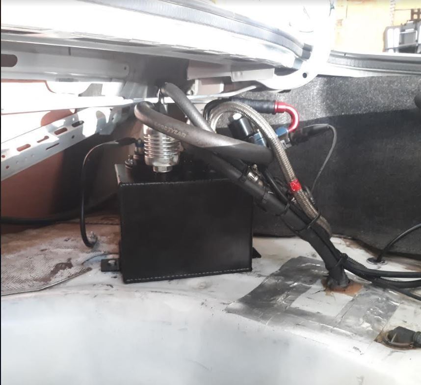

My tank has a sump from years ago when it was carbureted. I run a -12 from the sump and gravity feed a surge tank (located in front of the fuel tank/behind the rear end) that has twin AEM 380s in it. I think there labeled as 400s now. A -8 comes off each pump to a massive spin on fuel filter housing then a -10 comes off the filter housing and goes up front. One pump runs until I’m in boost then the other kicks on. F2i regulator and I can’t even tell when the second pump kicks on.

On my Silverado, I've been using the stock pump teed into a Walbro 450 in a surge tank for ~18 months, works great.

I used the factory 90's 5.0 fuel pump as my lift pump. Came with the new fuel tank. Been working great with E85 for several years now. (though I usually blend it down around 60-70%)
I use -6 to filtered feed with the E85 sensor inline to the surge and return back to the OEM tank with a -6 as well. I run the regulator at the surge tank. Then the 2 AEM 380s plumb to the regulator with a -8 single line dead headed to the factory rail up front. Id suggest running them staged. Mine def get warmer than I'd like on long cruises. Bit of a mess but it works!
