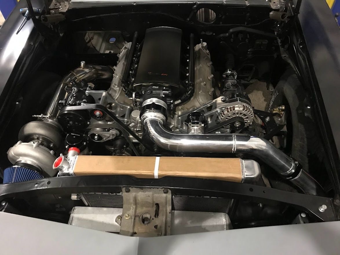

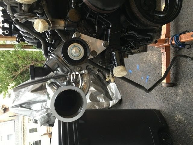

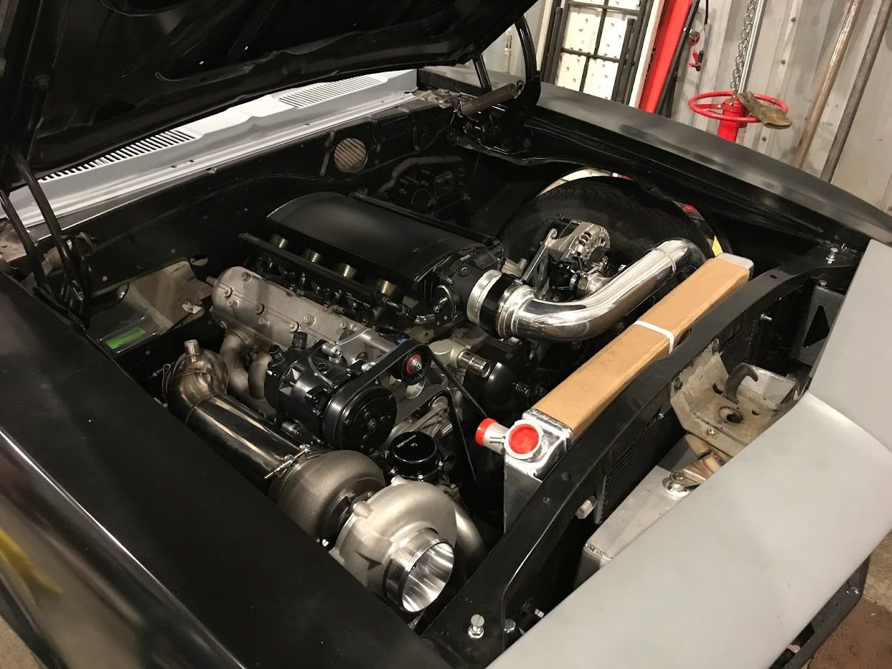

I did a kit on a 68 camaro, hooker turbo manifolds & ict billet ac setup, vs7875 turbo with 4" downpipe. Fit pretty well, may give you an idea.

Sorry for the confusion SwapStang, I only mentioned the Hooker Manifolds as that is the only one that Holley stated the Mid-mount kit would clear.
I’m continuously checking the junkyards here in TN, but it seems as they are often robbed of everything, even the truck accessories. I’m not opposed to spending a little cash on AC Delco components and new brackets, just not $2k worth..

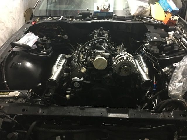

I’m not 100% sure on the power steering interference as there is a user on here with a Chevelle that mounted the speed engineering with what looked like stock truck accessories and it was CLOSE.
I also think you can run the speed engineering up and forward or down and forward from some of the threads I’ve read, but I’m not sure.
Spray280, that setup looks great! Thank you for sharing the pic and info, it definitely gives me a better idea of the ICT setup and location of components.

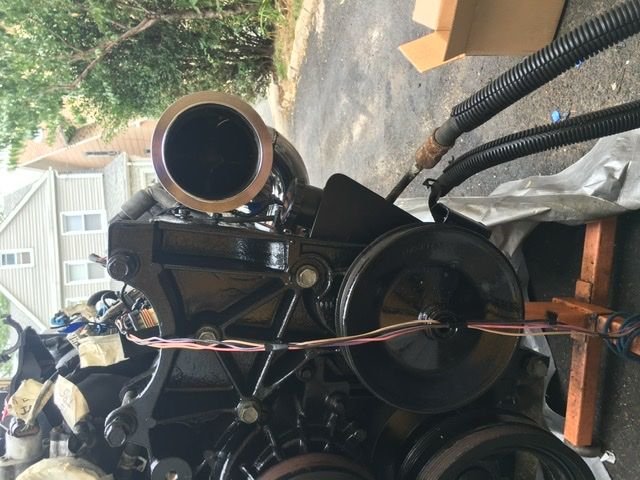

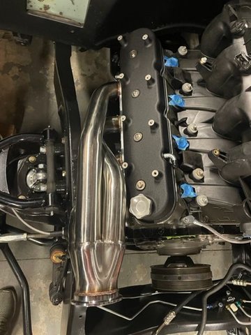

In a mock-up with eBay up and forward cleared the stock truck accessories, alt, PS etc. I didnt mock up anything with AC either but ICT makes a stock truck bracket. I never ran these headers but I did mock them up for a hot sec.

customblackbird, thanks for the photo, good to know it clears the ps pump in the up and forward. But it also looks like it would interfere with the ps pump in the down and forward. With all of the photos posted, I have gotten a better idea on the amount of room I should have. As far as A/C goes, the stock truck location wont clear the frame rails on the C10 (based on what I have read). Dirty Dingo makes a bracket that allows me to run lower A/C position and fit inside the frame, but I have the same issue that I do not know if it will clear the Speed Engineering manifolds. ICT does suggest the A/C bracket like spray280 put on his for my C10, but they were unsure if it would clear the turbo manifold as well.

if your planning to run down and forward you can’t run anything near the middle/bottom of the block. I tried flipping them as well and it hit a few things. Down and forward would prob hit a low mount anything (alternator or AC) so I don’t think that would work for you. Sounds like you need a high mount AC and an S10 should have lots of height above (clearance to hood).

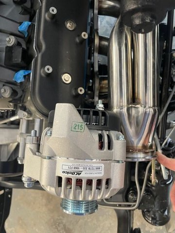

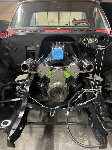

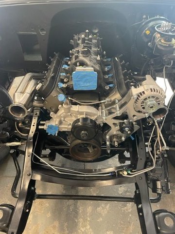

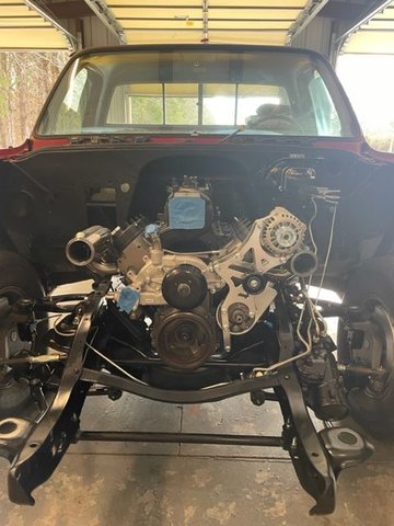

I wanted to provide a little update after installing the motor and trans and mocking up the Speed Engineering turbo headers with my setup. Components that I am currently running that would have some effect on the clearance are -- 317 heads, Granatelli Motorsport Valve Covers with integrated coil mounts, and Dirty Dingo slider mounts. I have not mounted any of the front accessories at the moment, but will soon get those mocked up at the least to find any other issues. The turbo manifolds are in the "up and forward position" due to the fact that the "down and forward" had interference with the manifolds and frame. Almost all of the coil packs are impossible to mount due to interference with the coil packs and manifolds. I've attached some photos for reference.

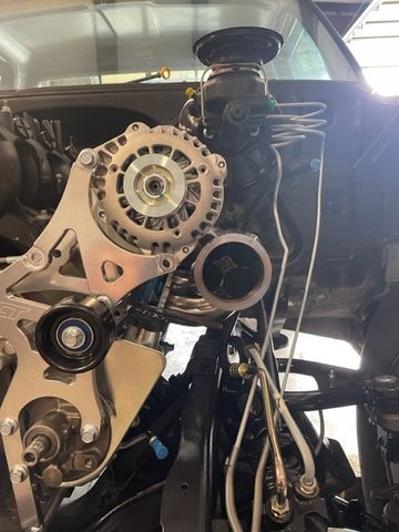

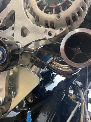

Update #2...
After mounting the power steering and alternator with the ICT bracket 551519x-3, I had some more fitment issues with the driver side turbo manifold. Once all was in place, the manifold flange was about 1.5-1.65" from being flush on the block with all of the interference in the alternator. To clear this issue, I need the alternator to move inward toward the intake about 1.75". I am going to search ICT billet for another bracket and also attempt to find some stock brackets in the yards around here to see what might work.
