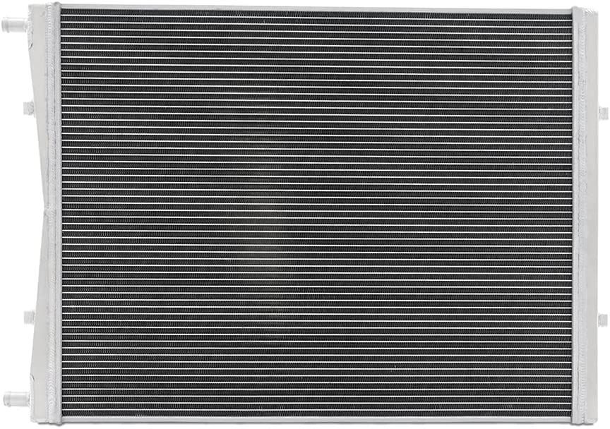

I'm going to be using this Mishimoto dual pass heat exchanger for my supercharger and it has both the hose fittings on one side, top and bottom... Which direction would I route the coolant? Hot coolant going in at top and out the bottom or opposite? This setup has a 5 gallon trunk tank and high flow pump as well...

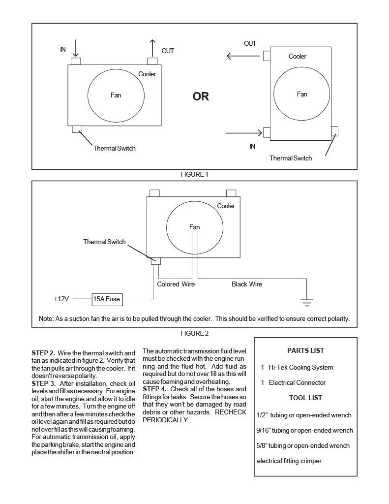

Here are instructions for a B&M transmission cooler. The outlet is up or at the top so air can get out of the cooler.

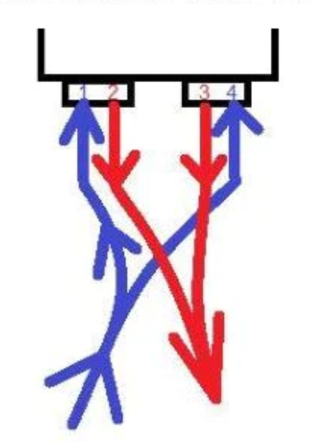

Ok guys I'm getting ready to put the cooling system together. The pic shows how my blower lid aka cooling bricks are routed for cooling. So the hot coming out (red) would go to the bottom of the heat exchanger? I'm guessing the top of the heat exchanger would go to the tank and then the tank outlet goes to the cooling bricks inlet (blue)?
