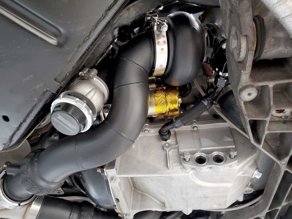

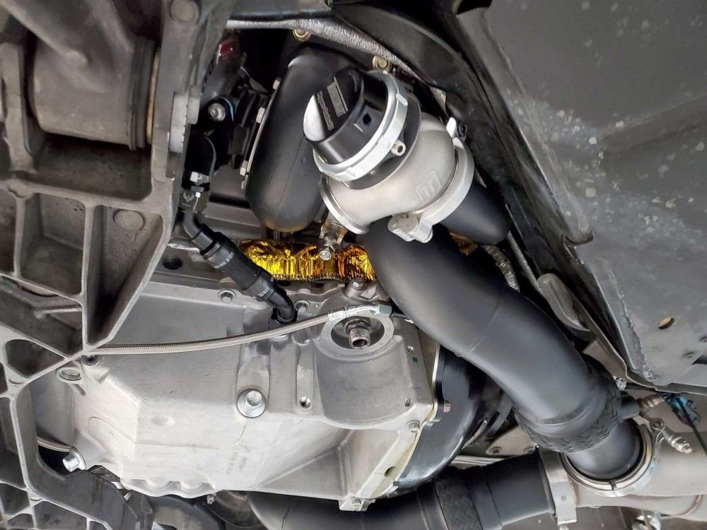

So you are trying to package this into a C6 Z06? Are you sticking them out of the hood? Trying to mount them low? Exhaust out the rear? The packaging in the C6 Z06 is going to be your big hurdle and turbo sizing will be highly dependent on what you are trying to do with it. Technically I should be running larger turbos on mine BUT I already had to cut, grind, and modify a ton of **** just to put 6870s down low so I could keep exhaust going out to the rear and not have them sticking out of the hood.
NicD, do you have any pics of yours anywhere? Just curious. Love seeing how guys do the vettes. I've seen some guys pull the fenders and put them in there, seems crazy.

I only have a couple from when it was under construction still, I really don't think you can fit anything larger in this location and putting them in the fenders doesn't really buy you any more space and then I would have had to get rid of my dry sump tank which was a no go.

OK so for the stealth look you are pretty much stuck to having them where I put them or putting them in the fenders but then you lose your dry sump tank, assuming you have a C6 Z06. Space constraint is going to be your biggest obstacle and biggest limiting factor for turbo sizing and it will be a compromise and you MUST pay close attention to heat mitigation as well.
