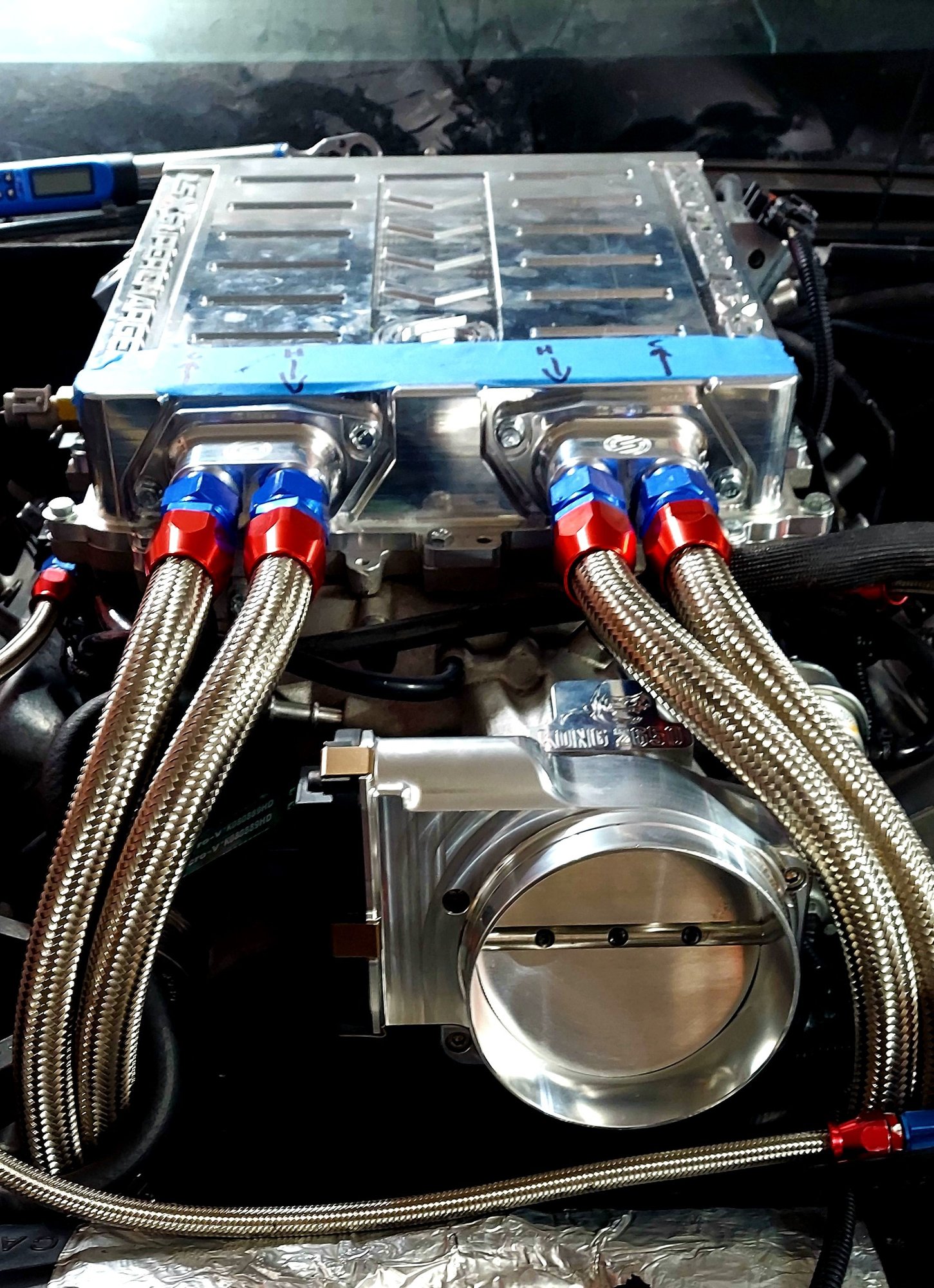

momo do you have any pictures you post of the kong 2650 installed? Would love to see that!
As you may know I am currently running an LSA on a forged 408. If I ever win the powerball that I don't play I am hoping to go to a kong 2650 if I can use my Olson modified LSA snout on the Kong?

Hey Mr. Black! Yeah its not fully done but here's a pic of how it looks. I'm still figuring out the tensioner offset, etc.
