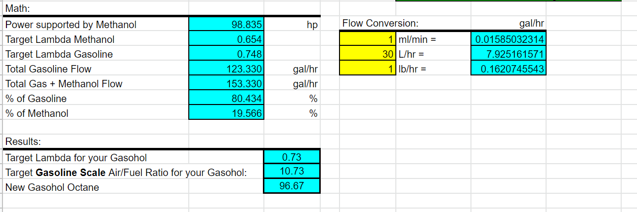

Originally Posted by Purple Poncho
I also use it to calculate my equivalent octane. Since the topic was meth vs race gas you could see where you are. Not that pump gas and meth is the exact same thing as running just race gas but that is a different topic.
Plug in you "inputs" and see what you are working with.
This is not my work BTW. All credit goes to MightyMouse.
So if I did this right, if I'm using pure methanol and spraying with two 15 gal/hr nozzles I get a target gasohol lambda of .72 and a total octane of 98.09 for a 1,200hp application?
So figure 20% in drive train losses through the TH400 would put me at 1000whp.
Does it also make sense that if 25% of the fuel used is methanol that my injectors will go farther as well?
Lastly where is a good place to buy methanol by the pail, I'm looking and there seems to be different kinds for different purposes?

Have any local circle tracks? M1 is the preferred fuel for most of the dirt track stuff here. I get it at my local dirt track supply store. If you were in a pickle you can run yellow HEET bottles. Its basically 100% meth. OR order a 5gal pale from any race fuel vendor.
And yes... if you add X% of fuel your injectors will go that much farther. 25% is a lot. Maybe I missed something... 25% of say 800hp is 200hp.
One gallon of methanol weighs 6.3 lbs. Meth has a BSFC of 2, so equates to .0053 GPM.
Multiply .0053 into the amount of HP you are making and you will get the approximate GPM required. Multiply by 60 for gph? So... 63.6 GPH is required to supplement 200HP worth of AUX injection. 31.8GPH for 100 HP.

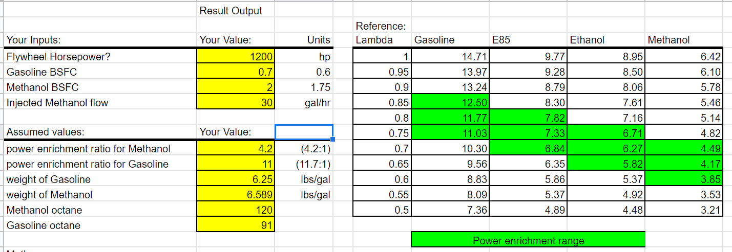

All I did was input the desired flywheel horsepower, injected methanol flow and gasoline octane and that's what it spit out.
Even if I change the gasoline BSFC to .55 it doesn't change it a ton.
What did I miss?

Believe that spreadsheet is just used to calculate the AFR you should shoot for on the gauge when you are mixing 2 fuels with extremely different peak power AFR’s.
The BSFC of methanol is an average of 2.0. Which means you need to flow 2 lbs per hour for each one horsepower made.
One gallon of methanol weighs 6.3 lbs so a BSFC of 2 equates to .0053 GPM.
Multiply .0053 into the amount of HP you are making. This gives you the approximate GPM required. Multiply by 60 to get the GPH.
Nozzles are rated in GPH. An M15 is 15GPH @ 100psi. You need 4 M15’s to supplement 200hp worth of fuel with 100% methanol. Also… the pumps supplied likely won’t be able to pump 60GPH at 100psi. Also have to remember if you don’t spray pre-turbo you are fighting boost pressure. So if you run 20lbs of boost the pump has to overcome that and flows even less.
Now I’m not saying you need that much. I’d go with the amount Julio suggests. If he states 2 M15’s, you are replacing roughly 100hp. OR 12.5%. Kinda like tunning E10 fuel…. Or “M12”.
