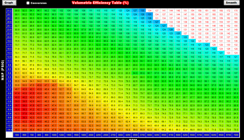

I just unboxed my ProMeth Direct injection kit. all of it looks super quality. the pump is heavy as sin.
Old Aug 18, 2023 | 04:54 AM
  #63
Gumby83's Avatar
Joined: Feb 2016
Posts: 120
Likes: 12
I'm sorry, I'm an idiot, they go all the way up to 10 gph nozzles.
So I could do direct injection w/ 4-6 gph nozzles, the PM190 pump at 220 psi, minus 25 lbs. of boost pressure so 195-ish psi system operating pressure.
That would provide approximately 250-300hp of additional head room at minimum, maybe more since the system pressure is almost double.
If I had to guess, right now on pump fuel at 14 lbs. its probably making about 850-900 crank horsepower so with meth I'd be in the 1100-1200hp range which is right where I want to end up.
Does this sound about right?
Running race gas was my initial plan until the price skyrocketed, a drum of C16 is almost $1,400 so I'd rather spend that on a meth system and get more use out if it.
This car drinks fuel, I made 4-5 full pulls on the street and used almost 1/2 tank of fuel so figure a day of racing would easily cost me over $250 in fuel at minimum.
The aftermarket ECU conversation is a whole different can of worms, its something I'd love to do for all the reasons you mentioned but I have no clue where to start or what I'd need.
That is a **** tonne of meth. rodney set me up with a 2.5gph nozzle kit with a 9th 6gph injector. I'd talk to him, my goals were a bit more modest, but same idea as you. using it as a octane booster and for me its a bit of a band aid for my fuel system in general. I have a 130GPH inline pump and FIC775 injectors, which will hit their limit around 15psi according to the holley software. I was hoping for 650whp at 10-12 psi. then bandaid the fuel system and octane to 850whp at maybe 20psi. I am still wondering where exactly i am going to put that 9th nozzle, reading this thread has me nervous about putting it before the BOV.
