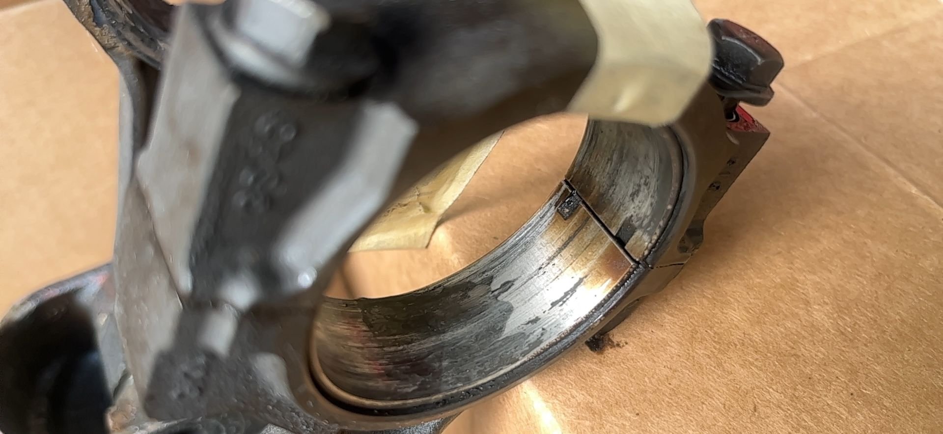

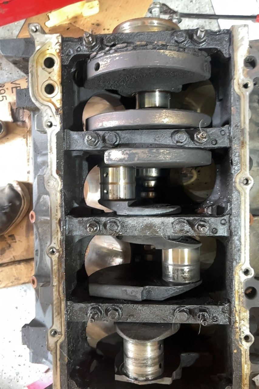

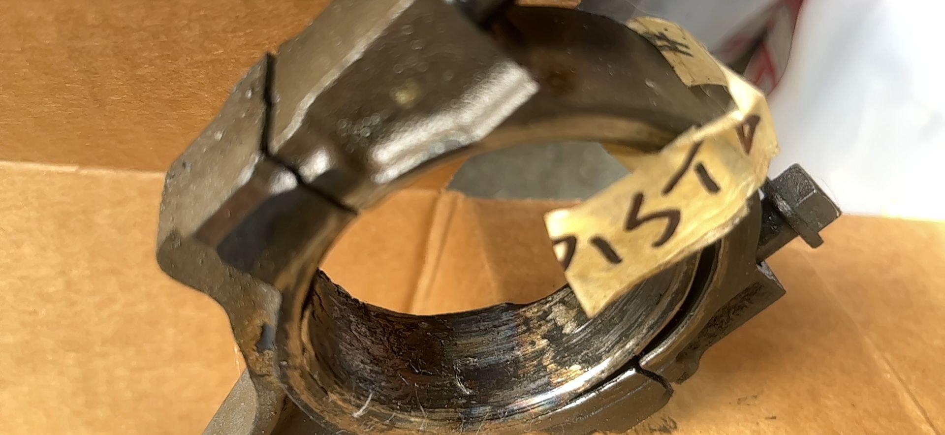

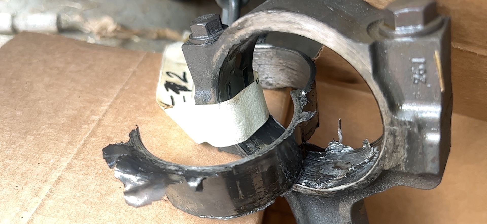

so the milage is unknown but there is obvious damage to the crank, i don’t know if it can be saved but if it can i’m willing to reuse mine

Dang, that looks bad. Did any of the main bearings spin on the journals? If so, may be better to start with another better block.
Seems like crankshaft is pretty rough also.

Looks like you’re gonna end up getting into it pretty good. Do yourself a favor and clean everything really good while it’s apart. All the carbon from the ring lands, oil gallies, try and get it spotless. It’s obvious that that engine hasn’t been taken care of.
