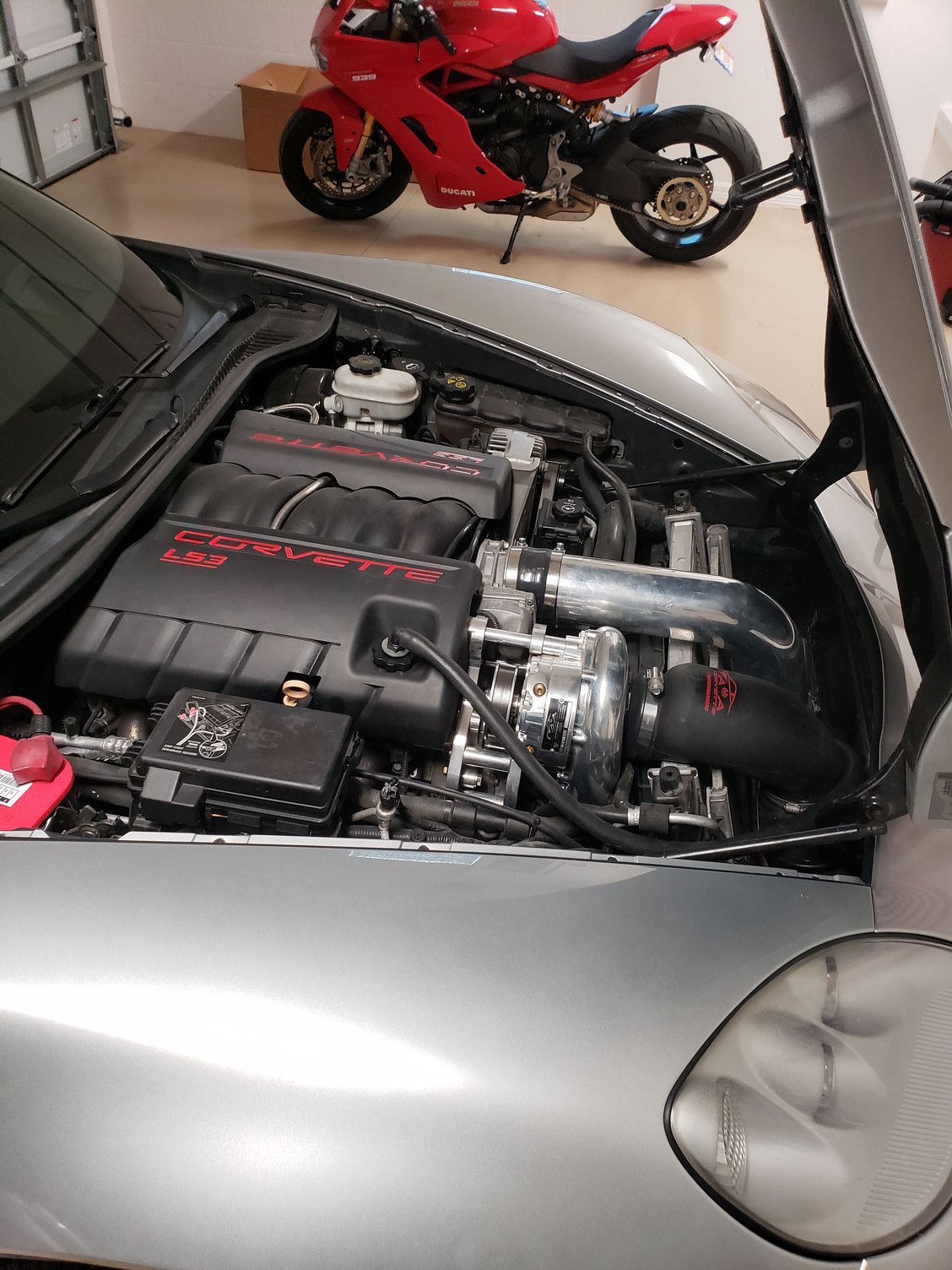

I have a 2013 A&A supercharged Corvette with a cam, long tube headers, x pipe (no cats) into tiny Flowmaster 10's (the tiny bastards) and want a better sound.

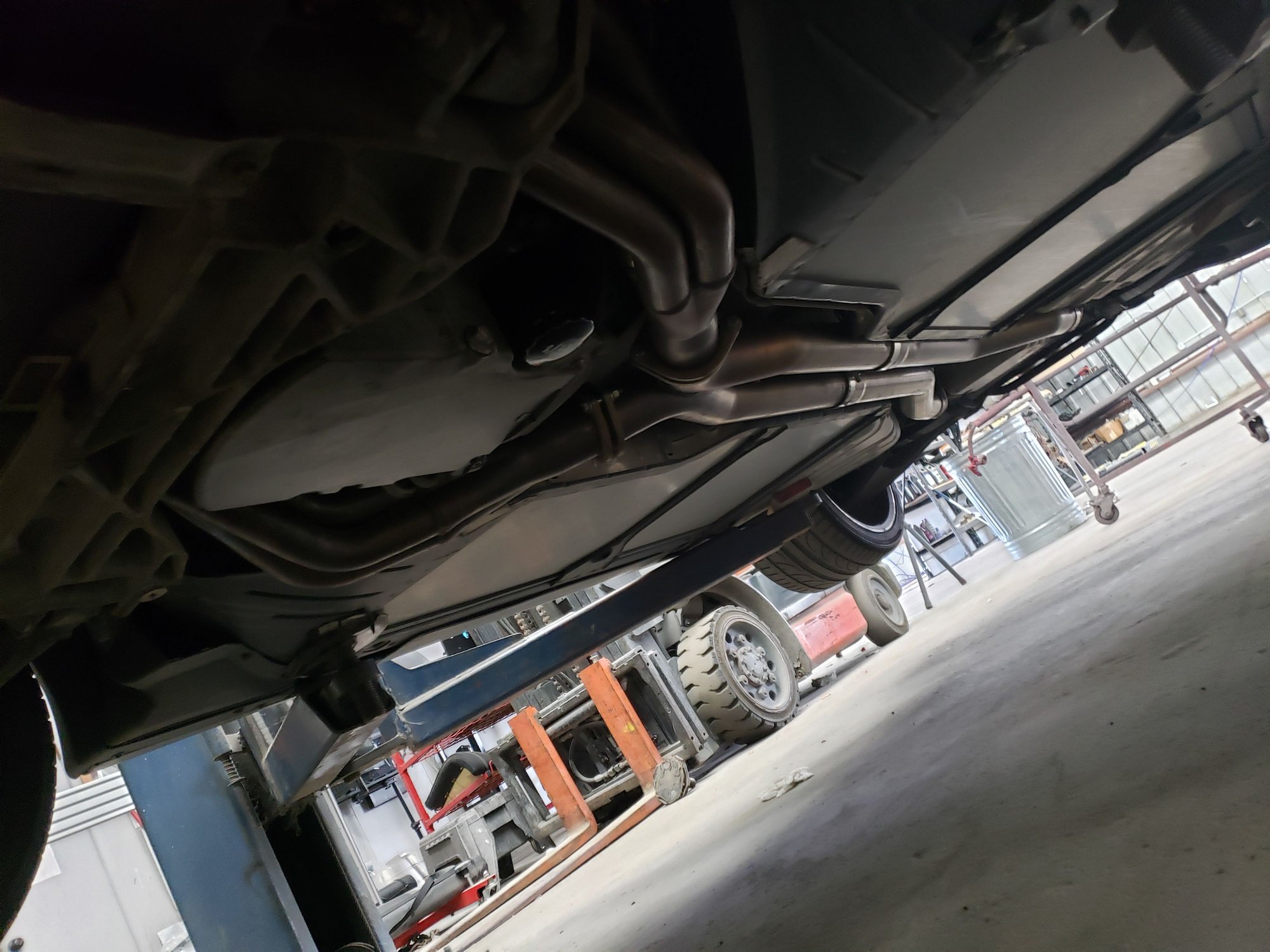

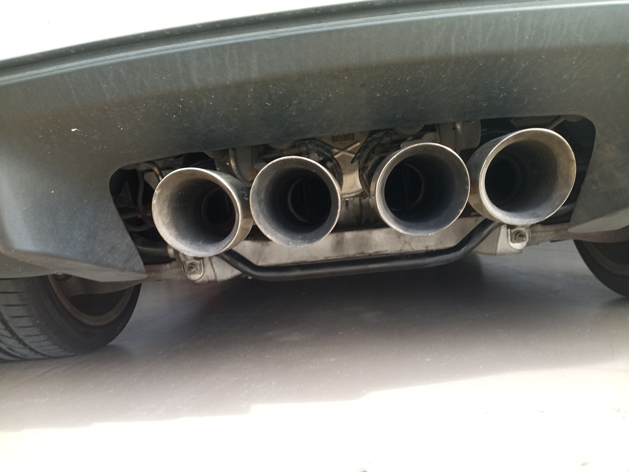

I have spent a lot of $ on American Racing long tube headers and their X-pipe... I brought all 4 exhaust tips closer like a C7 and I don't want to lose that... am willing to get "zoomies" or electronic cut outs, but would rather get some nice mufflers. Please advise as I don't want to cut too much into the AR system.
I don't want the AR all cut up with resonators, just better sounding mufflers.
