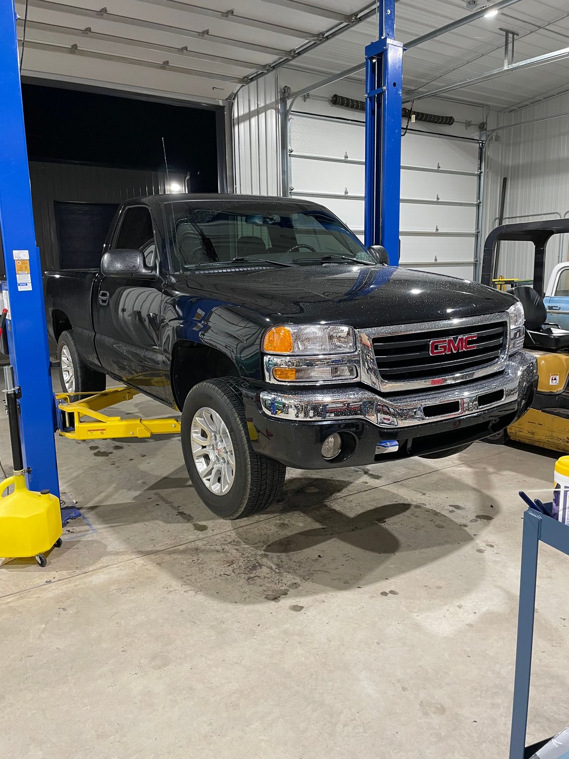

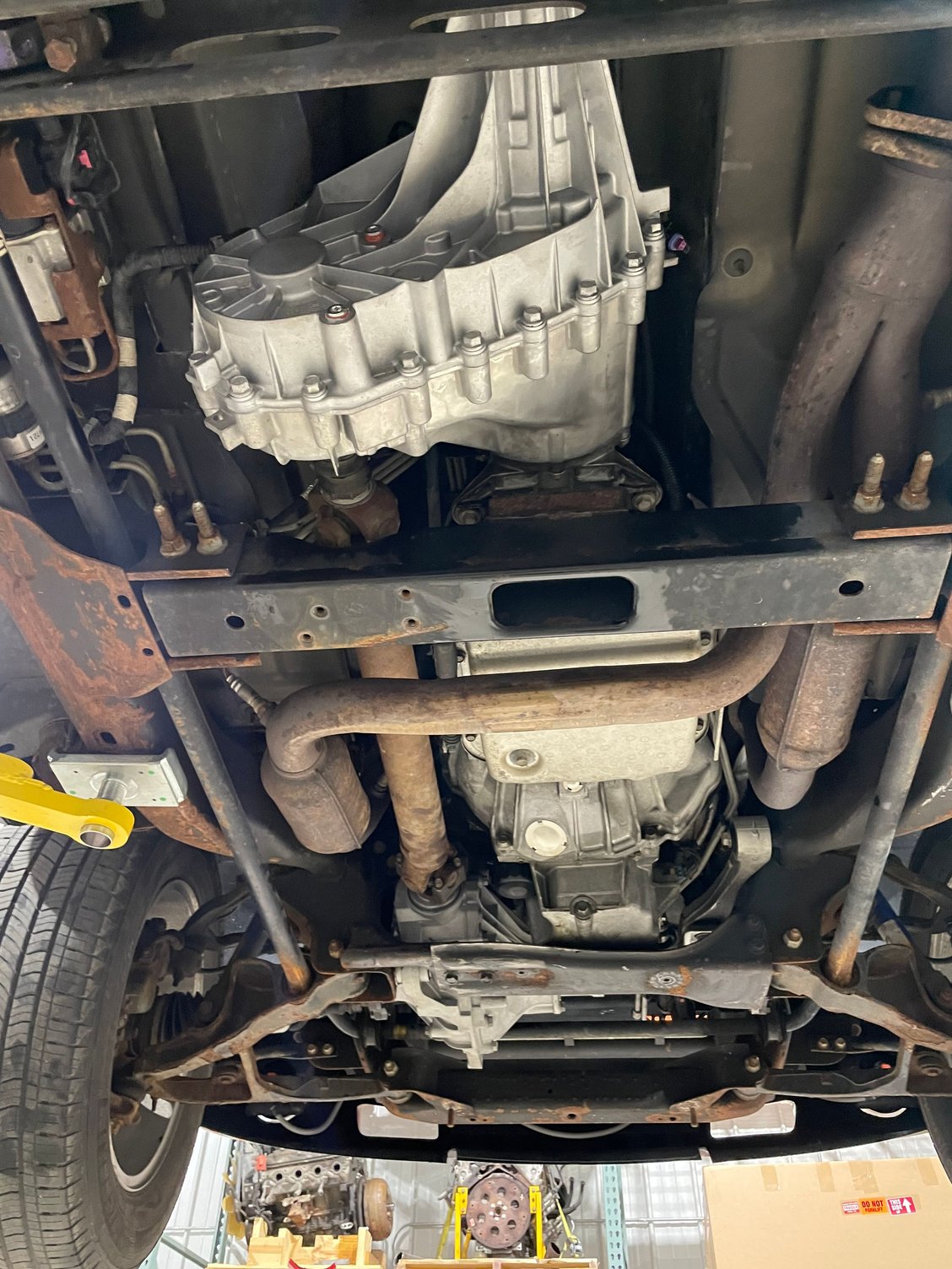

I wanted to create a thread for this truck. It’s a very simple truck and is a lot of fun on the street.

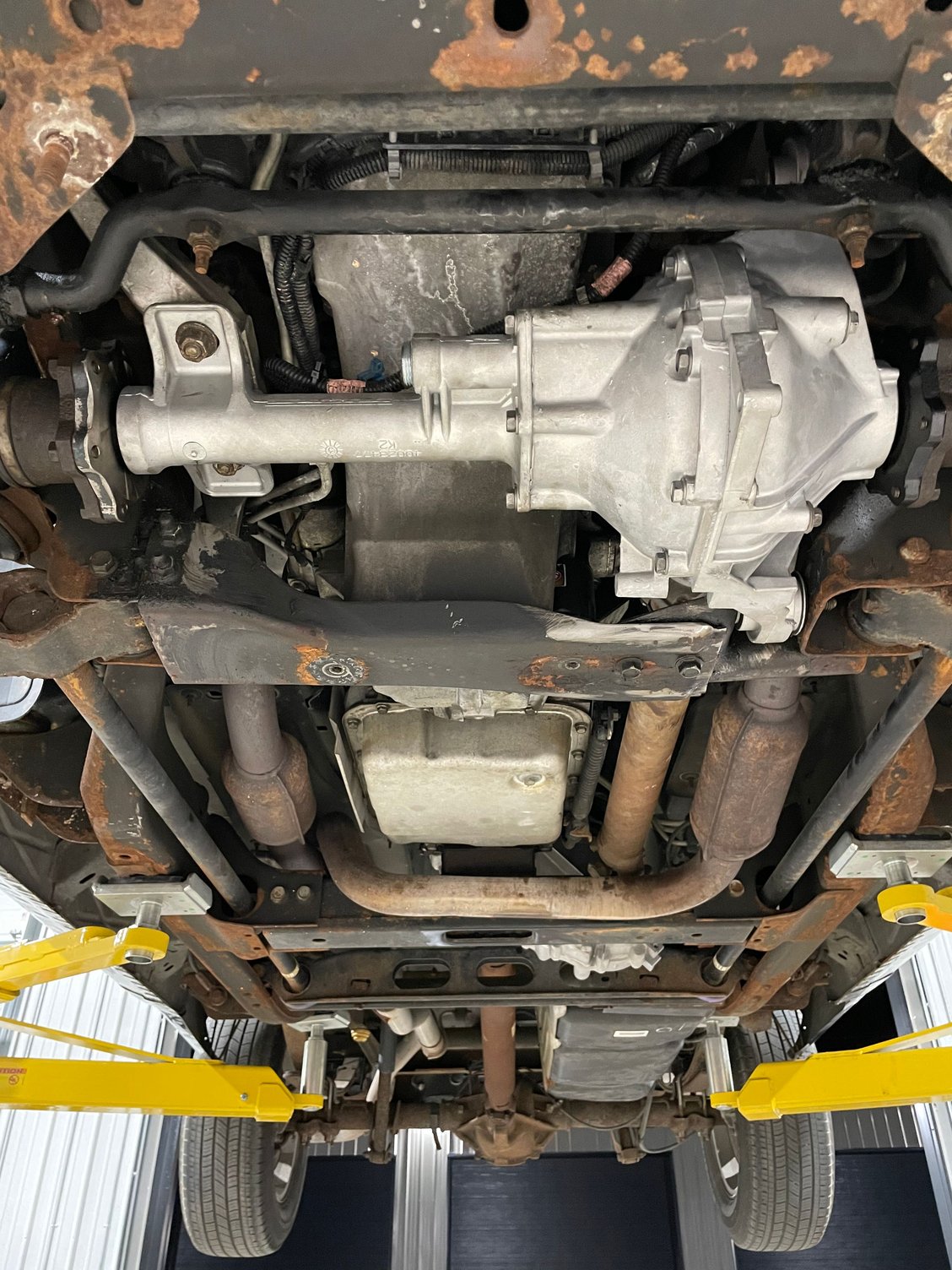

My goal for this truck was to create a fullsize Syclone if GM had made one in modern times. I wanted a NBS truck like a Silverado SS, but it always bugged me that they were no RCSB. I found this one in TX with 70k miles. It’s a 4.8 which I wanted as the Syclone was 4.3 albeit V6.
NP149 tcase
Stainless exhaust
AWD dyno
Silverado SS front diff
More to follow.

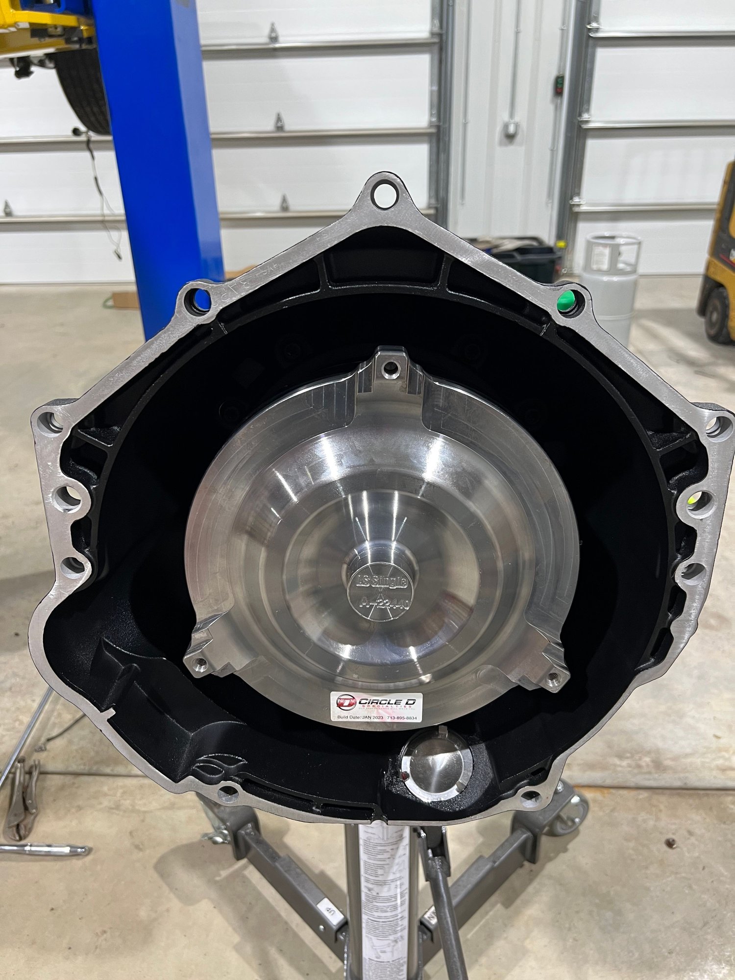

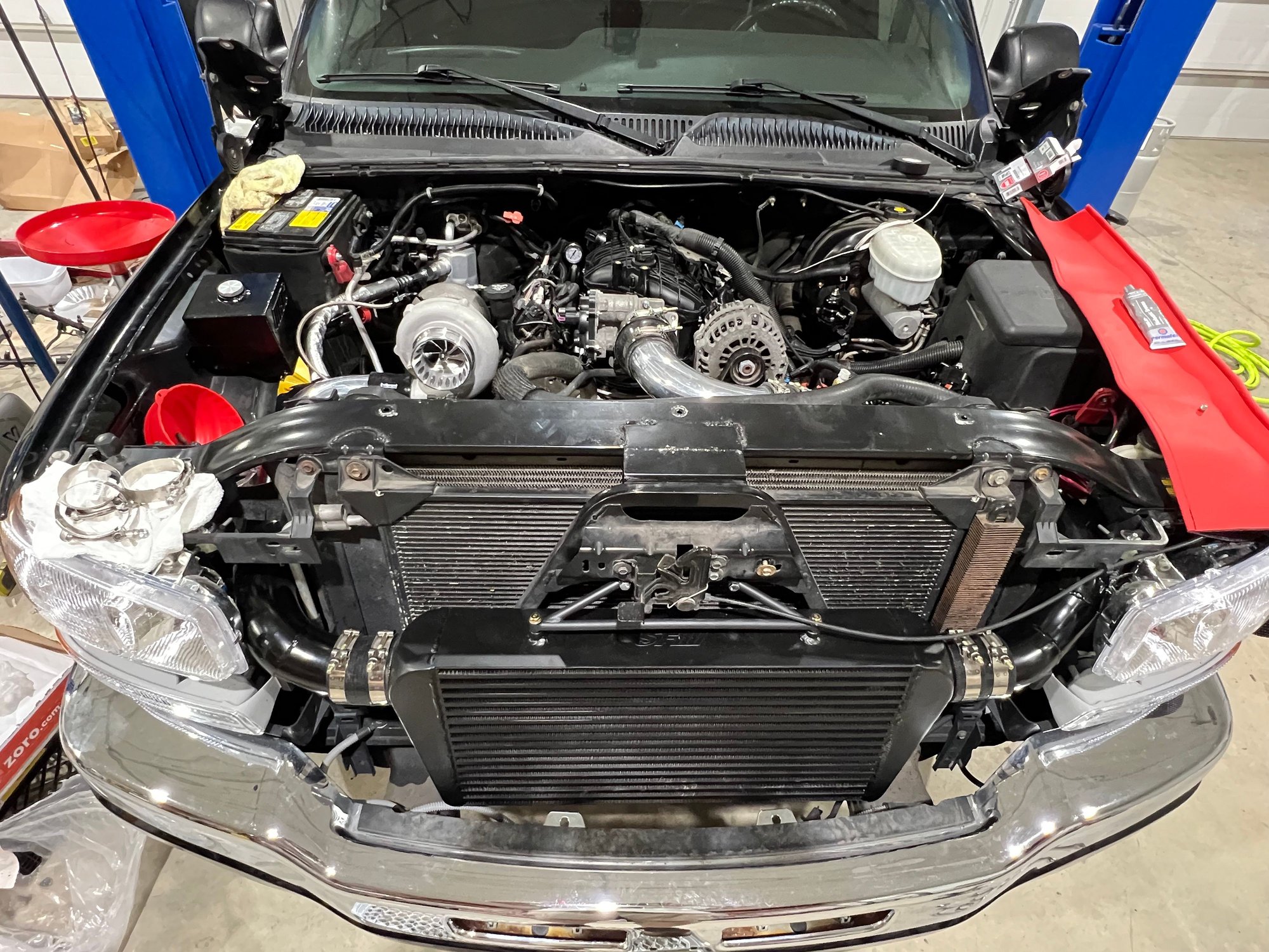

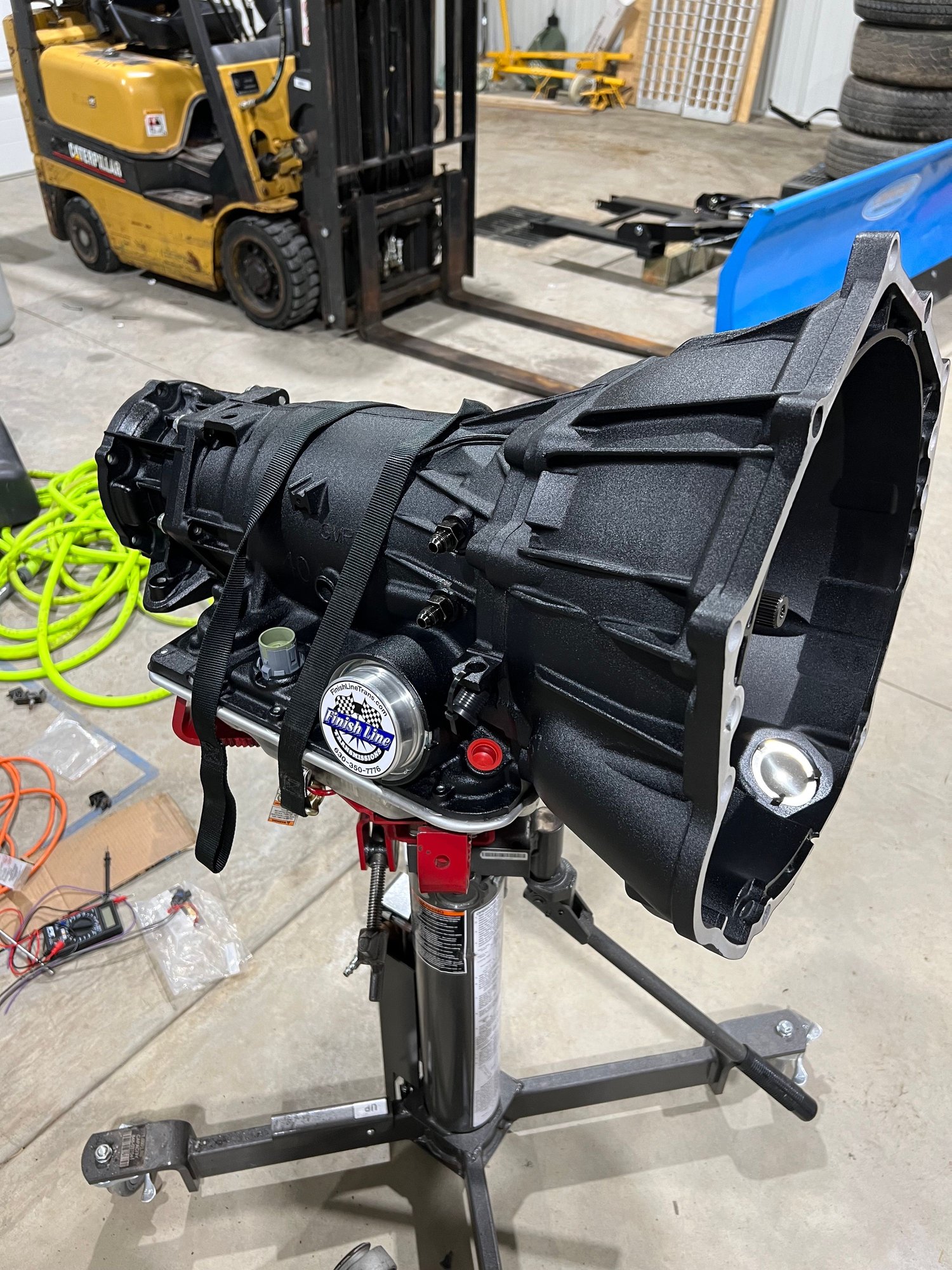

Sorry to keep you hanging. I had to convert some photos to work with the site.

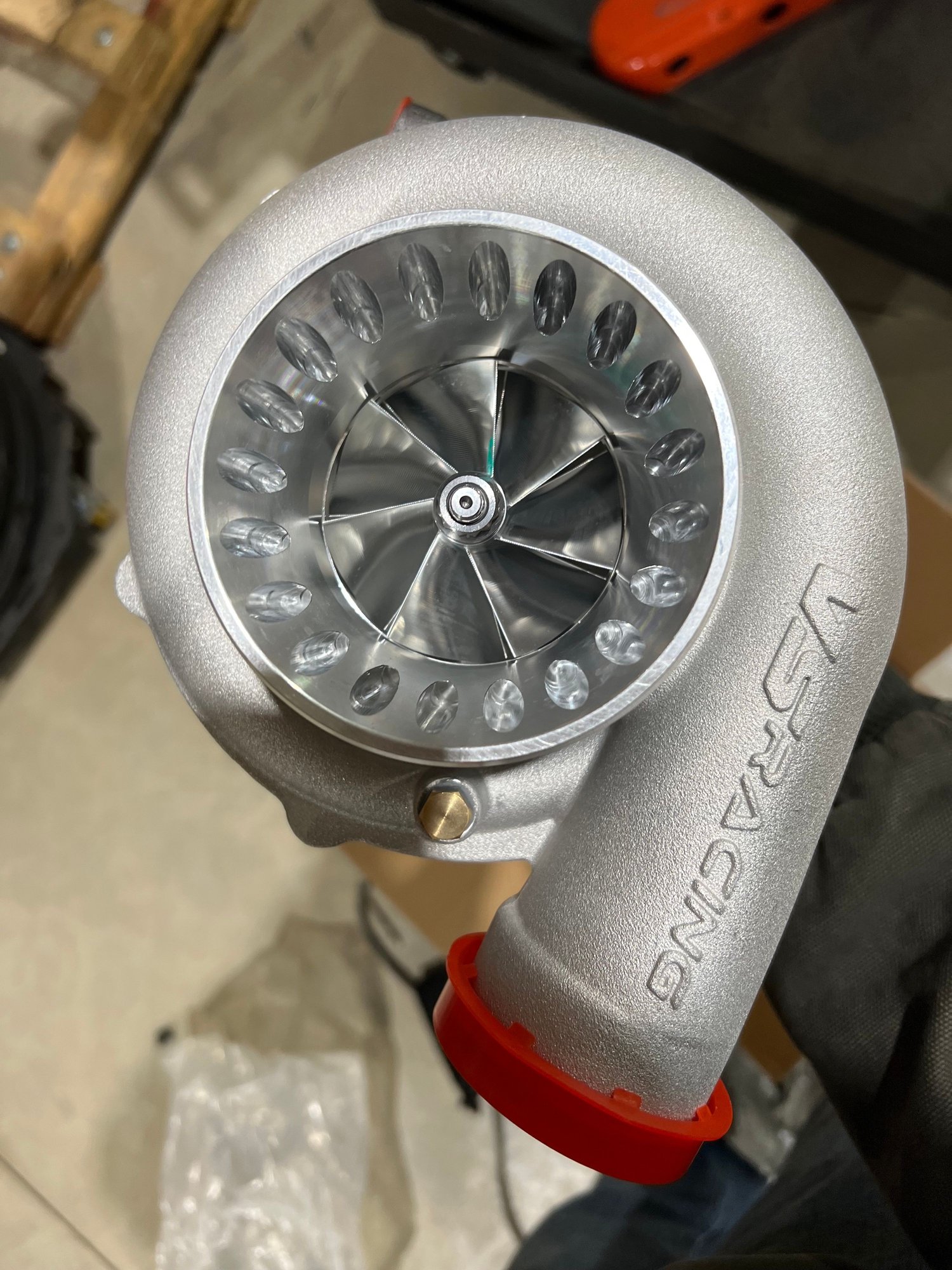

VSR 70/70 .96
FLT built 4L65
Circle D 3000 stall
Huron Speed V4 kit
FUEL - 1000 cc FIC from Huron. 2 hellcat pumps in the Huron hanger. -8 and -6 lines to Flexfuel to TBSS intake and fasster rails using fasster fittings and fpr and RH lines left from another project.
POWERTRAIN - 4.8, 862 heads, stock everything except for tbss intake. FLT stage 6 or something trans. Huron trucool trans cooler. Circle D converter, 3000 stall. NP149 reman. Upgraded front and read shafts. Stock open rear for now.

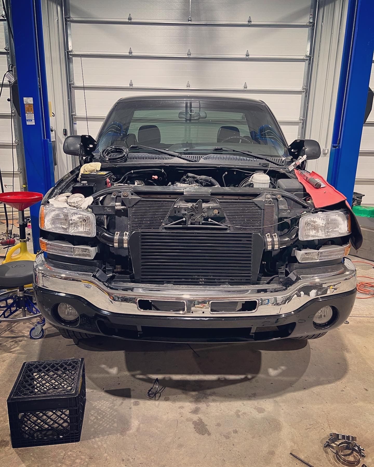

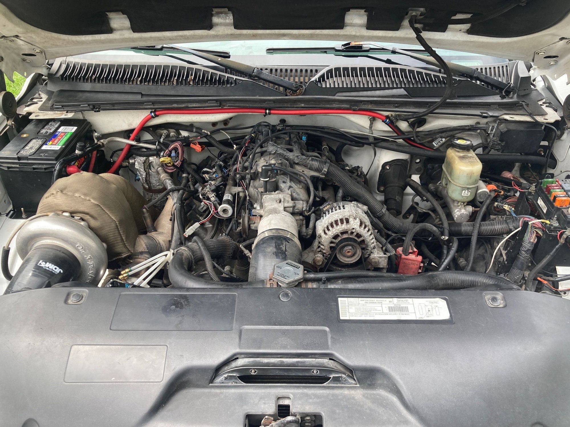

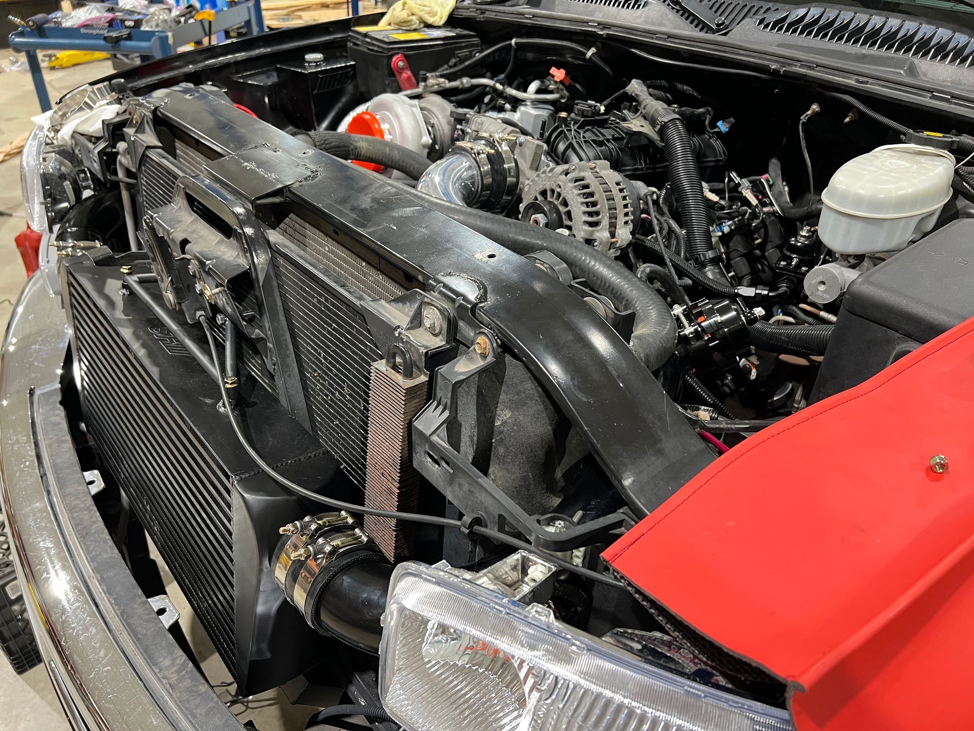

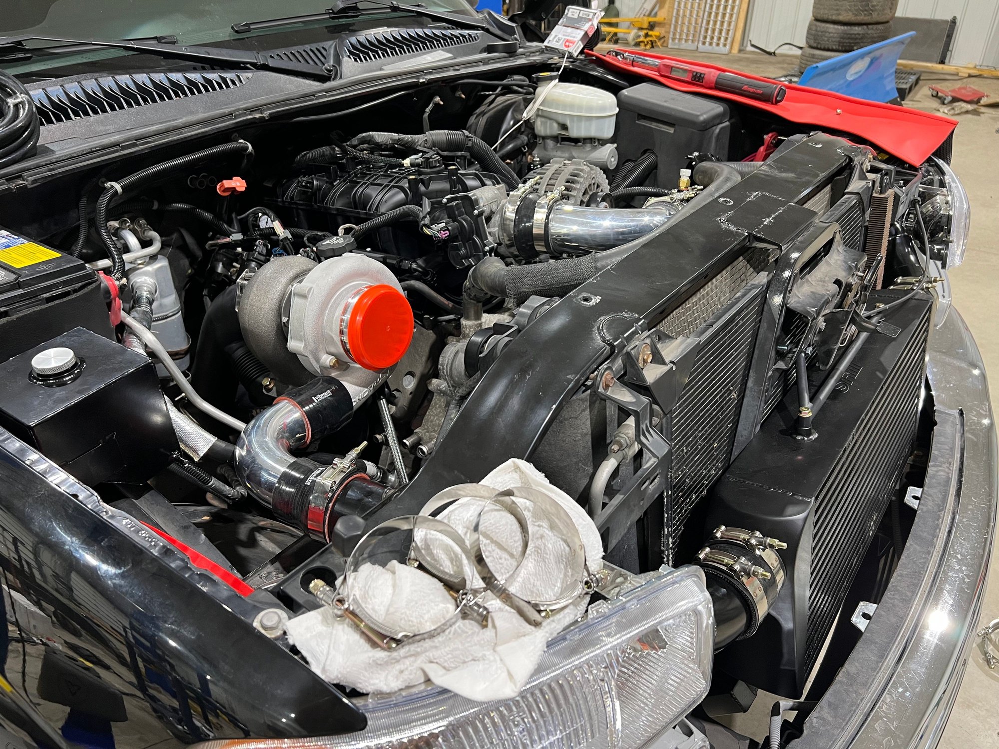

Huron speed V4 kit with intercooler. VSR 70/70 .96 turbo. Precision gate and bov. Had to have a few pipes remade. Speed density tune. Stock P59 ecm with HPT. Fully tuned for flex.
NNBS fan upgrade
Innovate Motorsports ethanol/boost/afr gauge
Newest Silverado brake upgrade
Atomic Fab front coilover install (removed keys and torsion bars)
Slightly dropped with basic Belltech bs.

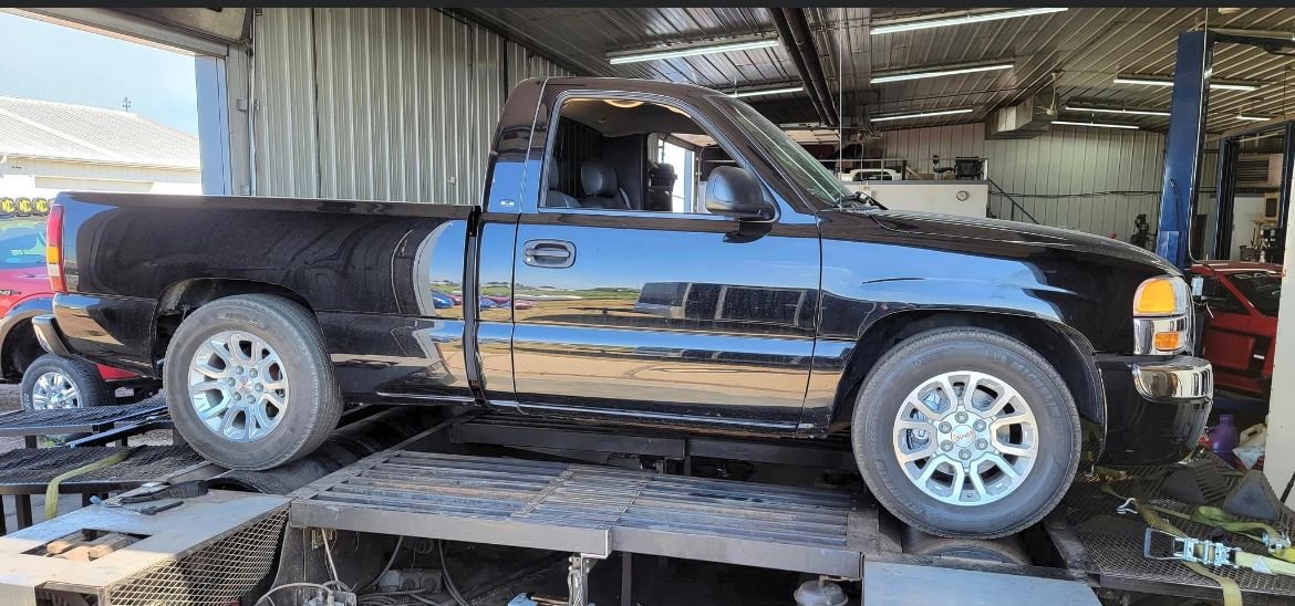

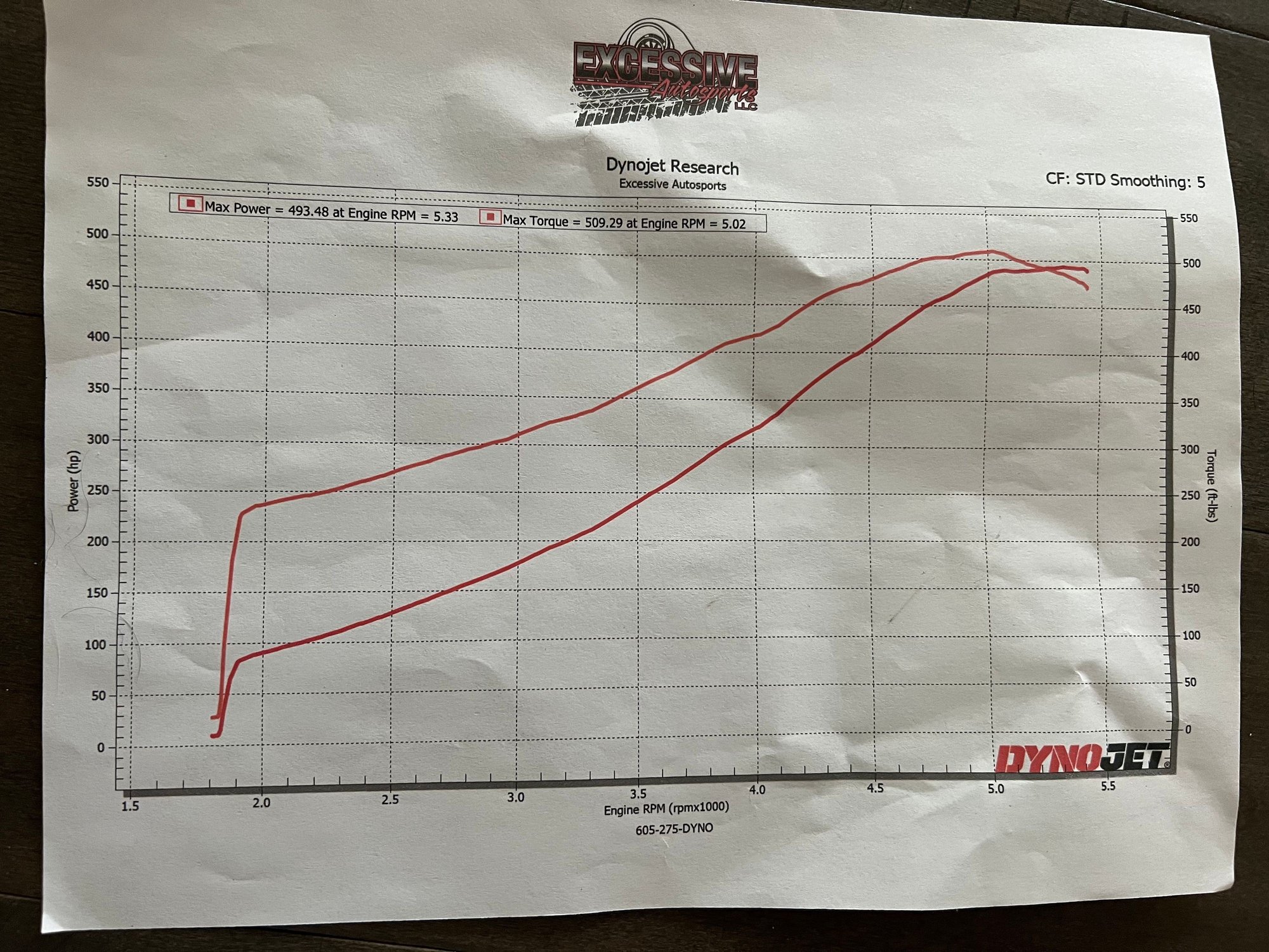

About 500 awhp/500 awtq @ 10 pounds
12.47 @ 113 on the street
Next plans:
Maybe trutrac or quick performance rear but so far not much spin with this powertrain. Slow 2.0 60 fts.
4.8 cam and springs. Not sure which one to get. Leaning towards milder the better. Want great idle, just opened up a bit. Not sure where I will land there. Holdener says BTR torque cam maybe? I am thinking @Summitracing SUM-8720 or ghost cam at the biggest? Not sure as its kind of a weird combo trying to remain streetable and I already have 3k stall. @ddnspider what did you run in your 4.8 turbo truck?

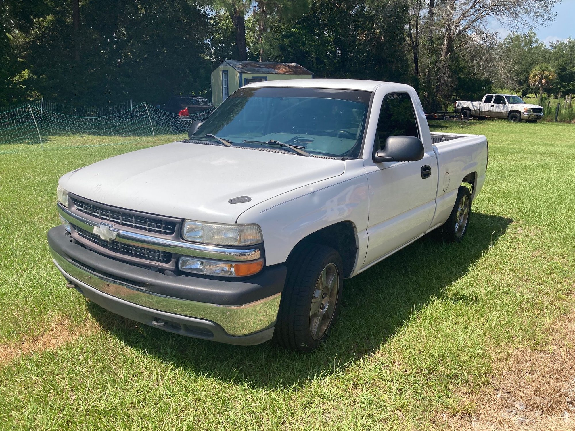

i have one but its white. 5.3, single 88, 4l80e, np149.
great truck.
