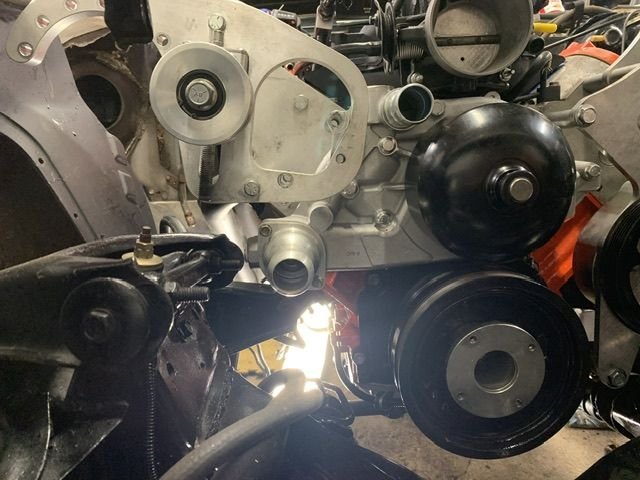

I’m in the process of trying to figure out how I can my old LS GTO torqstorm supercharger on my 5.3 in my 78 vette. I can physically bolt the supercharger in but running into belt issues. The belt runs directly into the upper shock stud and then the waterneck becomes an issue.
im wondering if there is a low profile SBC style waterpump that as the lower outlet like a SBC that fits the LS? I have the slimline speed master electric pump but I don’t want electric for the street and then would have to figure out belt routing. Car is street only and I really want a mechanical pump.
I have to use a straight waterneck due to the upper control arms on the C3. To route the supercharge belt over the waterneck would require some interesting belt routing and a new pulley system.

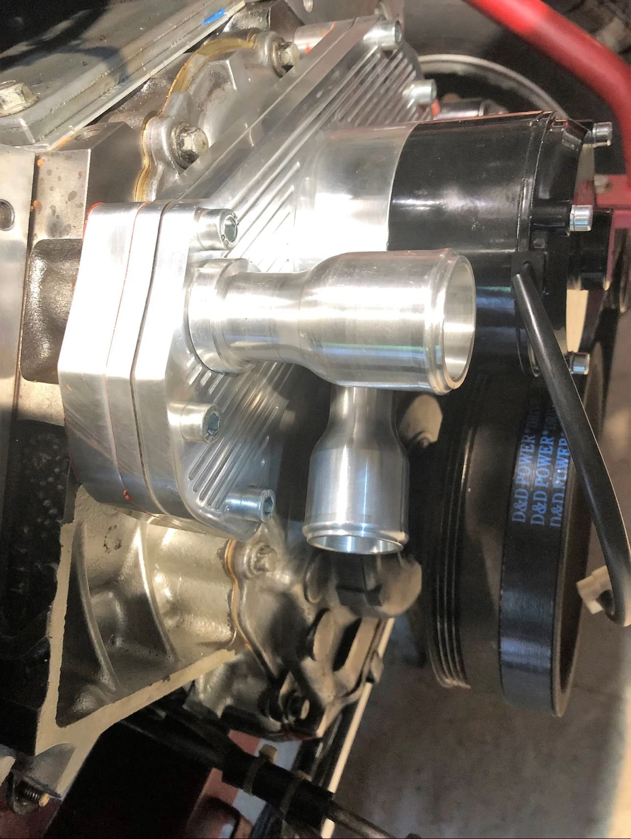

This is the slimline electric speed master waterpump with a traditional outlet.

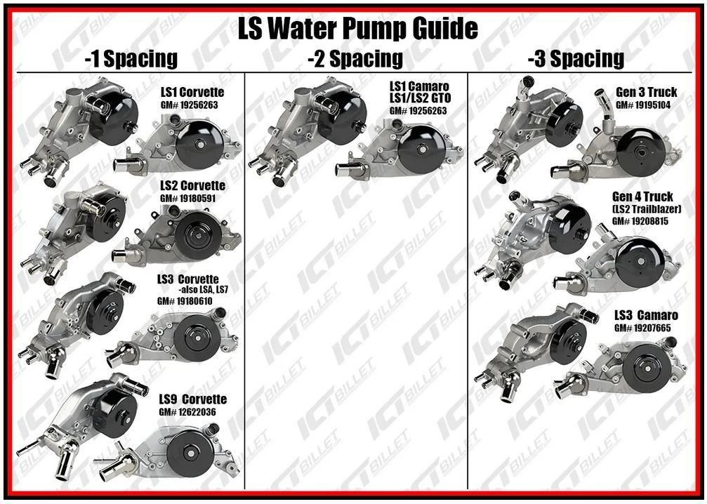

here are the LS water pump options:
Link no workie... says it can't be trusted.

I didn't provide any links, just pictures. Are you talking about the link in my signature, to my Turbo C3 build? That works fine.

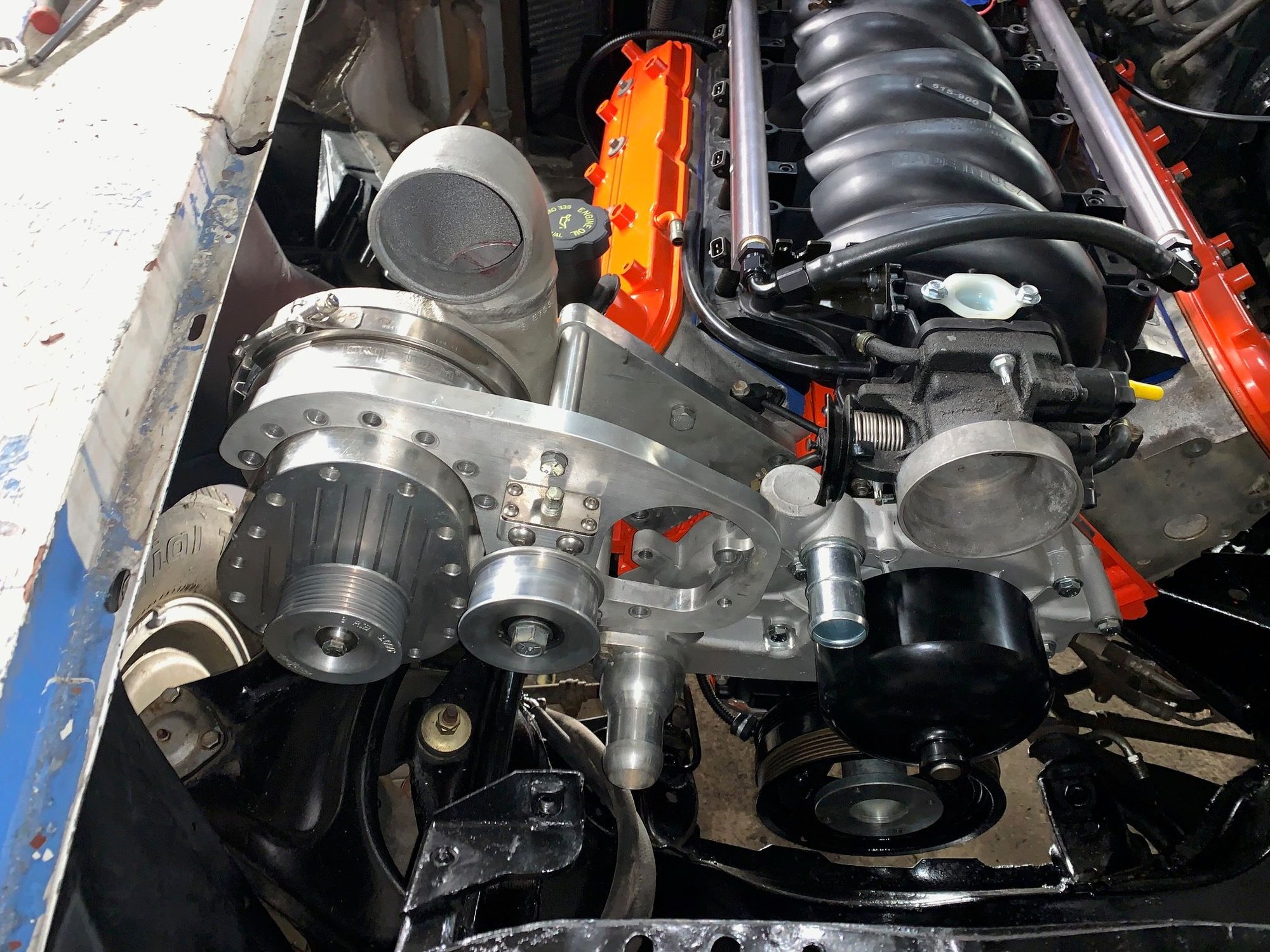

I also had water pump and upper control arm clearance issues in my boosted C3. Ended up going to an SPC upper control arm to gain back some space. There are no alignment shims needed and the shorter bolts can be put in backwards for more clearance. Don't know if that will give you enough, but it gave me plenty of room for the heater hoses.
I know firsthand that shoehorning boost into a C3 is a tall order. Had to get rid of the Rad support, get rid of the whole vacuum system for the headlamps, and modify the hood hinge to get clearance for the rad and the intercooler. Worth the effort to make it stock looking.
BTW, on your supercharger exhaust, it looks like it's going to go through the hood. Can you clock that?

Oh, the pic didn't show up for me and when I clicked the link it said it couldn't be trusted.
I have the SPC upper arms already, they gave me more clearance for the supercharger body which hit the stock arm in the middle with the car at ride height.
Supercharger exhaust is clockable but I'm going to cut that off and route it back towards the firewall. Then I will hook it up to a A2W intercooler and a heat exchanger up front. I also have already converted to electric headlights. Heater hoses aren't a problem its the actual supercharger belt runs into the upper arm cross shaft and the front shock mounting stud. I need to loop it up and over to clear which means a pulley on the underside of the supercharger where the arm is. I don't know if thats feasible yet otherwise I need to make all new brackets and reposition the supercharger up and intowards the engine to help with the belt issue but then I run into possible issues with the hood. I didn't test but it might clear the stock hood as is once I redo the supercharger exhaust. I also have the LS3 pump on the car already which moved the upper hose out of the way nicely but for me now its the waterneck. I haven't tried to mock up the supercharger since I did the LS3 pump though.
