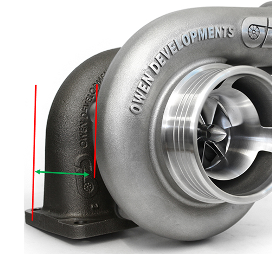

From the flange to the comp housing

Ok measurements.
10.5 inches over all length
6.5 exhaust out let flange to rear if compressor cover.
1.5 rear of compressor to front of t4 flange
5.5 from comp cover to rear of t4 flange.
wasn't sure which flange you meant so I grabbed a couple measurements.

Flange to comp housing

Exhaust flange is 1 inch wider then compressor housing there. Scroll is wider then compressor housing by 3/4 of an inch then decreases slowly till about 1/3 way around it is even with compressor housing.
