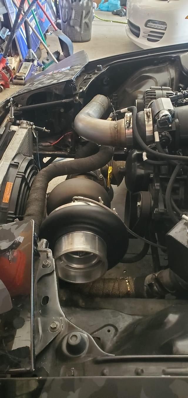

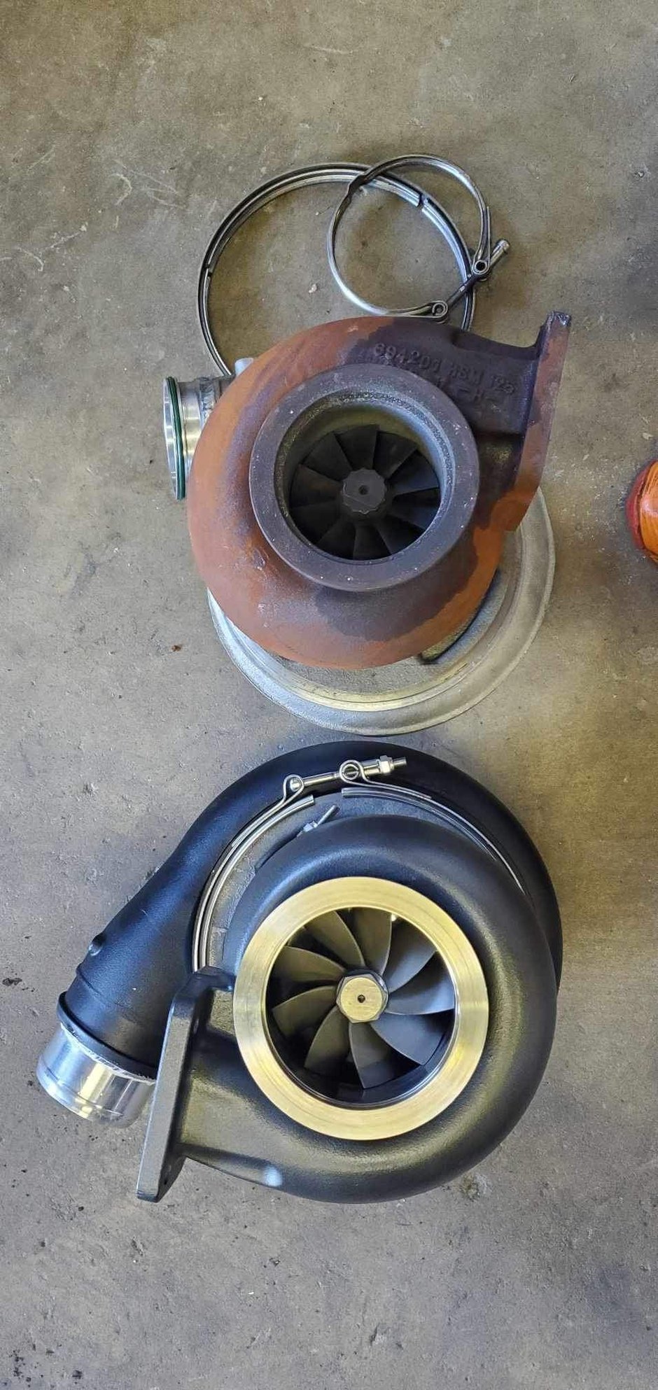

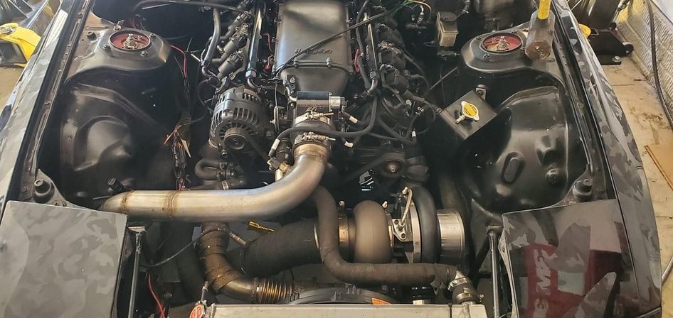

We mentioned we are testing the 88mm prototype that became our new 92mm 103/92 T4 SUM-270112R Giant Slayer. JP Riccio had a chance to take it to the track yesterday in his 5.3L T56 FC RX7 and it didn't disappoint!
His previous best was 9.35@154 at 28psi with an upgraded 78/75, 6.0 SBE, stock heads, SUM-8723R1 and Holley Low-ram. He broke a ring land that day so he picked up another 5.3. This 5.3 is also stock other than a small stage 1 cam and unknown (if any) valve springs (more on that in a bit). This is the one that picked up 200whp at 2PSi less boost than his 6.0 and 7875. The rest of the car is a pretty basic extreme budget build. Terminator X, 4" intercooler, 4" down pipe, VS gate, VS 210 injectors, stock coils, Summit Pro Twin clutch and a couple Summit inline pumps for fuel. No modifications were required to put the turbo in (92mm 270112R is the same housing too).

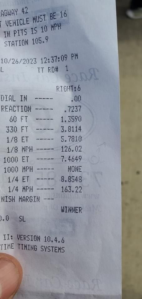

Anyway, he got it down to an 8.85 @ 163.22 yesterday. No 2-step and lifting on every shift. Picking up about 9 mph and half-second with the new turbo at the same 27.5 lbs. This is MASS FLOW friends . He tried for more boost even yet, but the MBC was maxxed and it smashed through all the boost safeties before fragging something in the driveline in the burnout box.
So what's next? The turbo has a lot more left in it, but we may be out of test days in Ohio. He has the bigger SUM-8723R1 and the SUM-174005 .630 beehives and may go back to the dyno with our SUM-270101R 60mm Piston style gate to turn some rpm. It really needs a set of Pro LS pistons and rods so he can let it turn anything it wants. We don't know how fast anyone has gone with a SBE 5.3 and T56, but it looks like the Giant slayer is one killer T4 turbo for folks who don't want to cut up their engine bays. The extra 4mm of compressor in the production turbo will have even more punch so we're going to see a lot of T4 guys breaking their own records!
