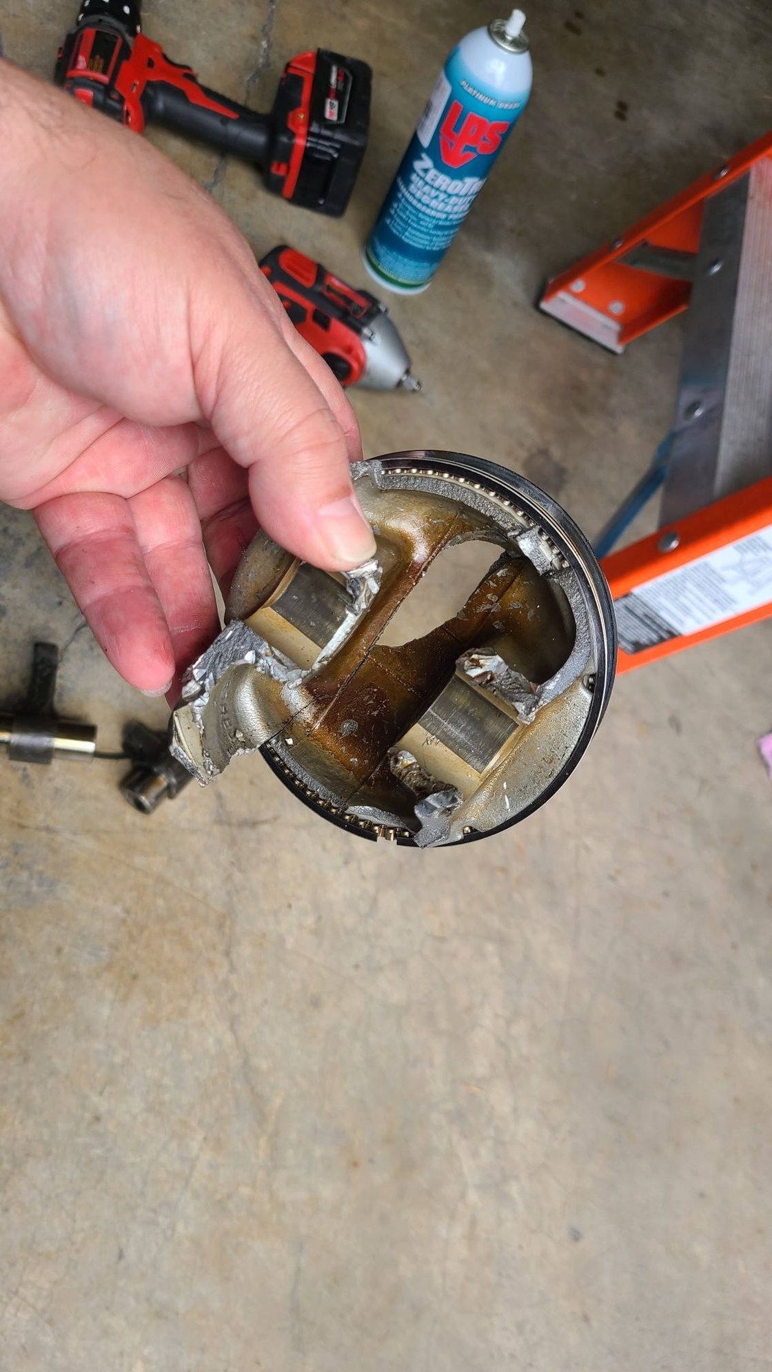

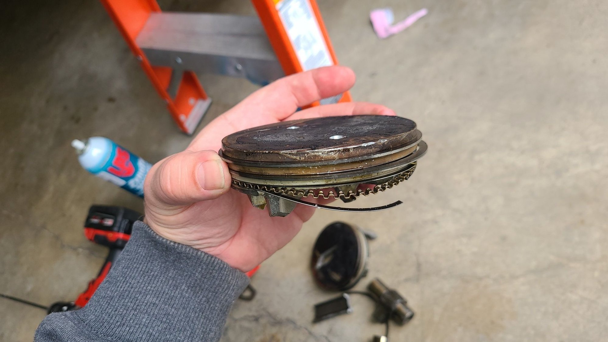

Tried running 12psi in a SBE stock ring gaps LS1 with 92 octane fuel at approx 10.7:1 compression. It would not take any timing at all without showing knock. Single digits of timing. There were some bad decisions I made with the build but was having fun still at the same time. I knew the engine would fail at some point in time but I really thought it would just break a ring land or maybe crack a sleeve.
It ended up completely destroying itself after it butted the rings. I wasn't mad but definitely frustrated at the amount of secondary damage. Learned a lot from the incident.
That looks more like the rod decided to bend and break from the torque of that combo vs butting the rings but who knows for sure, could have been both. Normally if it was the rings butting it would just pop the ringland on the piston though.
Nic, that was my original thought as well as LSAs are known for bending breaking rods from making torque way low in the rpms.
But after a few of yall experts looked at the pistons it was decided that it looked like it butted the rings and the rods snatched the wrist pins right out of the bottom. It looks like it ripped the number 1 wrist pin out which then was carried around by the rod and snagged the number 2 rod which then ripped that wrist pin out of the number 2 piston.
The scariest part of the whole event was when it windowed the block the engine ran away even with the throttle closed. Had to shut it off with the key. I have no idea the RPMs it turned.

Holy crap I've never seen that kind of failure before, but it's hard to imagine that the rings butting up could have enough force to rip the bottom of the piston off with the wrist pin. That's wild...
I seen one very similar last year. I was at the track, guy wanted me to start tuning on his truck. He was behind the keyboard, I was just watching taking it in, trying to get a base line and some video on his truck. First pass I watched, and it was over by 60'.
Either the ring held it, or there wasn't enough piston to wall clearance.
