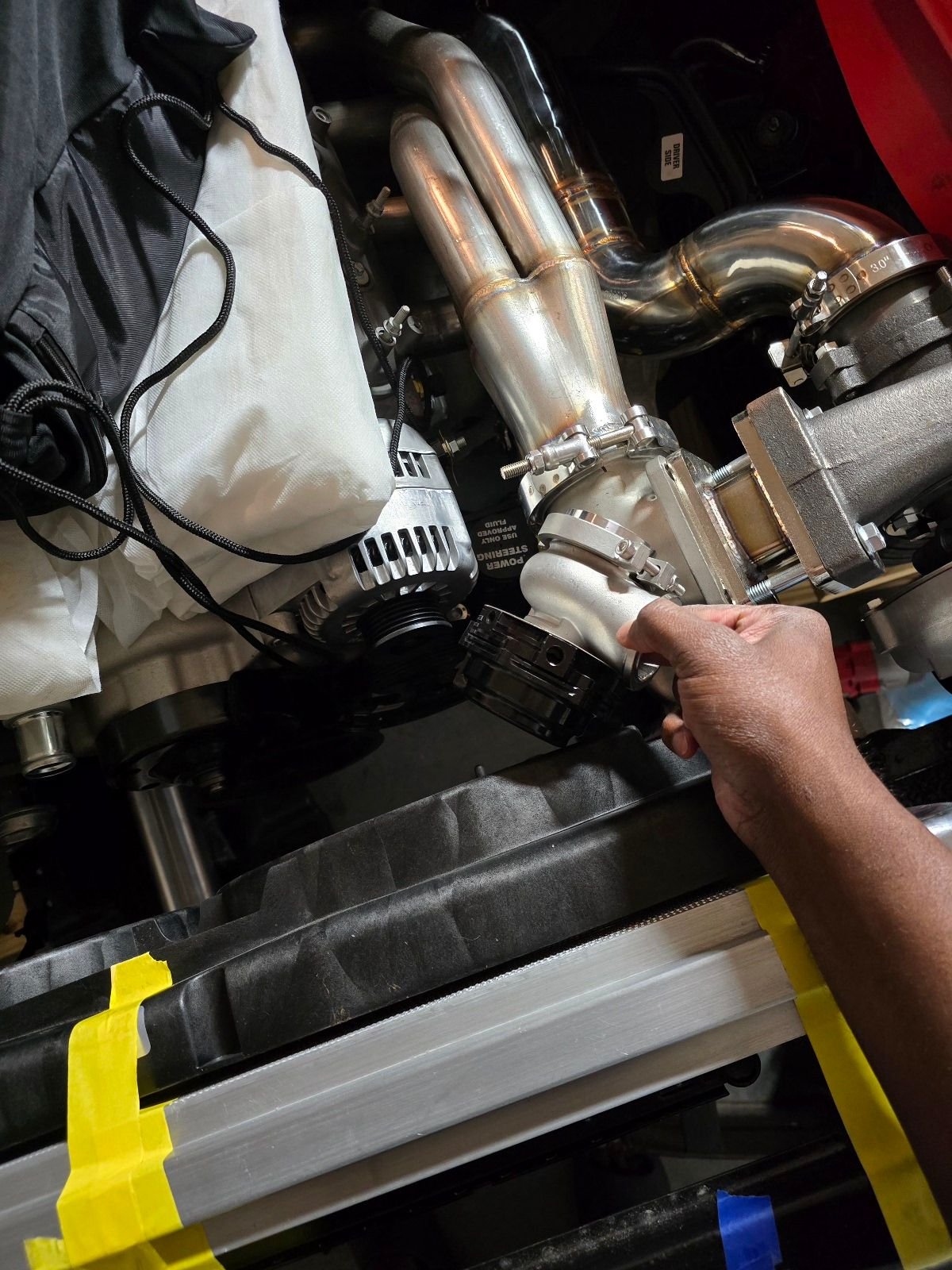

I'm at a bit of a lost on where to place my wastegates. I was thinking about on top of my elbows at an angle, which would provide great flow. Or possibly on the headers? Might have to wait until my hood is installed to make sure they clear. Any suggestions would be much appreciated.

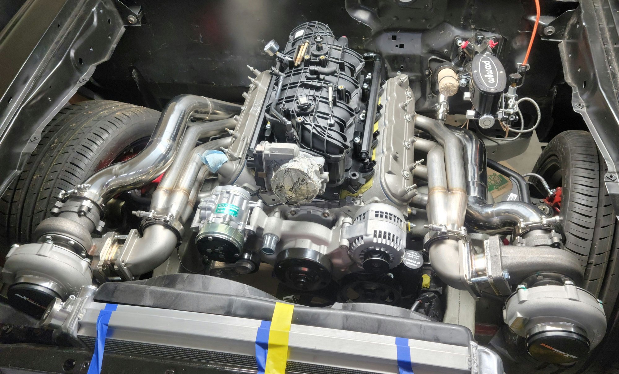

This is where I'd put them with a straight shot from the headers.
Then tie the vent into the downpipe.

I went and mocked up the radiator and electric fans. Sadly it's not room to go in the identified locations. They are 44mm wastegates. I know it's not ideal but I may have to mount them on top of the elbows. Either vertically or at a 30-45 degree angle.

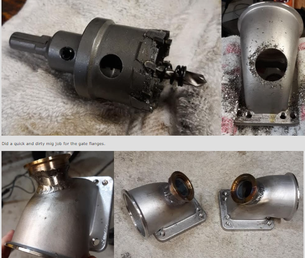

You don't need or want a larger a gate than necessary. 38's in that circled location will work fine. You want a better location over a larger gate.
Get the "mini" 38mm gates. It will be much less headache IMO. No need for large gate cost or installation hassle. Good luck drilling those cast elbows! I had to buy a tungsten carbide hole saw... lol
Works great tho. I control twin 78/75's with a 5.3 easily.

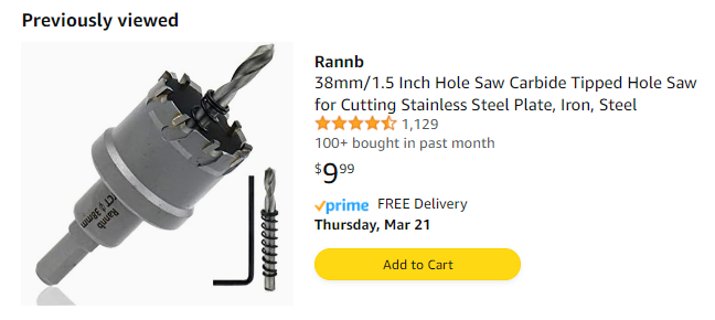

Thank you. I almost purchased the Tial MVS version for $70. You saved me some coin! What size carbide hole saw did you use? Also the pipe size?

I used a 1.5" for both.
Won't let me post amazon links for some reason.

I mounted gates on the collectors of the headers on my last setup. I believe this was a detriment to the effectiveness of the hot side. I used 2 different sets of turbos and both were much laggier than they should have been. But this is just speculation on my part.
Placing the gates on the elbows is definitely the right/best place to put them.

I'm going to but a set Armageddon LSX cast manifolds from a member on here. It will clean the engine bay up and fix a few issues I'm having with the wastegates.
