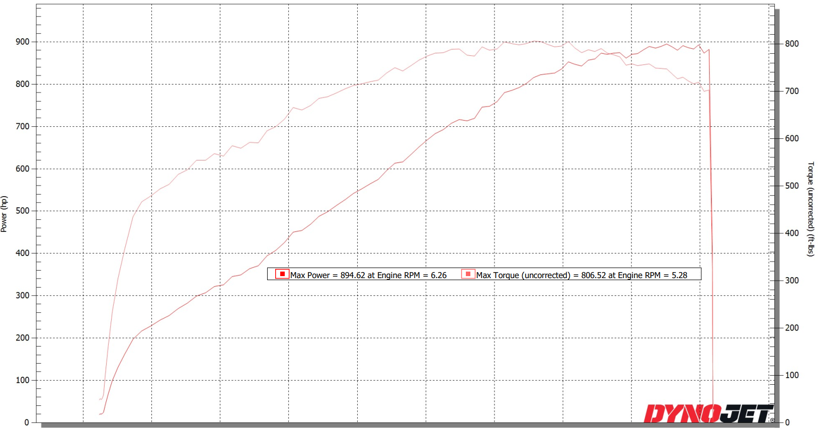

It might be valve train related, but I doubt it. I only have btr .660 springs. with ls7 lifters, 11/32 .120 wall pushrods, max effort ws6store rockers, and a 232/248 .621 .611 cam. My limiter is at 8000 and it pulls hard all the way there, but I've got my shift point at 7200 rpm for regular street driving. BTR cathedral port equalizer intake with stock ls1 throttle body and 4 bolt adapter.
Only 20 psi at 7200 rpm, but will keep climbing after that as even though I'm hitting max recommended impeller speed the f1a-94 isn't done.

I would guess you need more cam.
Below is a 226/232 cam through an LS6 intake and it is all done by ~6500. I think you need to get your cam inlet duration up into the 230's with a few deg of overlap (235/245-ish) to reliably move your peak HP into the 7,000's.

Man, if only there was a device that you could use to actually see the power and torque curve of your setup. I mean, I know guessing is fun and all but... I've never understood the desire to rev something out so much if it's of no benefit. I get guys all of the time asking me if I can raise their rev limiter some more because they read about so and so on the internet and what they are spinning it to, then I show them their dyno graph with it being done at 7000 rpms.
