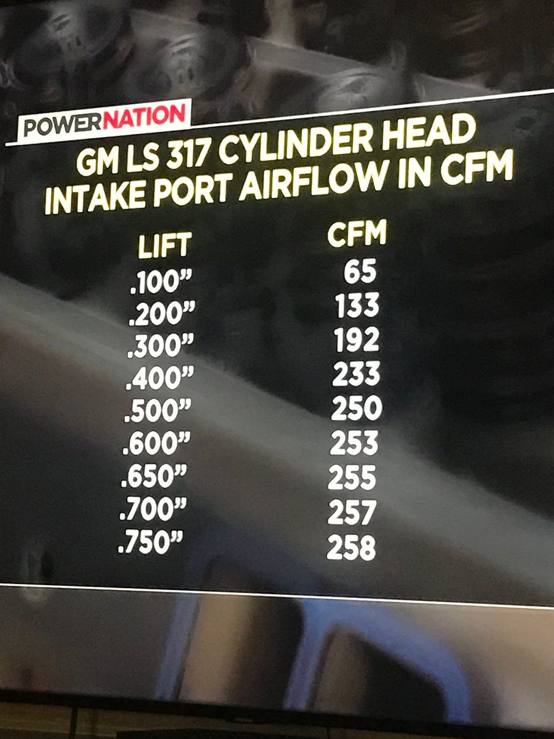

The way I understood it, you sacrifice valve control for more flow. And if you are on a factory cath casting head there’s not much to be gained flow wise on lifts over .600. If I recall BTR tested this and was really minimal over like .560 on a factory head, esp the exh side. Higher you go lift wise the less stabile the valve train is and the less aggressive ramp rate can be used. Basically, more wear and tear.
Someone posted the factory flow rates for a 317 head and from .500 to .750 lift it basically flatlined.
Found it.
Full tilt porting with larger valves can easily get these numbers into the low to mid 300CFM range.
