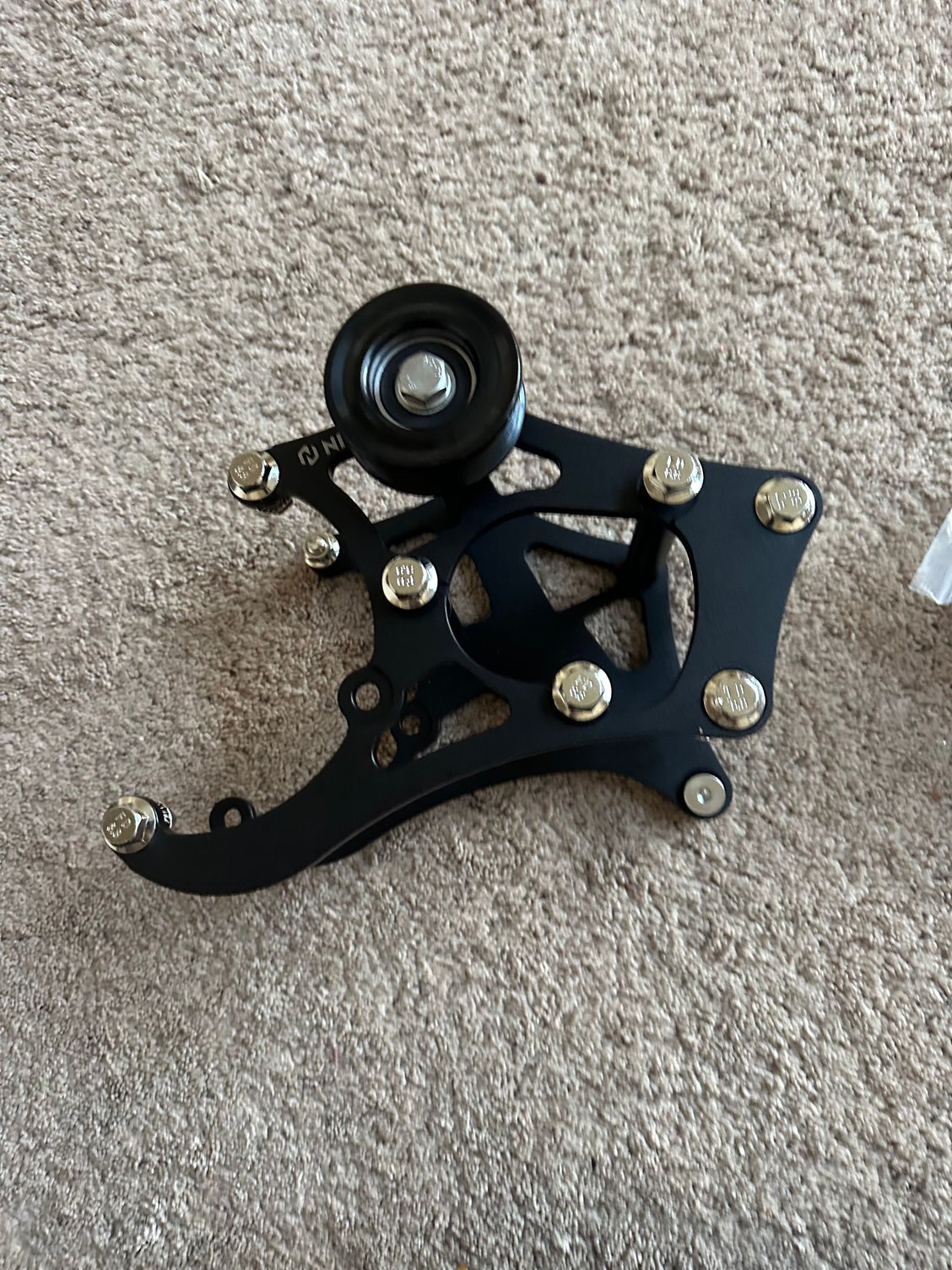

i plan on using holley manifolds so there 3” vband comes straight forward under heater hoses. I plan on installing a pass side a/c bracket and then the turbo along side that. Whatever it takes in length off holley vband maybe 12 to 18” of schedule 40 id suppose

its going in engine bay alongside the pass a/c bracket i have to install
Okay so still in the engine bay, the closer to the engine the better.
