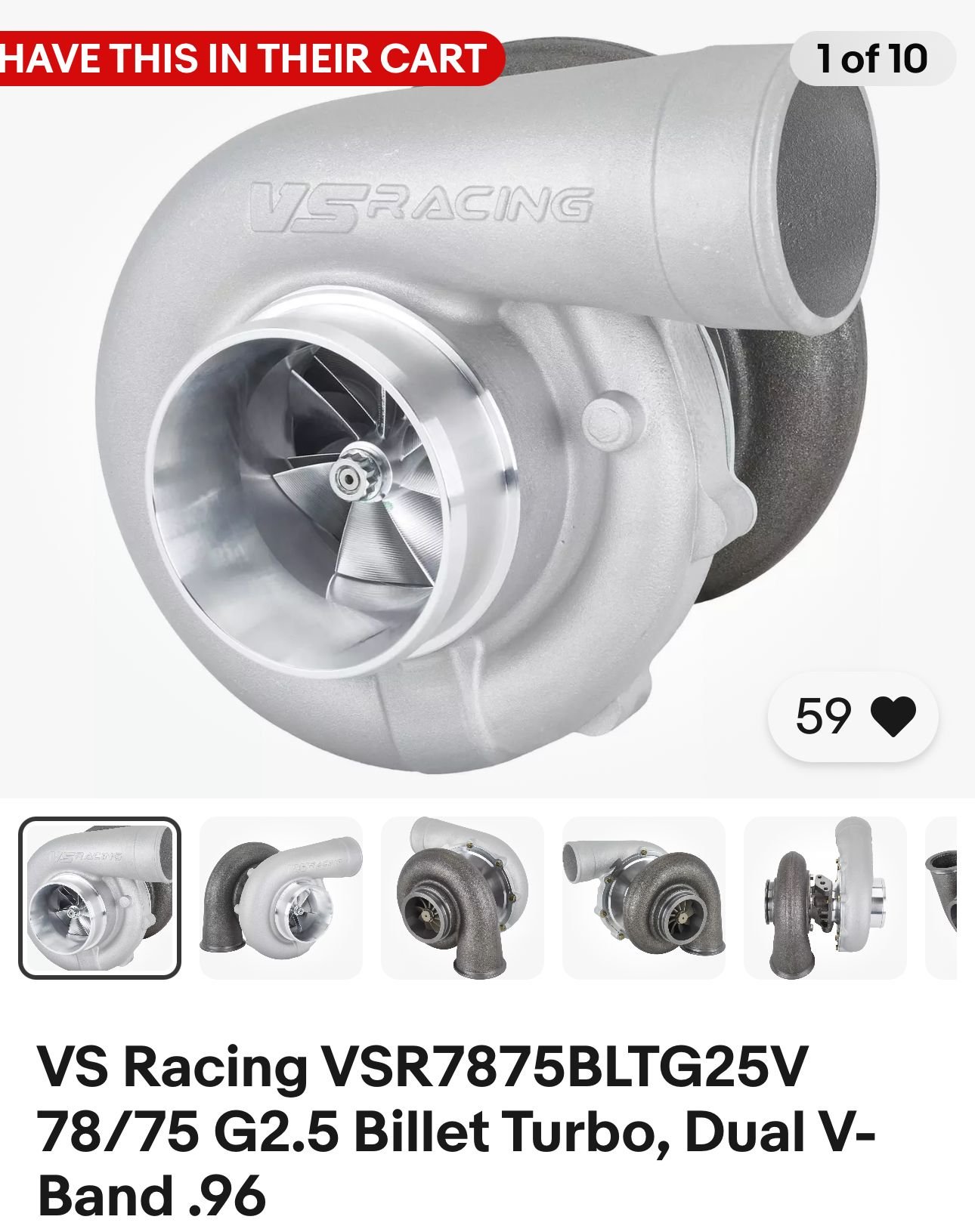

VS isn't bad, a lot of guys use them, just pull it apart and inspect it first since it's a Chinese product.
I don't like to skimp on parts that can blow up my engine if they fail so I buy name brand wastegates.
I've run Tial and Turbosmart with great results, JGS also makes a good one.
If you're set on running the Holley manifolds, I'd get an elbow with the wastegate port right off the bend to give it the best priority.
You'll get the best boost control there.
in the bend or i was was considering putting gate on turbo housing? I was thinking housing because it would make plumbing cleaner so i can dump into downpipe.
if i do that do i do a 44 or 50mm wastegate?

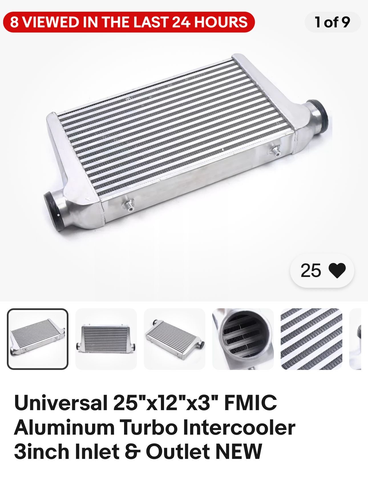

This is the intercooler im looking at
And the turbo im interested in
You could do that but if you ever wanted to sell the turbo you'd be hard pressed to.
Something like this would work.
3" Vband 90 Deg T4 Turbo Elbow Adapter Flange 304 SS Cast Center WG Tube (cxracing.com)
Or this, just punch a hole in it and weld on the WG port.
Custom Turbo Header Elbows- 3" V-Band 90 Degree Turbo Elbow (stainlessheaders.com)
Looks good to me.

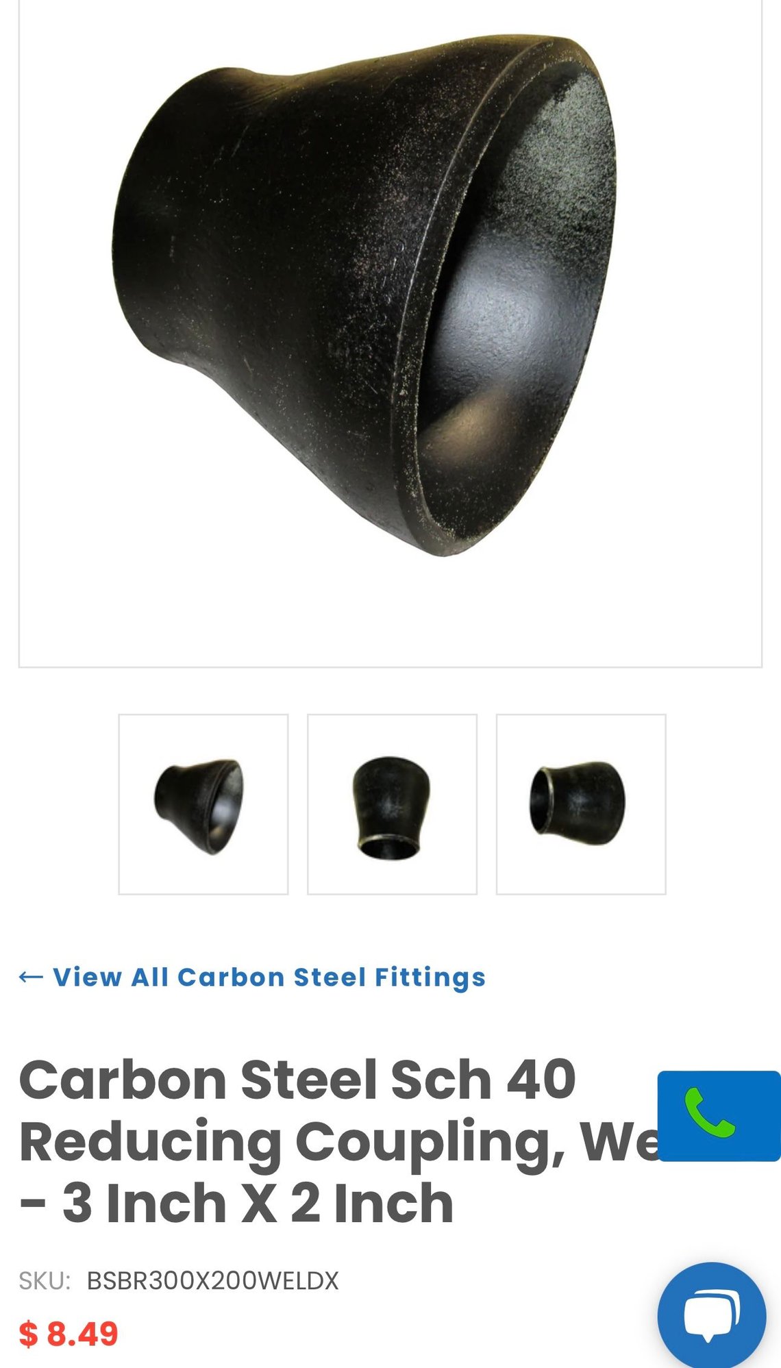

I ordered intercooler. I have mac valves. I have schedule 40 2” pipe and a couple 45s and 90s. Hoping only to use one of each. Will need to source a oil feed and drain kit also. Just getting all the little crap together buying small **** weekly.
does anyone know of a 3” vband to a 2” id? Im looking for that now

found some reducers, got 2 coming

What are those for?

What are those for?
hotside from holley manifold is 3” so these will reduce to 2”
