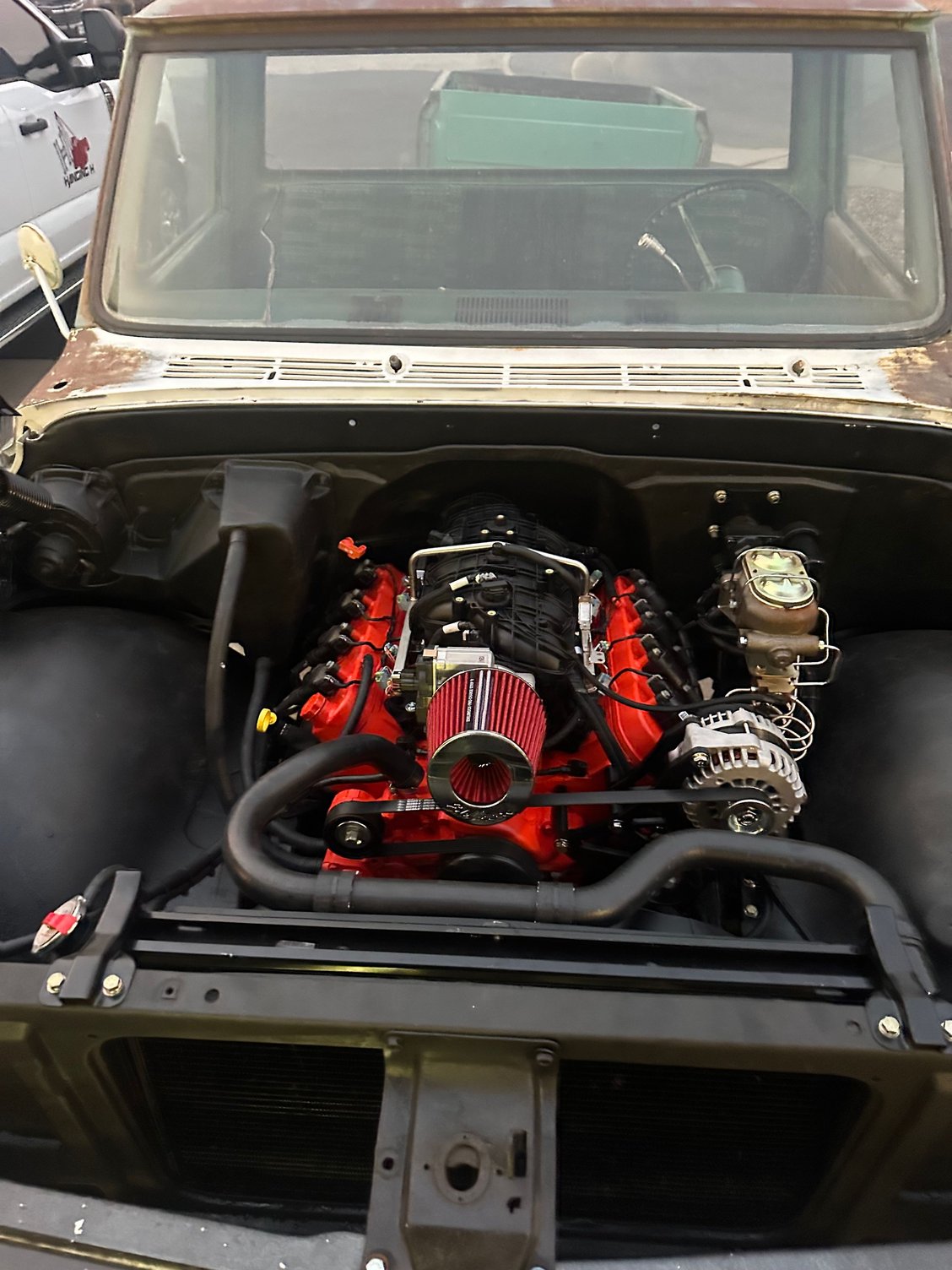

Ive read countless hours and pretty solid info but can be quite overwhelming. I did my first ls swap in a 68c10 this year. Engine was a high mileage lc9 200k. I bought a btr truck norris kit with cam, springs, seals,pushrods and lifters. had the heads freshened up installing seals and springs to match cam. New Truck tbss intake and tuneing on holley xmax. Getting bit by the bug i wanna venture into a turbo. Looking at holley turbo manifolds and there crossover. Will plumb a 2.25 or 2.50 hotpipe off of the manifold to a flange or vband style turbo. I have no battery and will mount far into pass side.
Truck is 3600lbs
4l80e built by 4l80e guy
3600 fti converter
3.73 gears mini spooled
only real mod to engine is truck norris cam. Which isn’t optimal 107lsa. Being an lc9 with flat tops and higher compression. I am looking at ebay 7875 cast and billet versions maybe vsracing with vband mount. Not sure an ar 96 or ar 1.25. one of my reasons for choosing this turbo is 3” exhaust housing so i can run a boost activated cutout and a full 3” out the back.
so is it a ebay cast or billet 7875 or pony up for vs racing.
and what ar size
