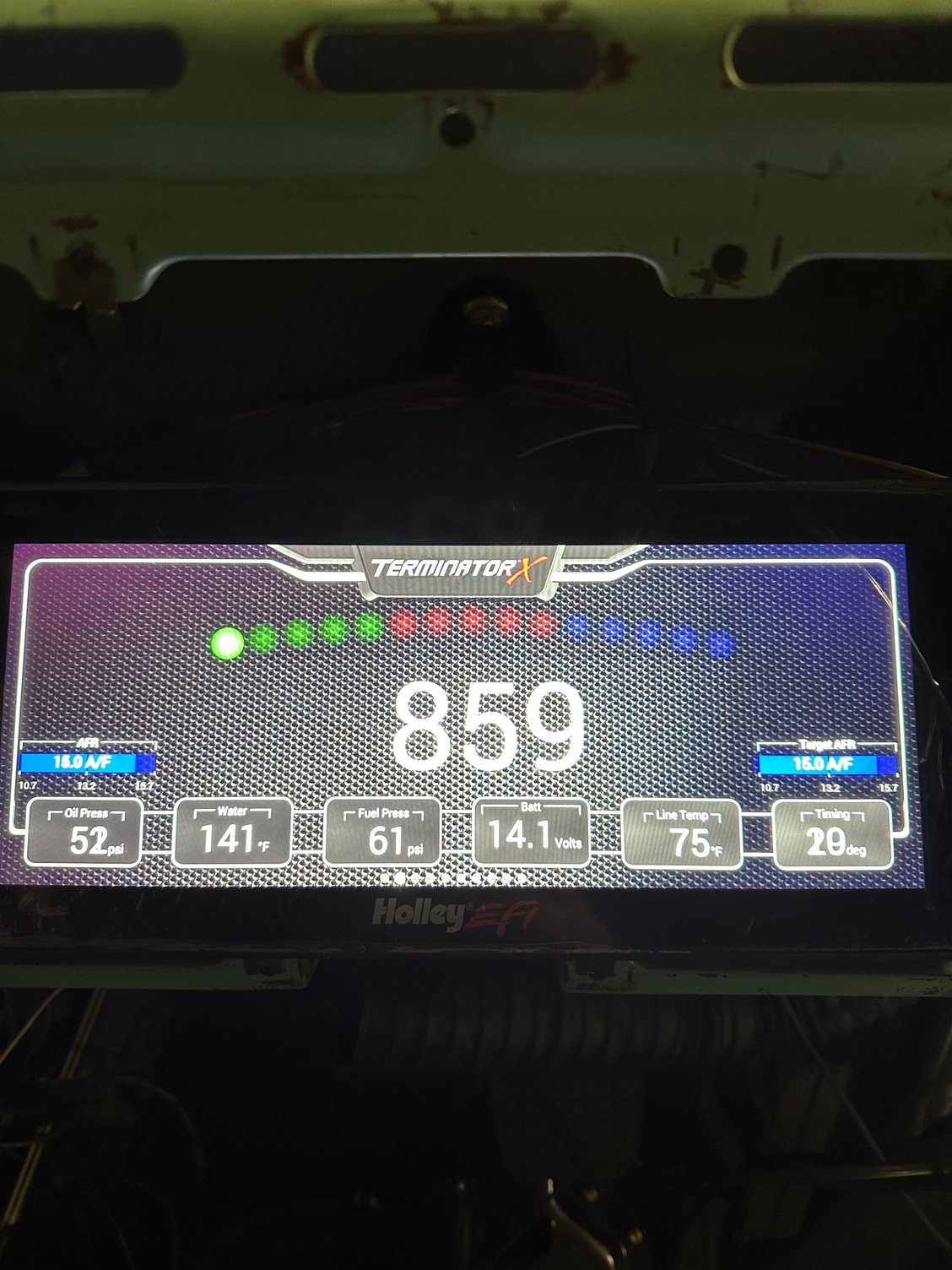

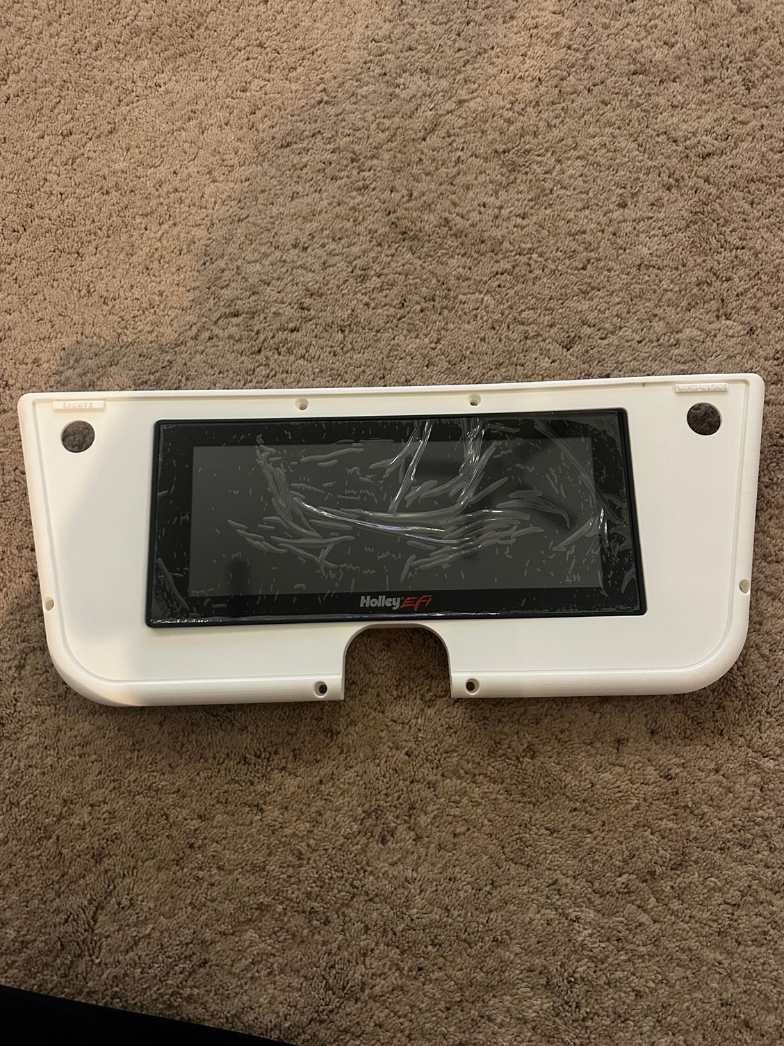

Sorry boys. Been sidetracked with updating my lil 3.5 dash to the 12.3 pro dash. Lots of wiring and updates to come for future turbo. Gotta get the dash painted black and that tilt installed still

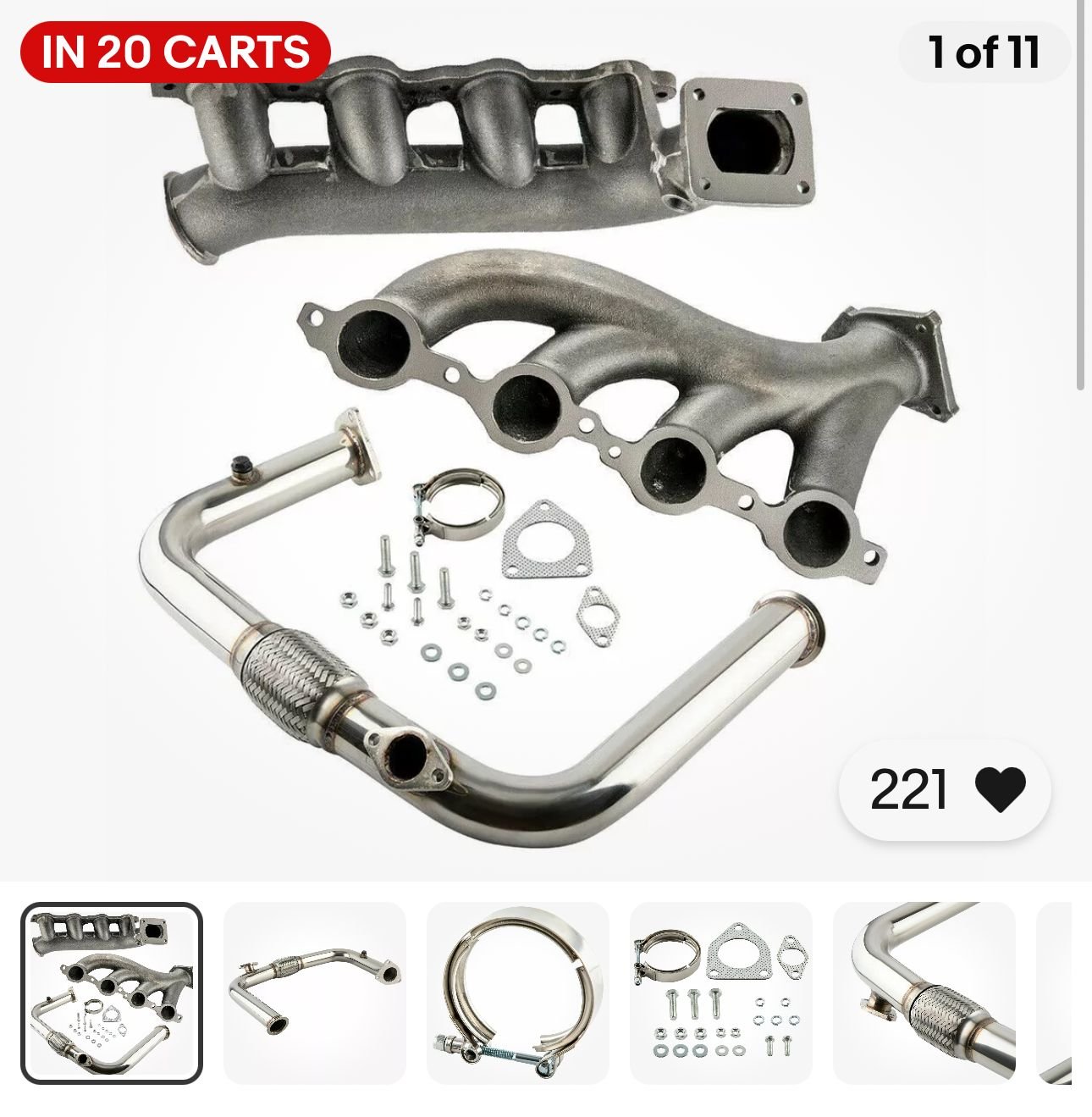

So i haven’t ordered turbo or manifolds yet. Been busy on the pro dash and new tilt column to arrive Monday . I have heater delete plates to weld up firewall. This will give more room on the exhaust down pipe. I have since decided on no a/c which opens up the option of amazon/ebay turbo manifolds. All have 2.5 crossover with wastgate down below. Is this a no no? And then i would shoot for a 7875 billet with t4
That wastegate location is sus, I know its a lot more money but I'd be looking at something like the Summit manifold below.
Summit Racing SUM-G9300 Summit Racing™ Pro LS Turbo Manifolds | Summit Racing
Another gent on here bought the CX Racing setup because it was cheaper and then ended up heavily modifying it to make it work right.
I could see you using the eBay setup and having boost control issues and you end up having to modify it to make it work anyway.

ive thought about blocking of ebay crossover and putting gate in a flange to flange spacer with gate in between. or weld to turbo housing.
You can certainly put the wastegate directly on the turbo, lots of guys have done that and it works very well.
My only thought was if you wanted to sell the turbo later then you'd be unable to or at least, have a more difficult time is all.
Also toss those cheap gaskets it comes with in the trash and get some MLS ones.
